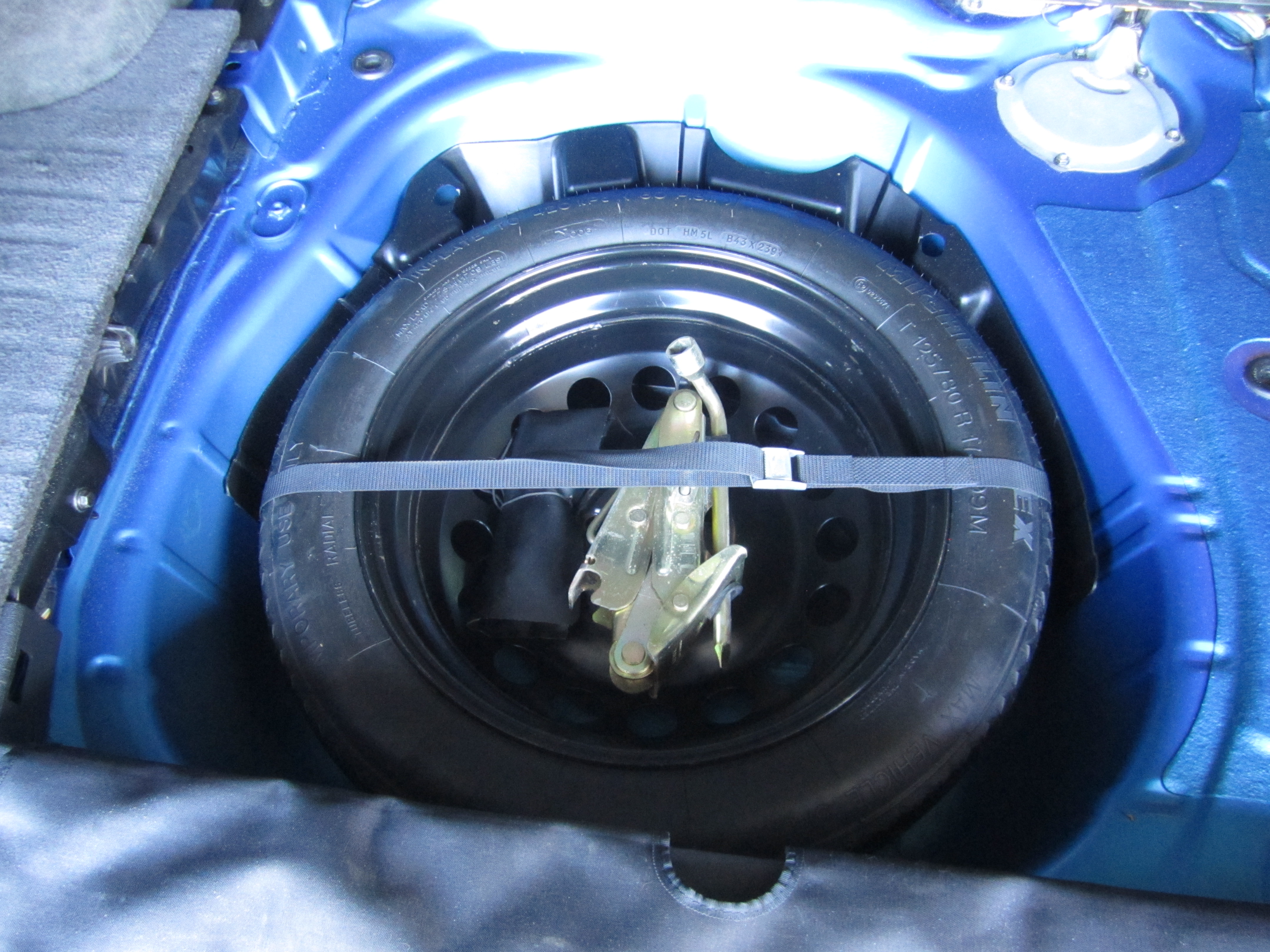

Can't recall if the 850 and V70 are exactly the same but maybe this helps if they are:

Someone probably cross threaded the hold-down clamp which is why it stops. Try running a die down it to clean up the threads if you want to use that function. I wrap and bungie it down since I load a toolbox and other safety stuff into the well.

Your photo above shows the foot of the jack cranked upwards into a J shape with the body of the jack.
I don't think I can crank it that far... have to try it out.
The book shows the tool pouch UNDER one end of the jack, which would serve to lift it a bit higher.
