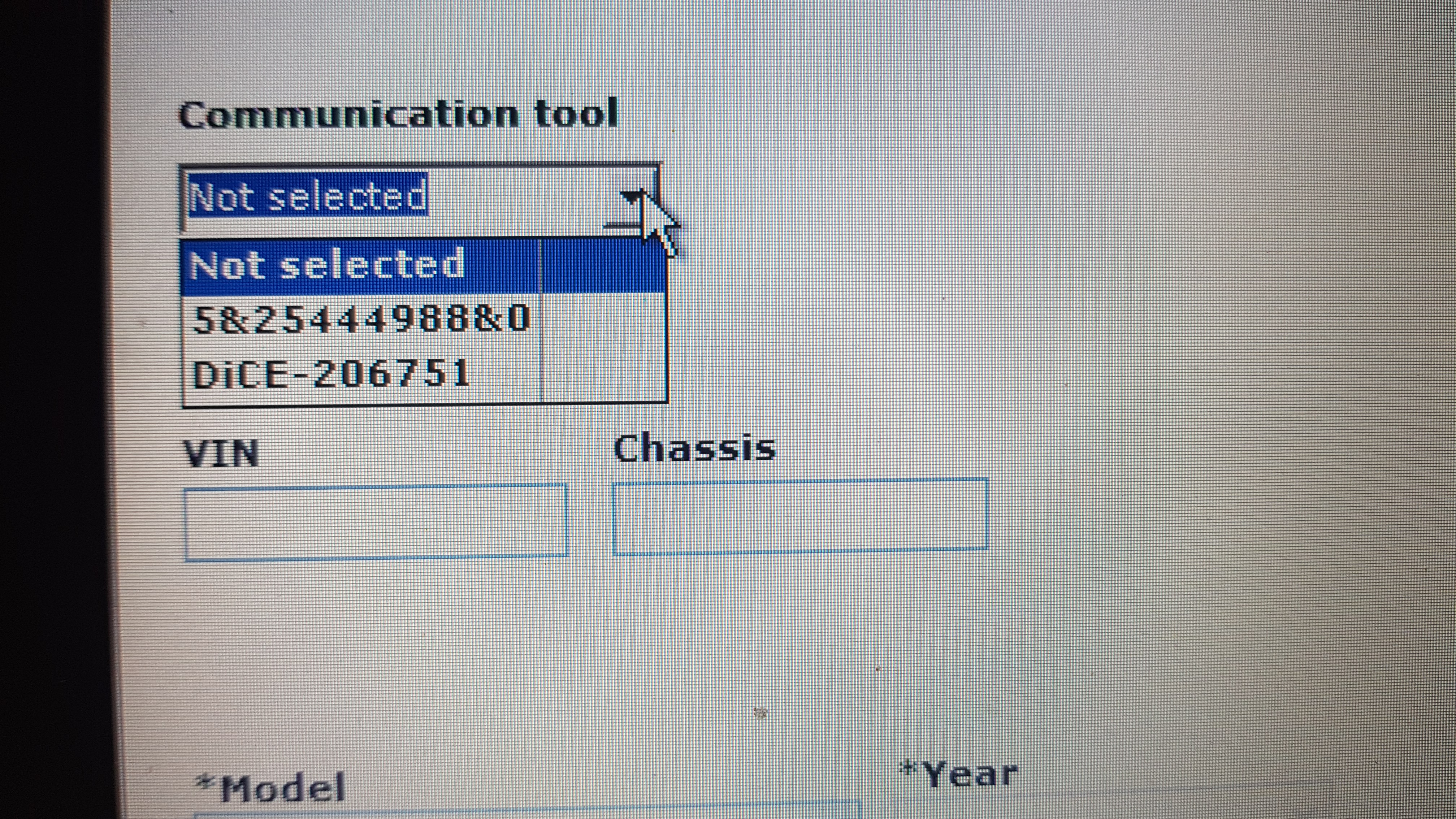

Stay away from Dice Pro as one of them plugged into my Vida was recognised as this "5&2544xxx" device instead of DiCE-206751
