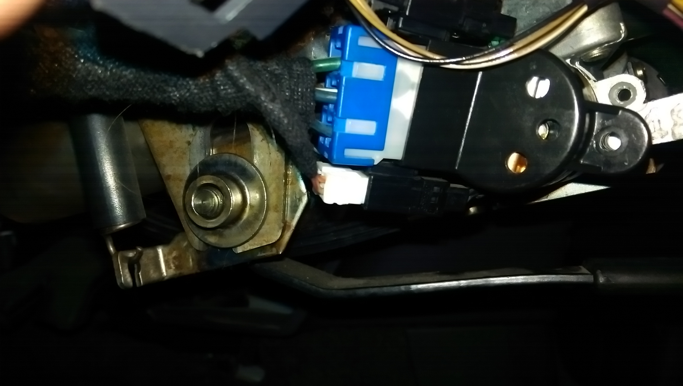

Could not leave it alone and ripped into it anyway. Traced it to the ignition switch.
I changed the relevant position between the electrical portion and the mechanical portion of the ignition switch, the car will crank and start.
I cannot think of anything that would limit the travel of the mechanical portion so I'm betting it is the electrical portion that is defective.
Later today I'll remove the cover from the electrical portion and see if I can correct it.

Nothing wrong with the electrical part.
Something in the lock cylinder is preventing the tumbler from moving to POS III. New lock cylinder >$150.00. Used from LKQ Pick-your-Part $14.00 but the closest one that has a 2000 - 2004 S40 is 180 miles away and I'm not sure you can get the key at that yard. The key needs to be in POS I to remove the tumbler.
Volvo part number 30887387 for cars with shiftlock mechanism and key-in warning.
