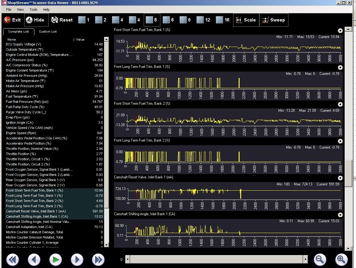

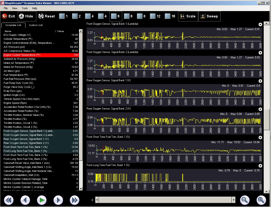

After doing the tasks I listed above I connected a Snap On scanner and recorded the engine data. I took it for a drive on the highway and left it in 3rd gear accelerating (WOOT) to 70MHP and coast down to 50MPH and repeat for several miles. I can email the file SCM for anyone to review just contact me. I have uploaded two photos from 10/31/2018 and 11/01/2018. The SCM file maybe more useful for people who have ShopStream Connect.
I am looking for anyone to find something I am not seeing. Maybe there is an underlying issue or this car needs the classic workout; such as fill up with good fuel and WOOT the hell out of it, hopefully this will also blow out the CATS, and drive it around for some time.
XC90 random P0420
- reading from 11/01/2018 driving after oil change and ...
- 11012018.jpg (390.81 KiB) Viewed 4470 times
- reading from 10/31/2018 - Standing idle
.png file - volvo10312018.png (91.17 KiB) Viewed 4470 times

Can you rerun the tests and have Bank 1 Front and Rear O2 then Bank 1 short and long term fuel on one page.
Page 2 same format but with Bank 2 info?
Grouping them like that will help identify a faulty O2 sensor or point to a possible air leak (which your smoke test didn't show).
Any other info like mileage and spark plug condition? When does the car code - time, usage, throttle position or as you say totally random (maybe bad connection?).
It is hard to track as the eyes are not what they were and I have to scroll up and down. Your testing is on the right track though.

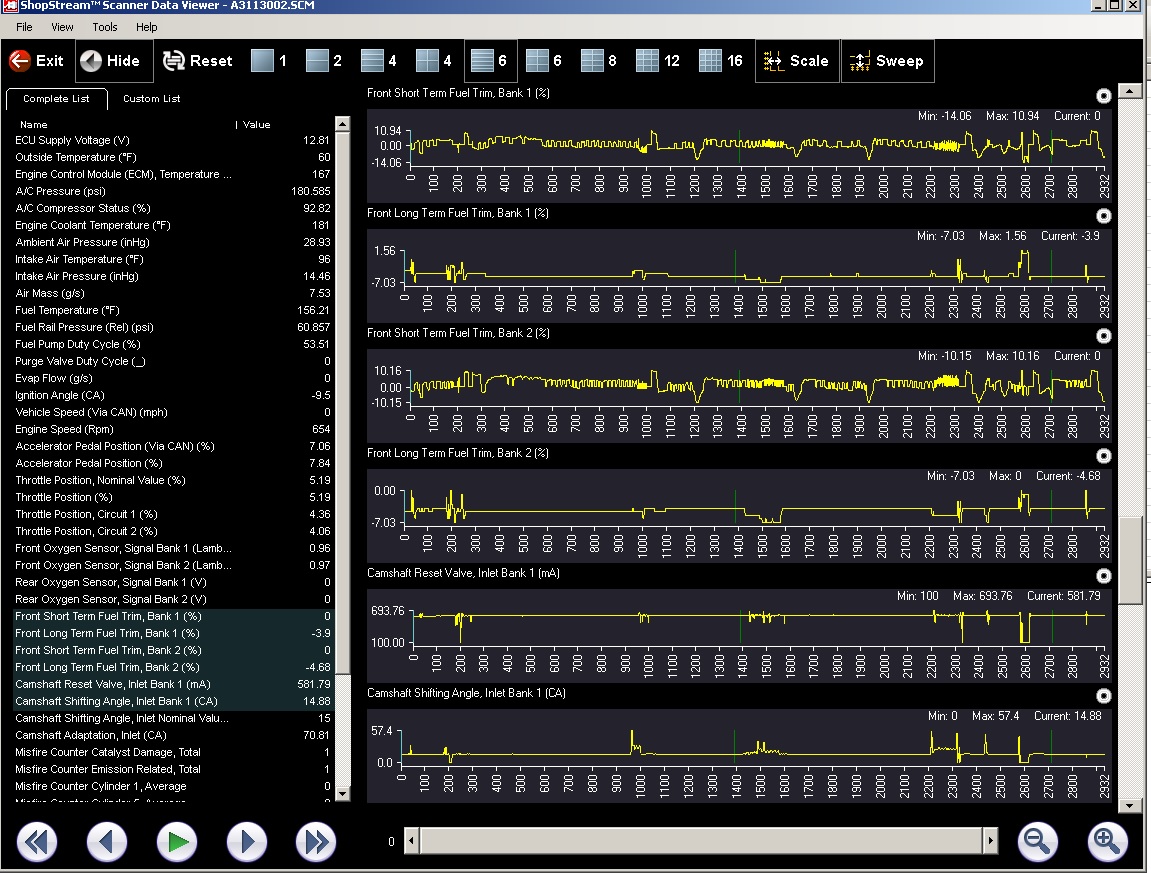

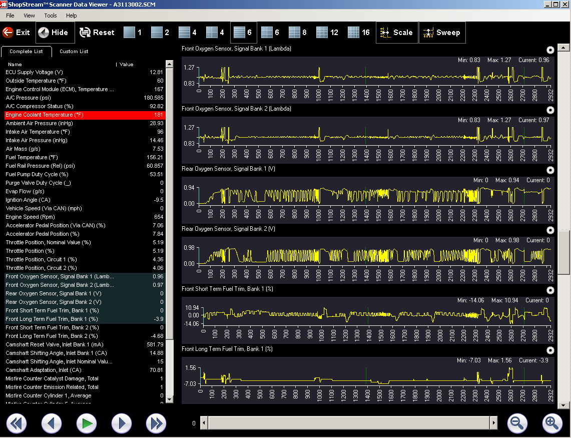

Sure. I added trim graphs for both days. The vehicle has about 148k miles on it. Sparks plugs are unknown I have not check those yet.
- trim10312018.jpg (378.43 KiB) Viewed 4455 times
- trim11012018.jpg (364.54 KiB) Viewed 4455 times

Your data is pretty close to being within spec. I noticed that in Column one in two instances the Rear O2 sensors are reading "0".
http://www.smogtechinstitute.com/smogte ... elTrim.pdf
https://www.autoserviceprofessional.com ... you?Page=2

I looked over the data and did some reading. It looks like everything is operating as it should. The values are actually pretty good and nothing is out of wack. It appears that the O2 sensors are performing their function correctly. Fuel trims seem to be under control so the system is working. Have you looked at the actual O2 sensors to see if they have been changed? It would not surprise me to see they have been changed in an effort to fix the problem. Worth a look and would be a clue.
