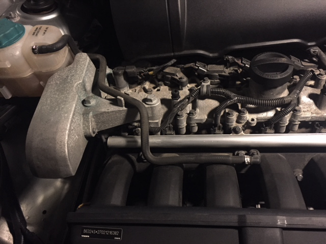

When you are through you need to disconnect the plastic coolant line at the nipple by intake and then fashion a funnel and hose to slip onto that nipple. The engine black won't readily get filled by pouring coolant in to the tank on RH side. Dry engine block once you start engine is not good. You will be able to get 2-3 quarts in but it will go slow due to the small diameter fitting. The prescribed way to fill that engine and all others/all makes with tstat on engine block is to use a vacuum purge and refill device. Filling the block is an alternative.

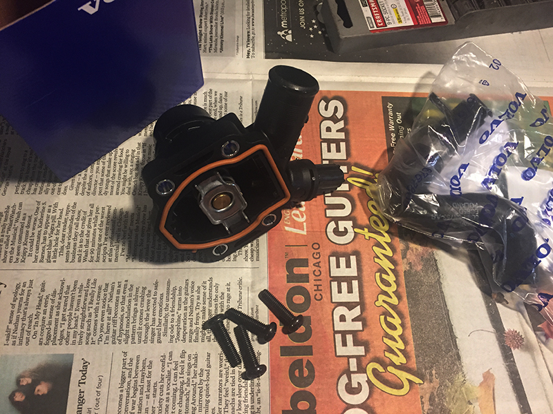

The gasket is $24 each, reusing what's there is desired.

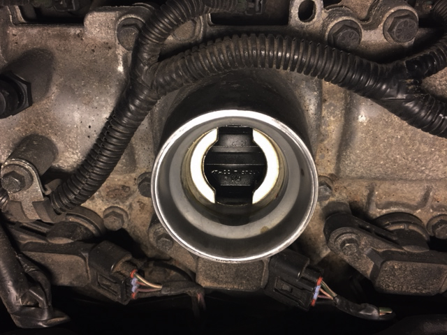

The oil and filter change was two weeks ago. Crankcase looks clean at a glance. I could remove it for a closer look.
Meanwhile, the expensive gasket:

I wouldn't bother to take anything apart for inspection. If the oil fill looks like hell or some other knowledge of it being sludged then get new. Even then they may be pliable and fine for re-use.

The VIDA procedure for radiator replacement drains coolant at petcock. There was still some coolant in the hose at t-stat.jimmy57 wrote: 05 Nov 2018, 13:03 When you are through you need to disconnect the plastic coolant line at the nipple by intake and then fashion a funnel and hose to slip onto that nipple. The engine black won't readily get filled by pouring coolant in to the tank on RH side. Dry engine block once you start engine is not good. You will be able to get 2-3 quarts in but it will go slow due to the small diameter fitting. The prescribed way to fill that engine and all others/all makes with tstat on engine block is to use a vacuum purge and refill device. Filling the block is an alternative.
Is there a petcock drain for the block for t-stat procedure?
I can connect a hose at the nipple by intake to fill coolant. Is gravity enough to fill OR use Mityvac or a fluid pump -- like pushing fluid in angle gear?

There is a block drain on the back of block on most 3.2 engines as I recall. The thermostat being removed will get the block pretty dry. The coolant jacket is not deep in the block. Any I filled through the nipple I just put a funnel with a short piece of hose as an adapter and filled funnel a few times until didn't go down.

Preparing for the weekend project. Two photos:
- The clean oil filler ensures inlet gaskets are good for reuse.
- Expansion tank connection line to intake manifold - a refill port says jimmy57.

The simplicity of hose fitting is a boon for DIY folks. It is a snap in 3.2.
Drained coolant at radiator petcock, and refilled expansion tank with a gallon of distilled water to explore the nipple function at the intake. The water streamed out from the nipple like a boy in frog fountain after the hose connection was pulled.
Refilled the tank with distilled water, and ran the engine. Now drained dry, moving on to removing stuff. I'm thinking about replacing the belt, idler and tensioner during this maintenance.
Cooling and heating is mother of all systems, making it a priority.
