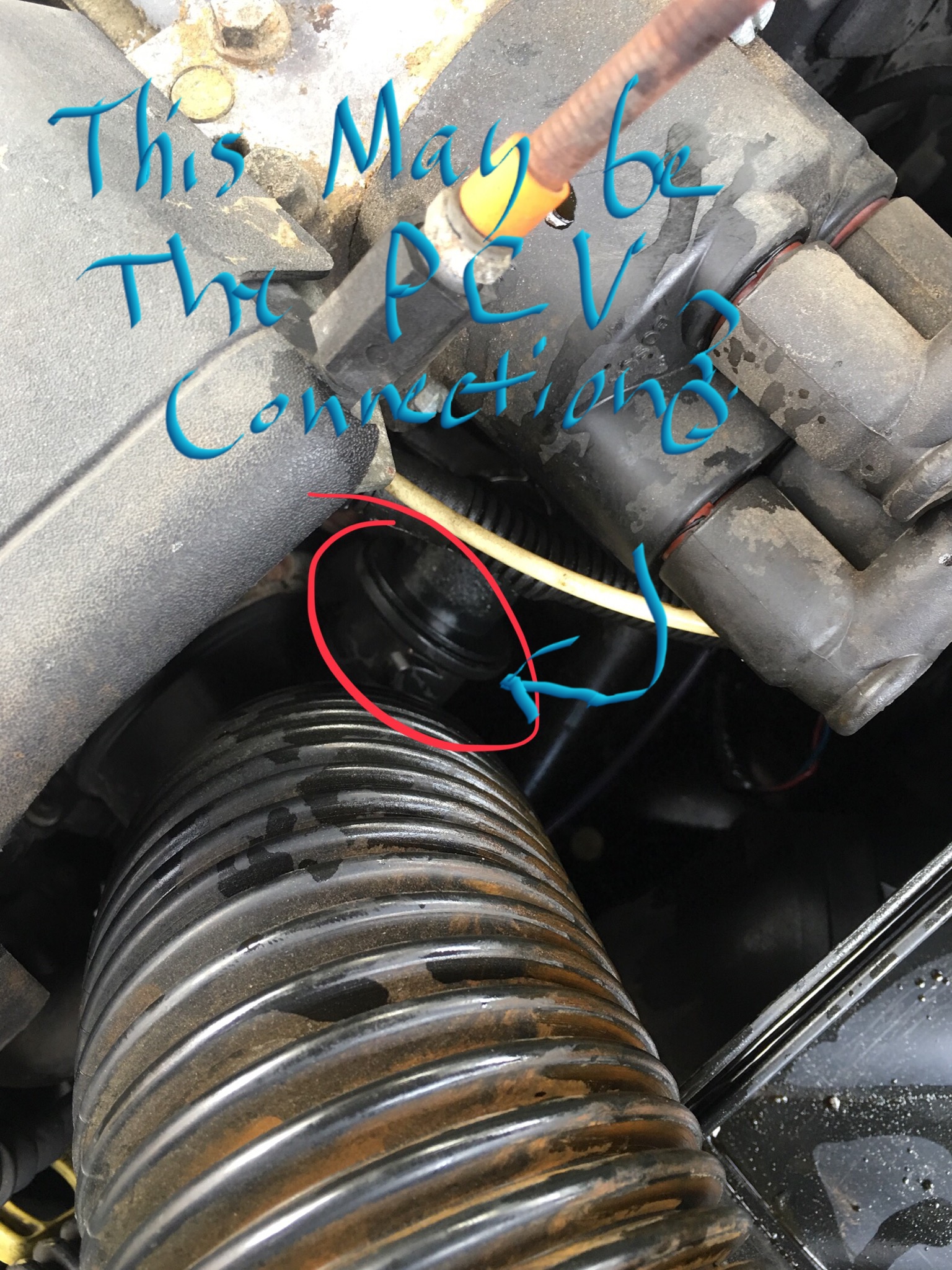

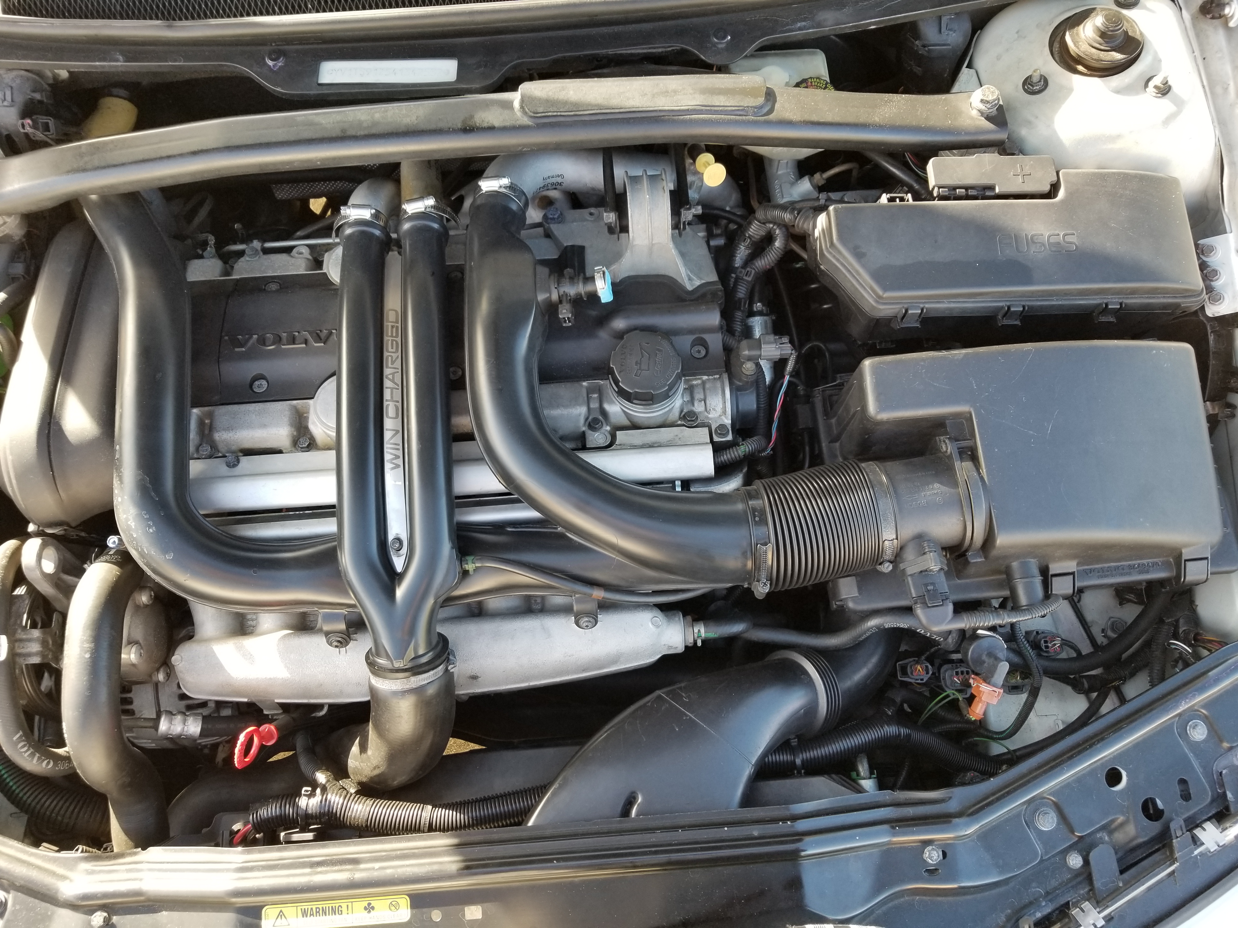

I open the hood and oil is all up the side of the air box, some on the fuse box, the underside of the hood and the relay box (I think oil breached the PCV flame trap, I attatched a photo of the flame trap). I was pretty sure my engine was dead, but it still starts and will move the car, it used to smoke pretty bad on start up but the exhaust smoke has slowly subsided. The PCV was changed less than 8k ago from FCP Euro along with the whole coolant system being entirely replaced from FCP euro about 5k ago.

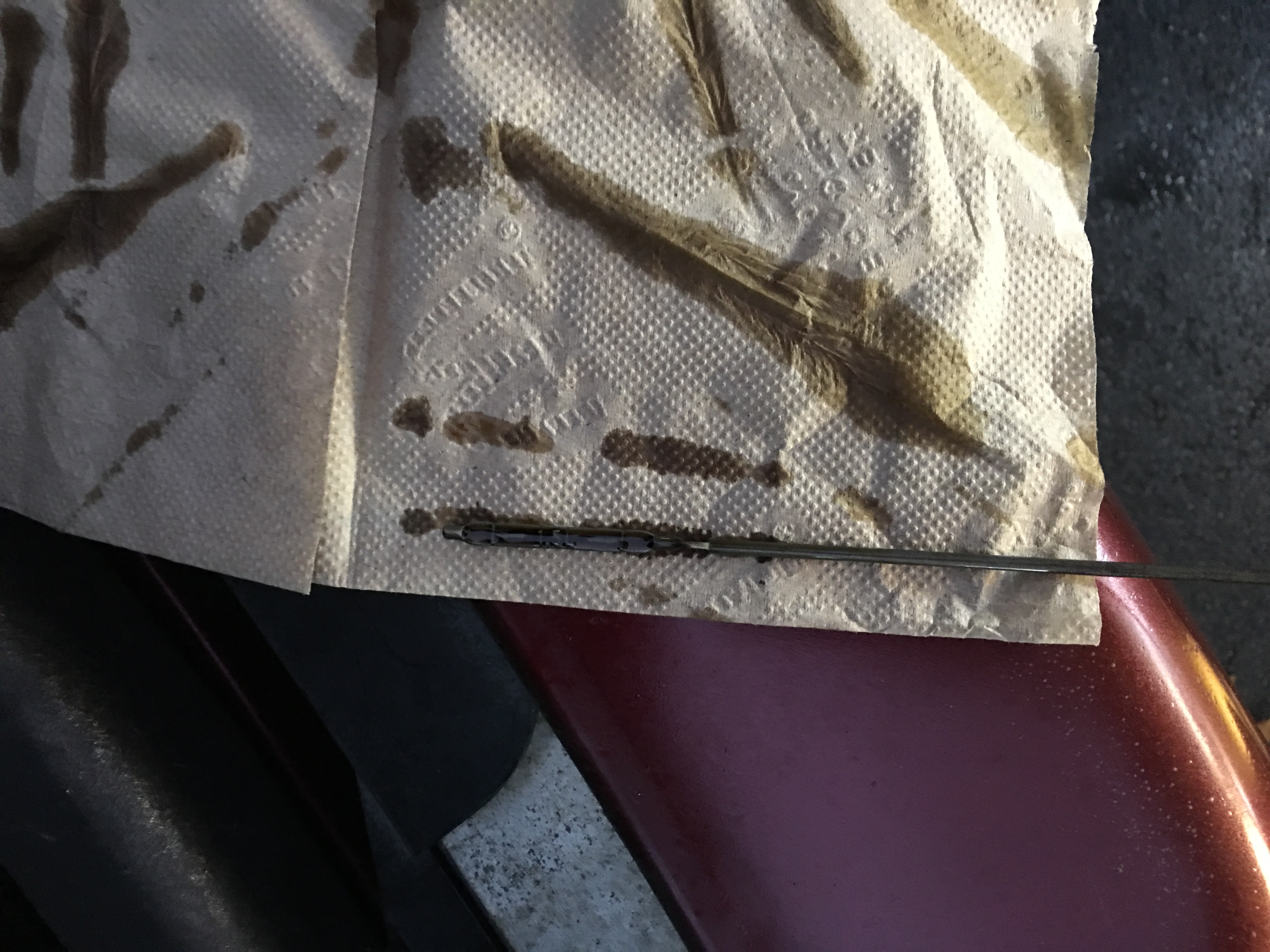

Now: So adding 5qts all at once was a bad idea (oil level on dip stick picture attatched). My whole blow out with all the white smoke was a result of over filling the oil (I believe). I then sucked the excess oil out of the dip stick with a vacuum oil pump and made sure the oil was at the correct level... The exhaust does (not) smoke at all anymore, nor white or blue, it drives and I’ve been driving it to and from school for the past couple days but being very easy on it (Driving under 3.5k Rpm). The car runs cooler now but at idle it goes back up to normal temp, as soon as I start driving on the roads the temp gauge goes back down... I checked the coolant tank and there’s oil in the coolant... This is bad, but I believe it was a result of the original blow out I mentioned earlier in my post when running with too much oil. The car still is running and driving days later... Oil level is the same...

-Originally the dip stick was dry: So I put 5qts in...
-Blow out occurred...
-5qts was too much along with any excess oil that was in the pan so I got the oil right in line with the perfect ammound (Mid Dip Stick)
-Now at proper and exact oil level (normal)...

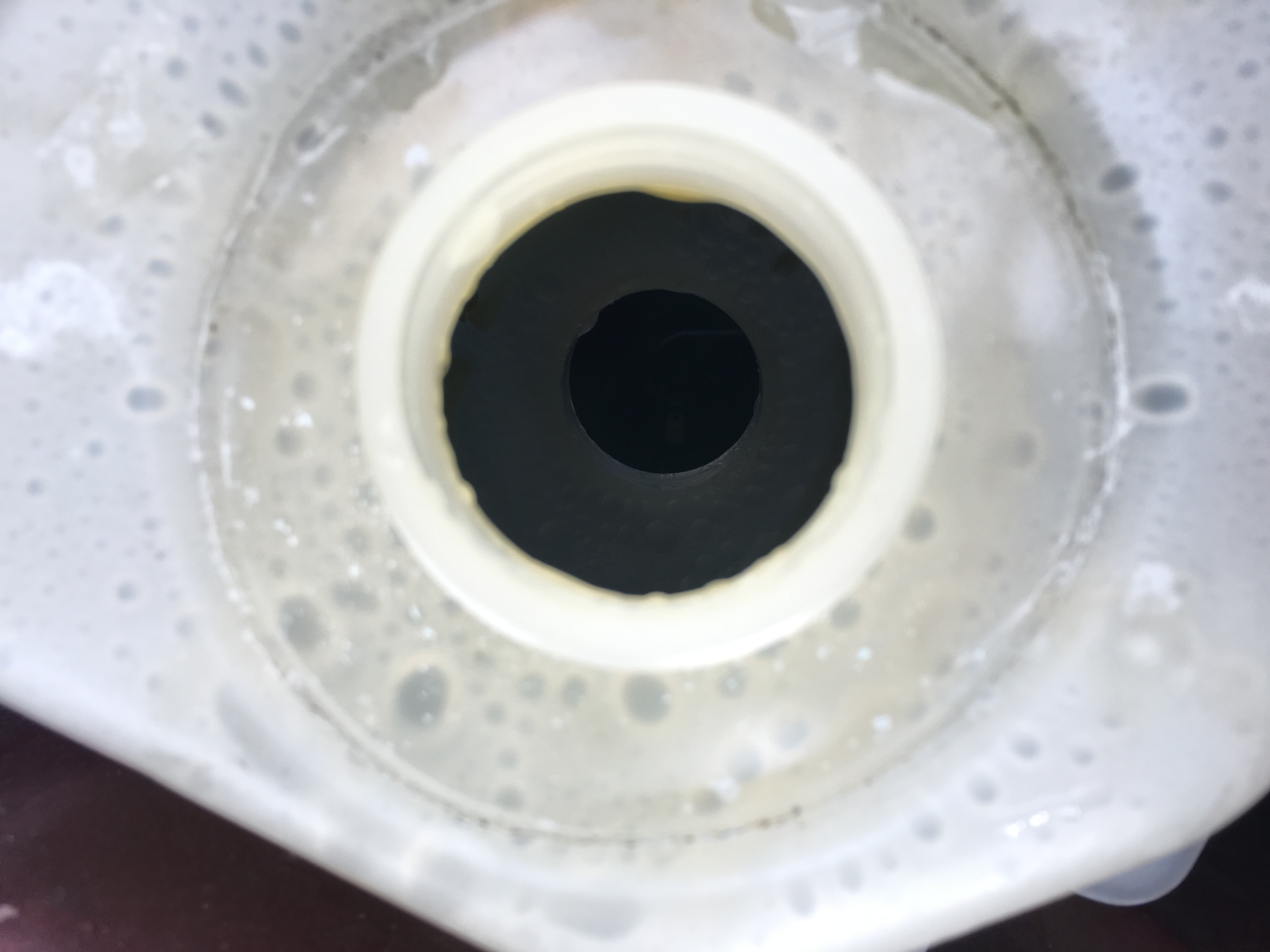

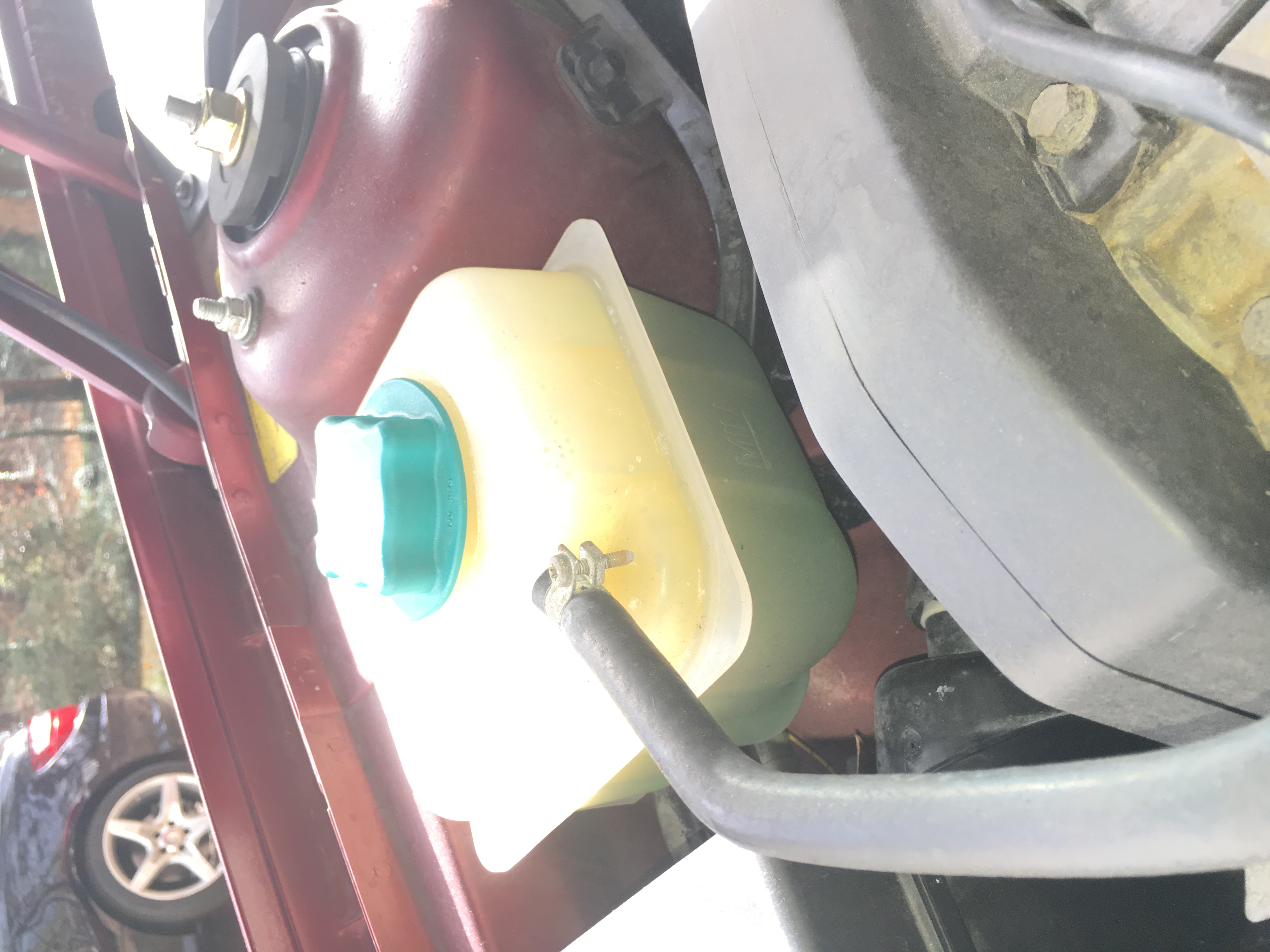

(1) I do't see evidence of oil in the cooling system, can you give a better pic of that?

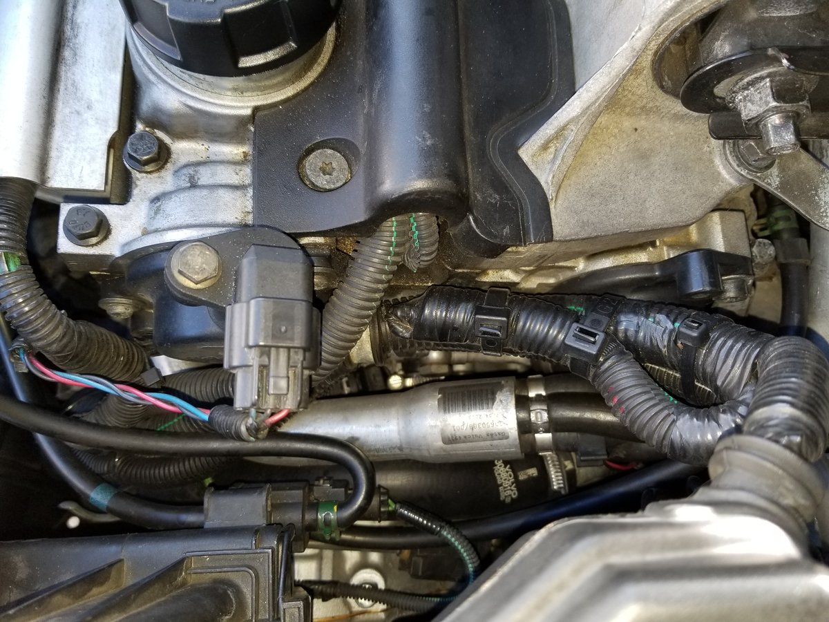

(2) You need to find out where the oil is still leaking some, where you said "... some kind of oil spraying into the engine bay, but I can't find the source"

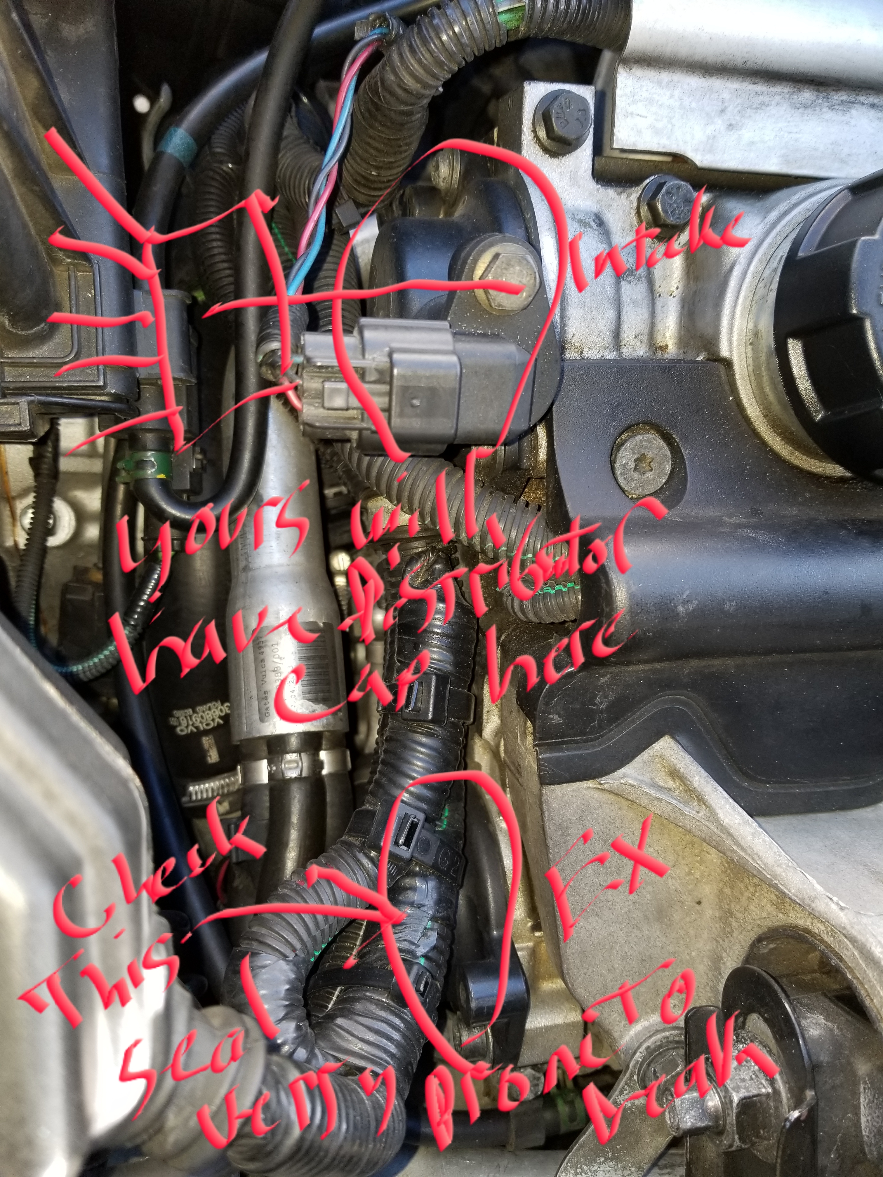

(3) I'd pull the distributor cap and rotor and see if that rear cam seal is blown. If it is, clean up the oil, put the seal back in and check the one behind the cam sensor too.

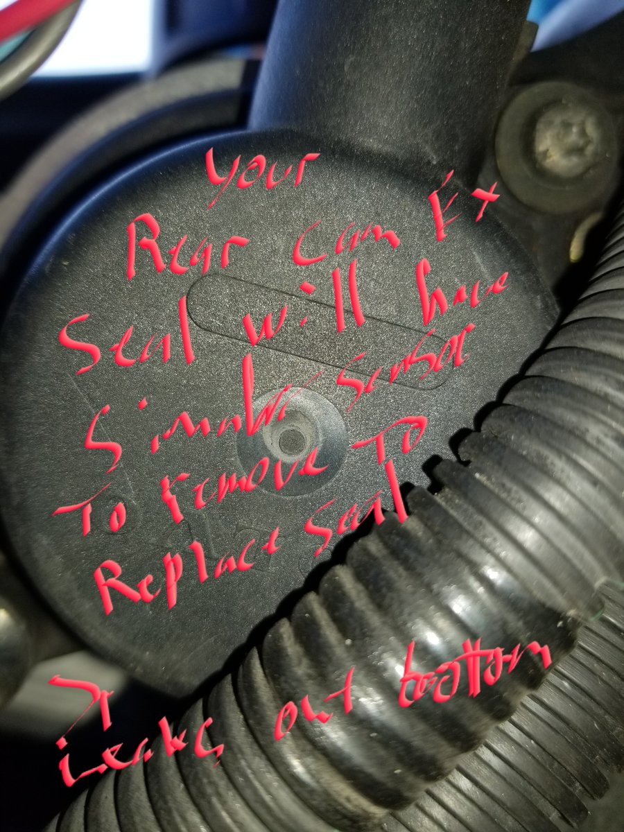

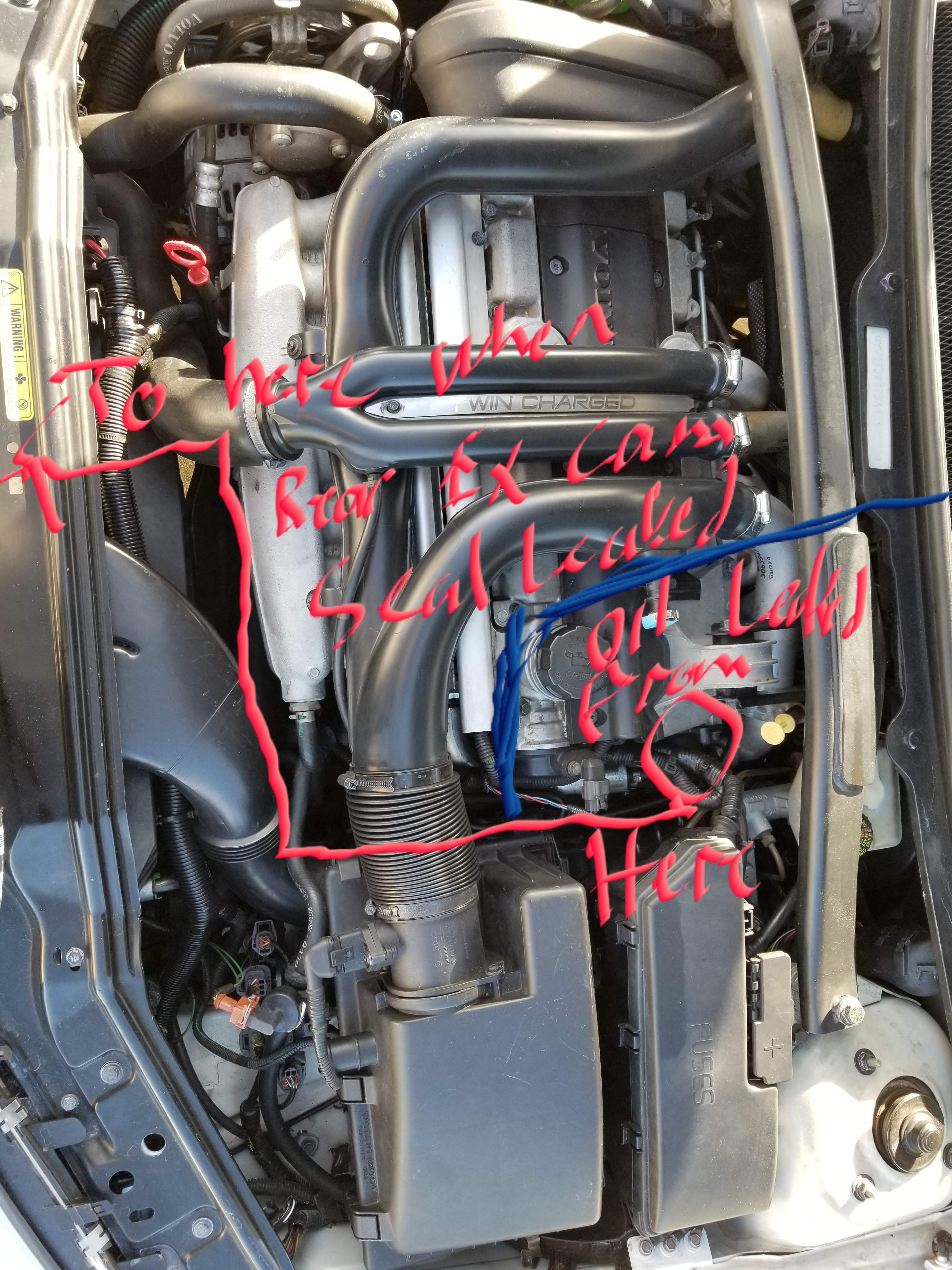

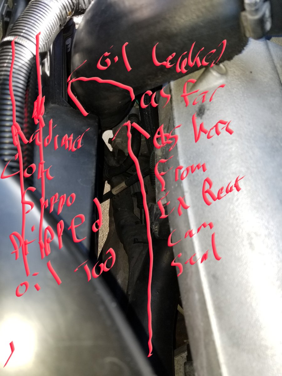

Clean engine and when dry coat with baby powder to see where leak is at. These engines are prone to blow the rear cam seal on the exhaust cam (closest to firewall). My 960, V70, and this S80 all have leaked from this seal. Took some pictures of my S80 to show how far from this seal leak the oil can travel. Your car has a distributor where I penciled it in, but mine does not so it does look slightly different. Mike changed the seal on the 98 V70 on the road as it was easy to change on that (your) car. Hope this is where your major leak is. June

Your car will certainly run with those seals blown out, but you're going to lose oil at a rapid rate if they're mostly blown out. As Erik said, pull the distributor cap and check for a leak. Same with the cam sensor on the exhaust cam. Those are extremely common areas to have a leak.
Also pull the timing cover, it's just a single 10 or 12mm screw and you can pull it off. If there's oil in there, it could be coming from either one of the front cam seals or the crank seal. Rear main seal leak would be evident from oil between the engine and transmission.
As June said, clean the engine bay of oil first. It's hard to find a leak when there's oil everywhere.

I cant really see the oil in the coolant tank via the pictures. You can get a loaner head gasket tester from the auto parts store. The area you circled, is that the connection for the PCV to intake hose? The attached video showed you how to use the test kit. Either it is blown or not this test is how the dealer checks for sure. June
