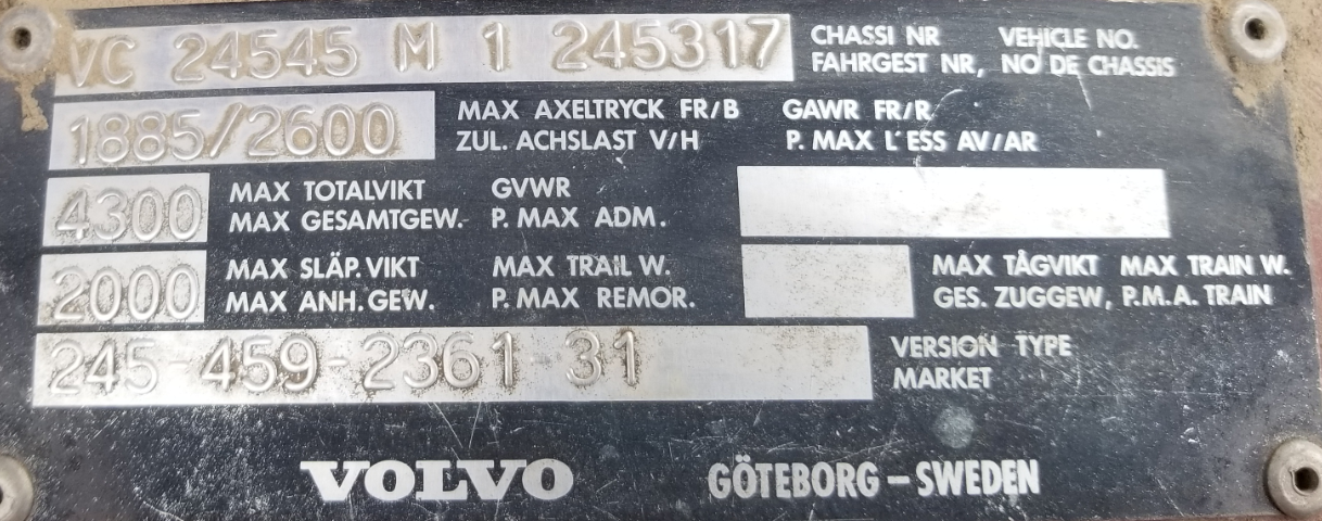

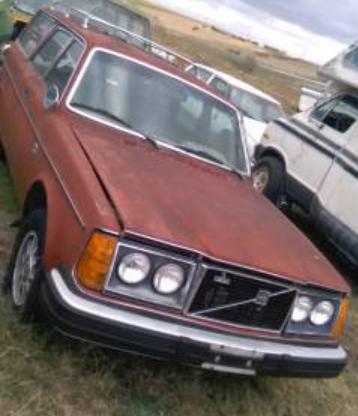

This is a pre 1980 245, without a drive line (engine-transmission gone)....at VolvoClub's site, they don't give VIN info.
I think VC 24545 means a 2.1 fuel injected engine (B21F) in a 245. "M...1" I'm not sure about...vehicle has a auto shifter in it
Any thoughts here on exact year?

Maybe this is what you're looking for...
https://www.volvoclub.org.uk/vin_200.shtml

lummert wrote: 12 Dec 2018, 09:47Maybe this is what you're looking for...
I came across a site later with decoding info for pre 1980 Volvos:
Its a 1979 245;
Vehicle was sold in California....31 = California
Sadly, someone removed driveline, and a scrap dealer has it now. I could get it running again...with my spare engines/transmissions, but what's the price is the question now.
