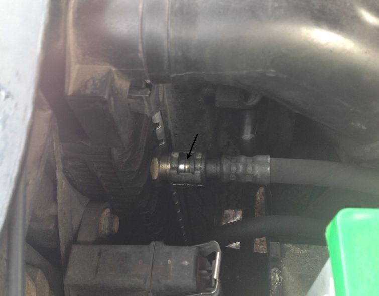

Thanks for the response, abscate. My husband was relieved to hear it may well be so simple a fix. And possibly with a Lowes ziptie -- even better. Thanks to your suggestion, I took a photo. The arrow points to the part where the oil comes out. He said it spurts out from the underside of this part when the engine is on. Any further thoughts, abscate or anyone else?
Thanks for your help!
Laurie
PS - Not sure if the photo is attaching properly. If it doesn't show in this message, I'll try attaching it separately, in another message. Oh, and we're exit 19 off the thruway. 3 hours and change from metropolis.

That is the upper transmission line going to radiator to cool the fluid. O-ring in connection could be bad. Dirty ATF would like motor oil. Zip tie on top of metal clamp as security blanket.

Wow, if that is the ATF, it sure needs to be flushed! It was dark. Will replace the O-ring (and add zip-tie for good measure) and be in touch if we have any more questions. Thanks so much, crlande. - Laurie

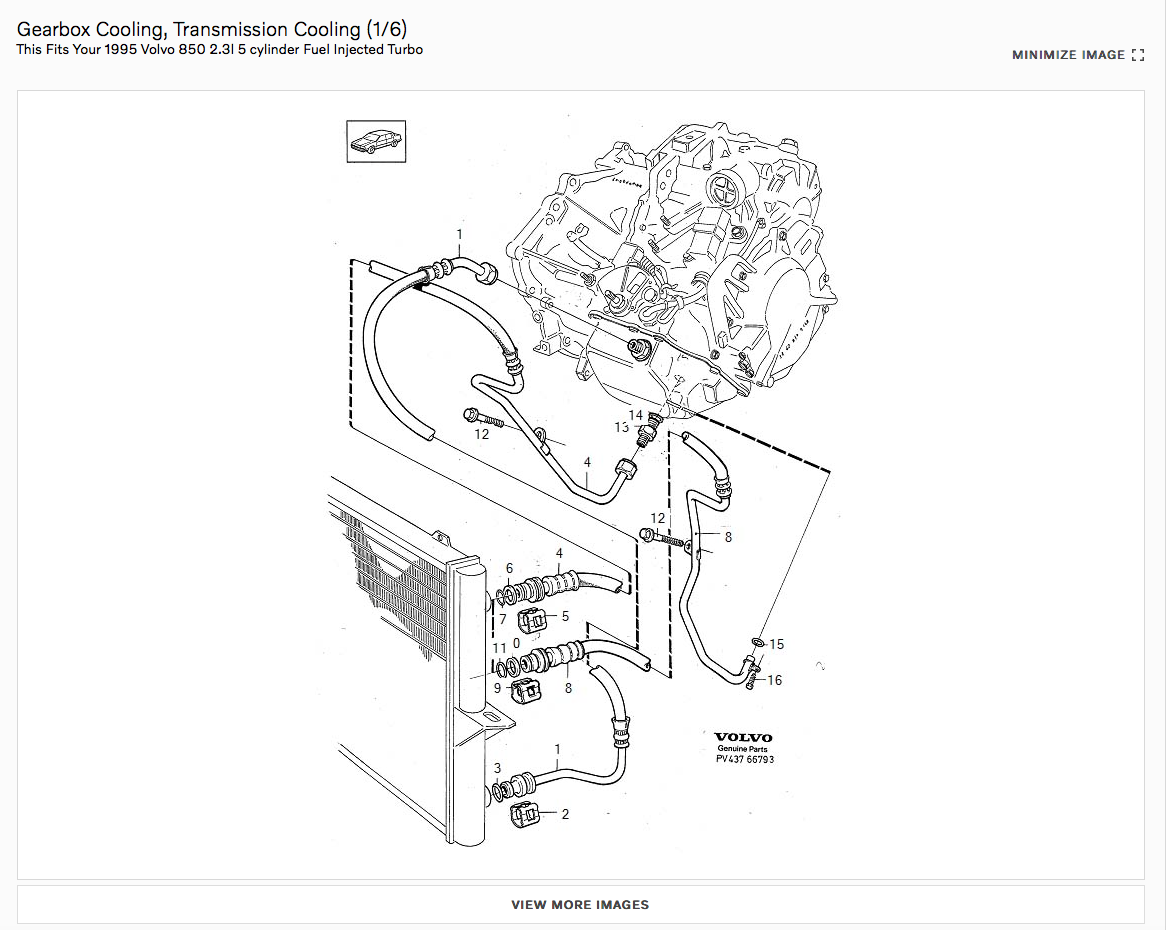

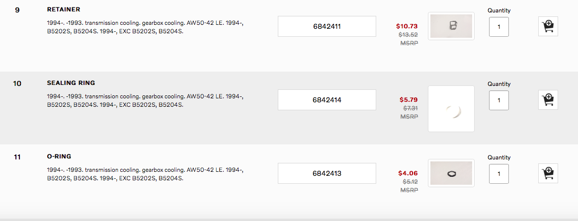

Here are some pics and a request. Can you put your Orings on a scale and take a pic so we get the size documented?
All we need are outside diameter and thickness, roughly.
One day, someone will need to buy these locally so documenting it here will help them from tearing it apart
Here are some pics covering the earlier trans cooling models parts and numbers.
Added part number, model year to thread title
