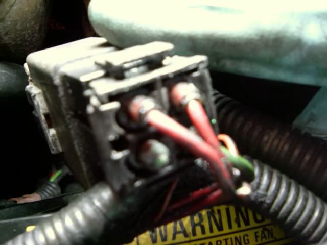

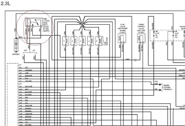

I FOUND THE PROBLEM! It turns out that my fuel pump was not kicking on as I thought, so I checked the fuel pump fuse and it was fine. I then checked to make sure all of the connections were pushed in all the way on all of the relays and they were fine. Checked all of the connections on the motor and they were fine. So I looked up some wiring diagrams to see what could cause the fuel pump to not kick on and found that there is a Main relay under the fan shroud that controls fuel system. I went back under the hood and decided to slide the whole relay out of the shroud and double check all of the wires, well when I did this I found that the orange/black wire had broken off of its connector! I took the old connector off and crimped a new one on. After I did that it started right up! So, if anyone is moving those relays around on the fan shroud and your car wont start, check those wires because they seemed to get very brittle with age. Here is a pic of the broken wire and the wiring diagram of that relay.
