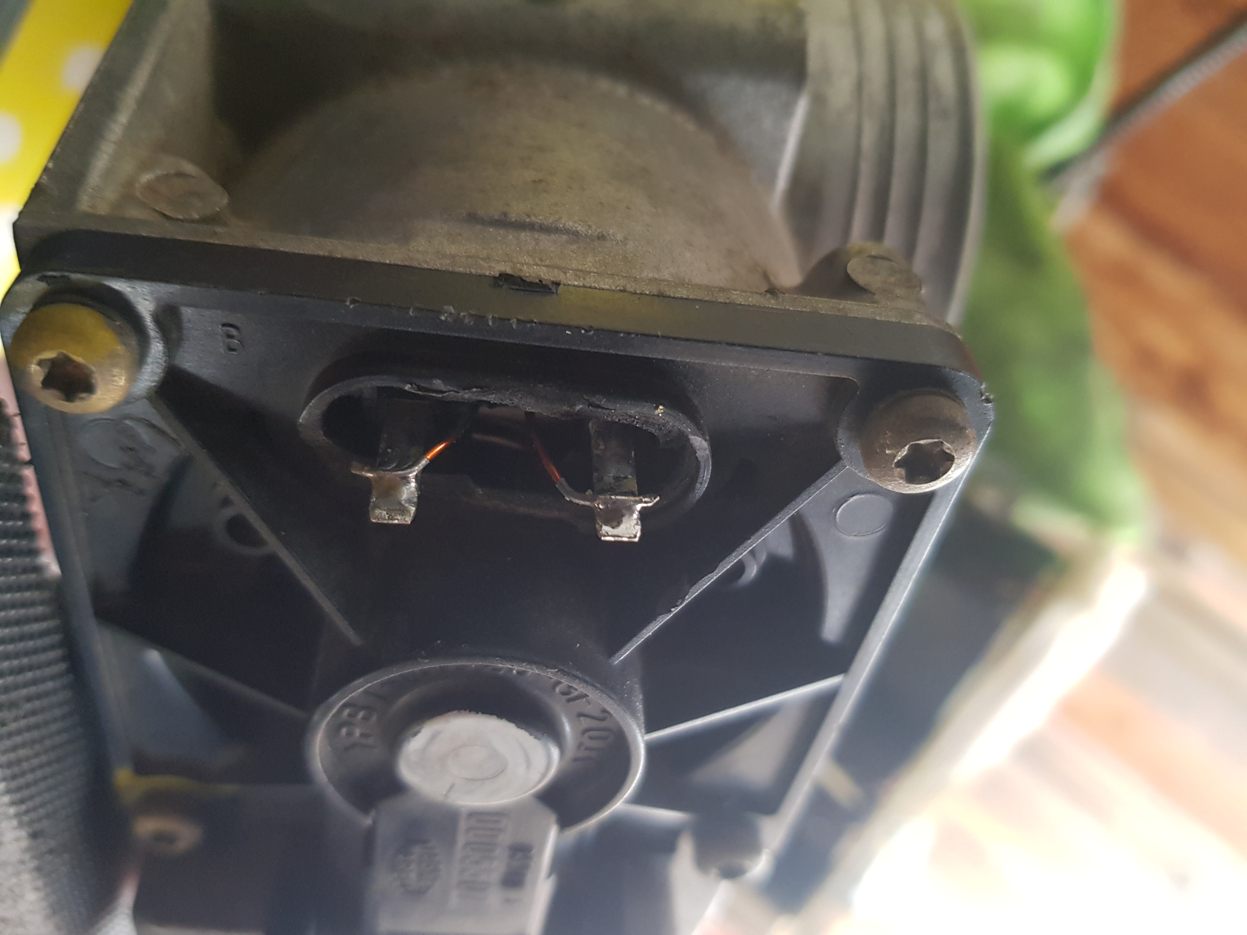

If you undo ANY side of the throttles' torx screws you can damage the electricals.
Both sensors have spot welded terminals. Fortunately you can re-solder them if you remove the rear cover and grind away the green or black putty to expose them.
If you have no flap movement upon applying ignition in PosII you may have damaged the flap motor's terminals. In this case just remove the bulbous terminal cover and re-solder them.
Looks like you need some good exploded diagrams of the hose arrangement
