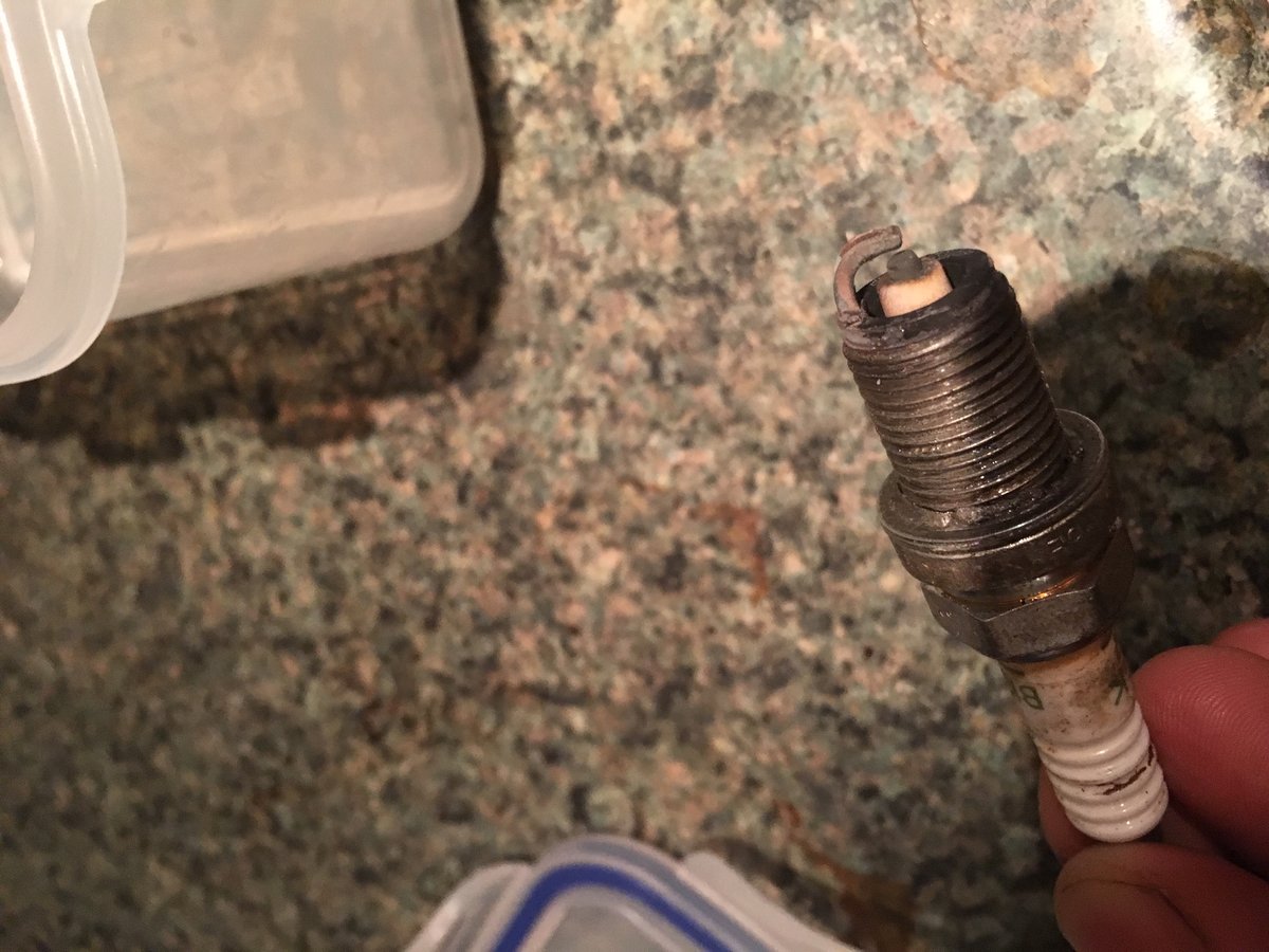

Hey fine folks,
I've been having some trouble with my 98 V70 turbo wagon stumbling and misfiring under hard loads and acceleration lately. Normal around town driving is fine, even most highway, but when accelerating hard up long hills the engine stumbles and rpms drop slightly. This problem finally got bad enough today to throw a blinking CEL P0304 (Cylinder 4 misfire.) I pulled the plugs (NGK 6962 coppers, see pic) and while none looked terrible in my opinion, the gaps were all .033 - .037 (put these in ~15k miles ago). I plan to throw some new Bosch coppers in and see how it goes, but any other ideas for what could be going on here? I replaced the fuel filter recently (after this problem started though) and did a compression test about a year ago - ~163 psi on 4, ~170 on the rest. Cap/rotor/wires are bosch, probably about 50k miles in. Thanks!

A gap of "0.037" is way out of spec. New copper plugs gapped to 0.028 would be a good diagnostic start. A new compression test would not be a bad idea either.

I definitely gapped the plugs to .028" when I put them in a year and a half ago, wonder how they grew so much... Will throw some new ones in and report back! If that doesn't solve it, would y'all move on cap/rotor/wires ($100, easy), vacuum lines ($40, more work), or servicing/replacing injectors ($100-$150, easy) next?

Ran a cold, dry compression test today, and got 170, 165, 170, 155, 170 on cylinders 1-5. So cylinder 4 (the misfiring one) is a bit weak but 155 psi still seems fairly ok no? Still within 10% for what its worth. I ended up pulling the distributor cap when I put in new plugs, and there was a good bit of oxidation on the cap contacts. Unfortunately while brushing them, I knocked the center brush out, then managed to lose it so guess I'm doing cap/rotor/wires now too anyway.

A warm compression test and especially a leakdown test will identify if cylinder 4 has bad rings. Under heavy load it may not be maintaining compression.
