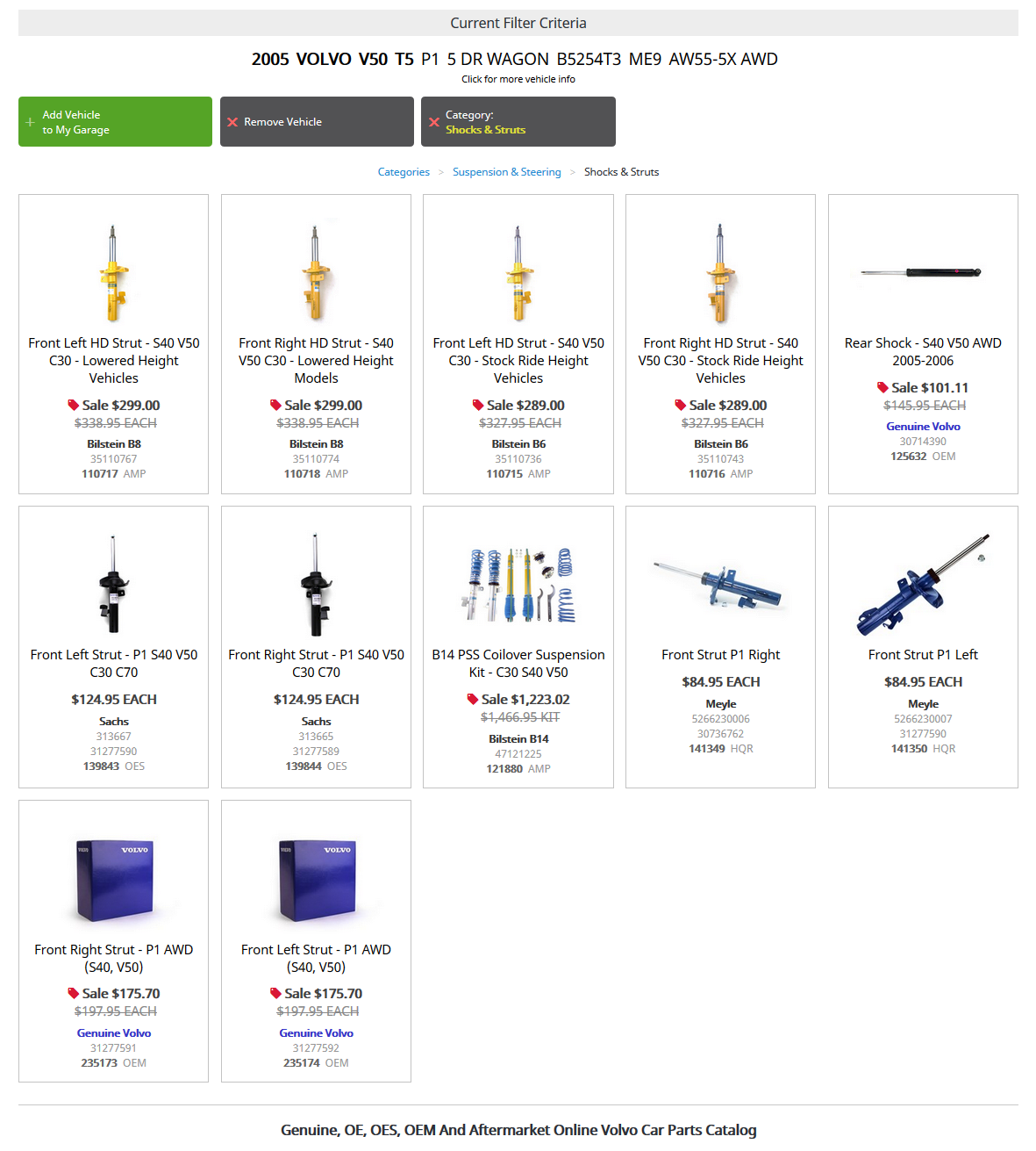

Ronnieboy wrote: 05 Feb 2023, 12:43 I know this to be an older post but having recently acquired a 2005 V50 AWD that needs struts I found the FWD and AWD are NOT the same. It must be a difference in dampening rates as the physical housing is identical. This makes sense as the AWD versions of the S40/V50 would have more weight over the front than a FWD version. At first I was happy to find a kit at FCP but on further detailed inspection those kit struts are NOT for AWD. In fact, the only struts FCP shows for AWD are genuine Volvo at a higher price and are not in a kit. When you look closely at the kit individual part numbers, the right-side strut does not show to crossover to the Volvo part number. I went to Bilstein's, SACH's, and other web sites directly and they do NOT make an AWD strut for these models. While the FWD versions will physical fit, they are not internally designed for AWD.
IPD shows quite a few struts that work for the AWD and is compatible with other P1's. I don't believe manufacturers including Volvo will spec a strut for just a few pounds. Two 250lb front passengers vs 2 150lb passengers are a huge difference on the suspension. The difference has to be made up in the spring rate as it's much easier to manufacture besides cheaper and basically no development needed as compared with struts.
1AAuto has Lifetime Guarantee on Quick Struts. Since it's an easy install it might be the way to go. The video should be the same for all P1's. We have Koni's up front and Bilsteins in the back on our 08 C30 T5 2.0 M66. For our 05 GS430 we are using the TRQ set of struts and shocks and they work well.
https://www.ipdusa.com/Catalog/Index?CA ... archwords=
https://www.1aauto.com/volvo-c30-c70-s4 ... 75387/2005

CARID shows quite a few struts for the AWD and it list the Bilstein B6. However, the same strut is listed for FWD on RockAuto and with basically no struts for an AWD.
https://www.carid.com/2005-volvo-v50-sh ... l+Drive%29
https://www.rockauto.com/en/catalog/vol ... strut,7584
