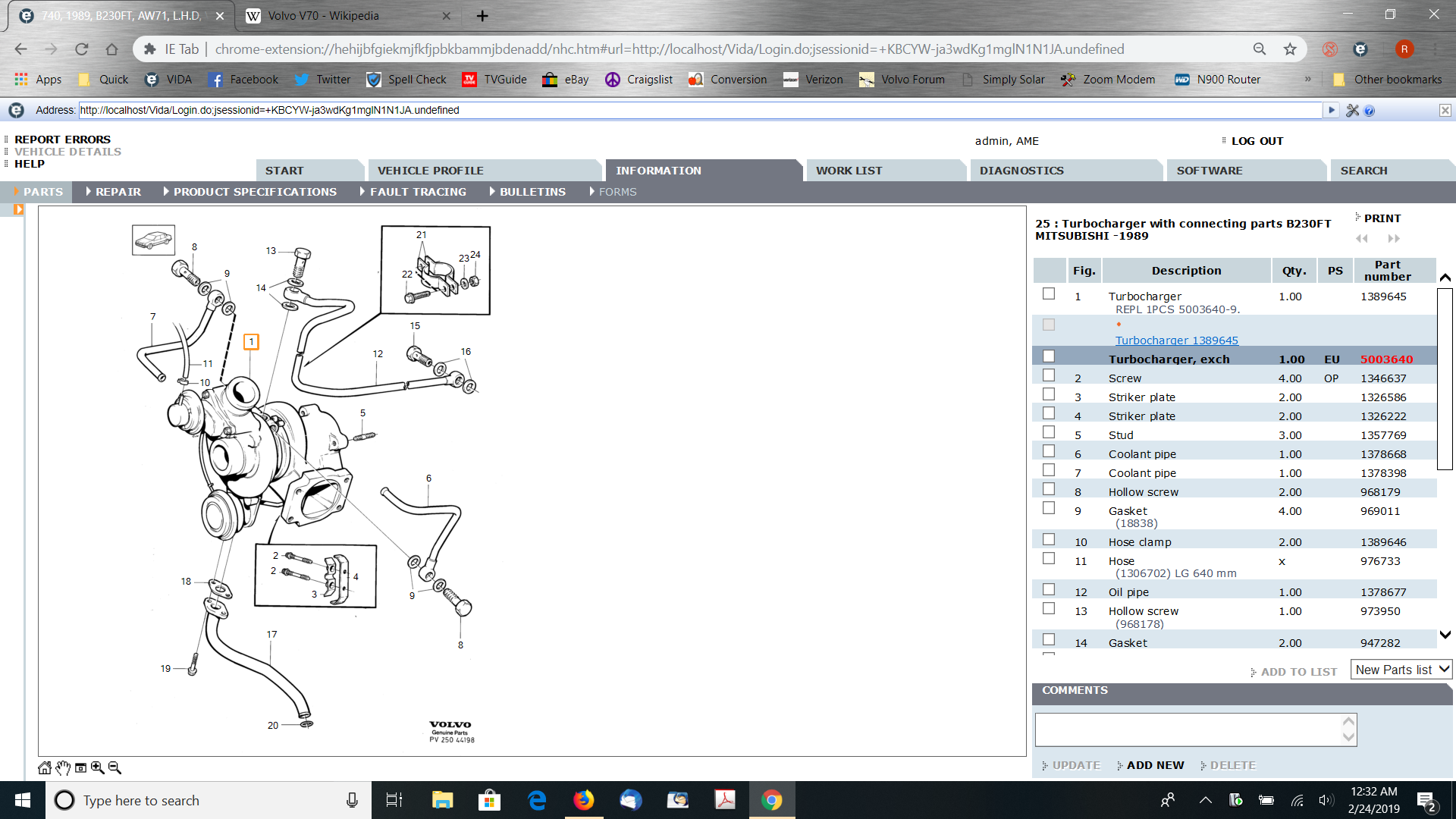

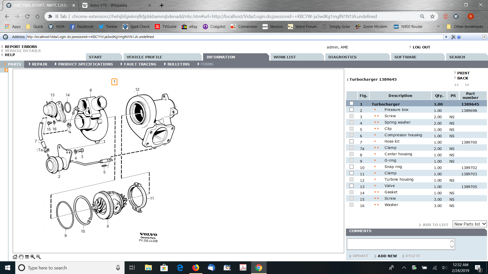

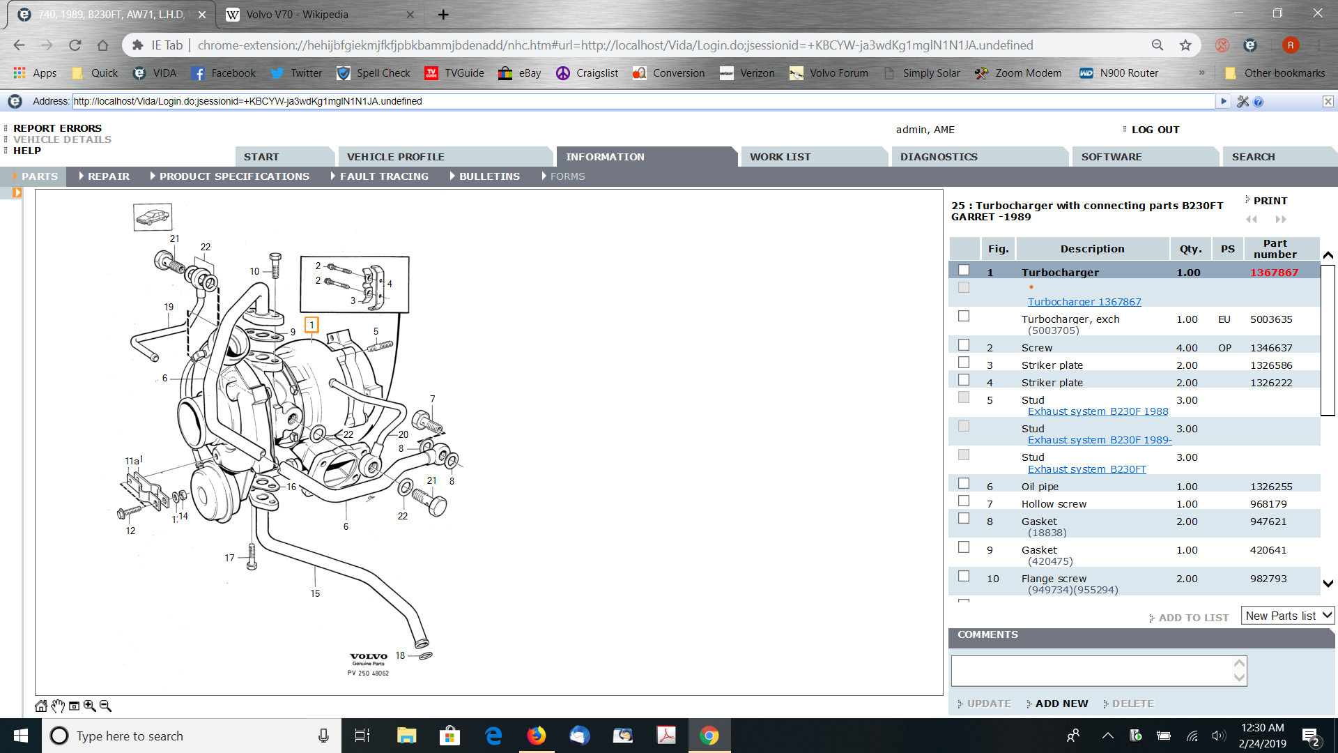

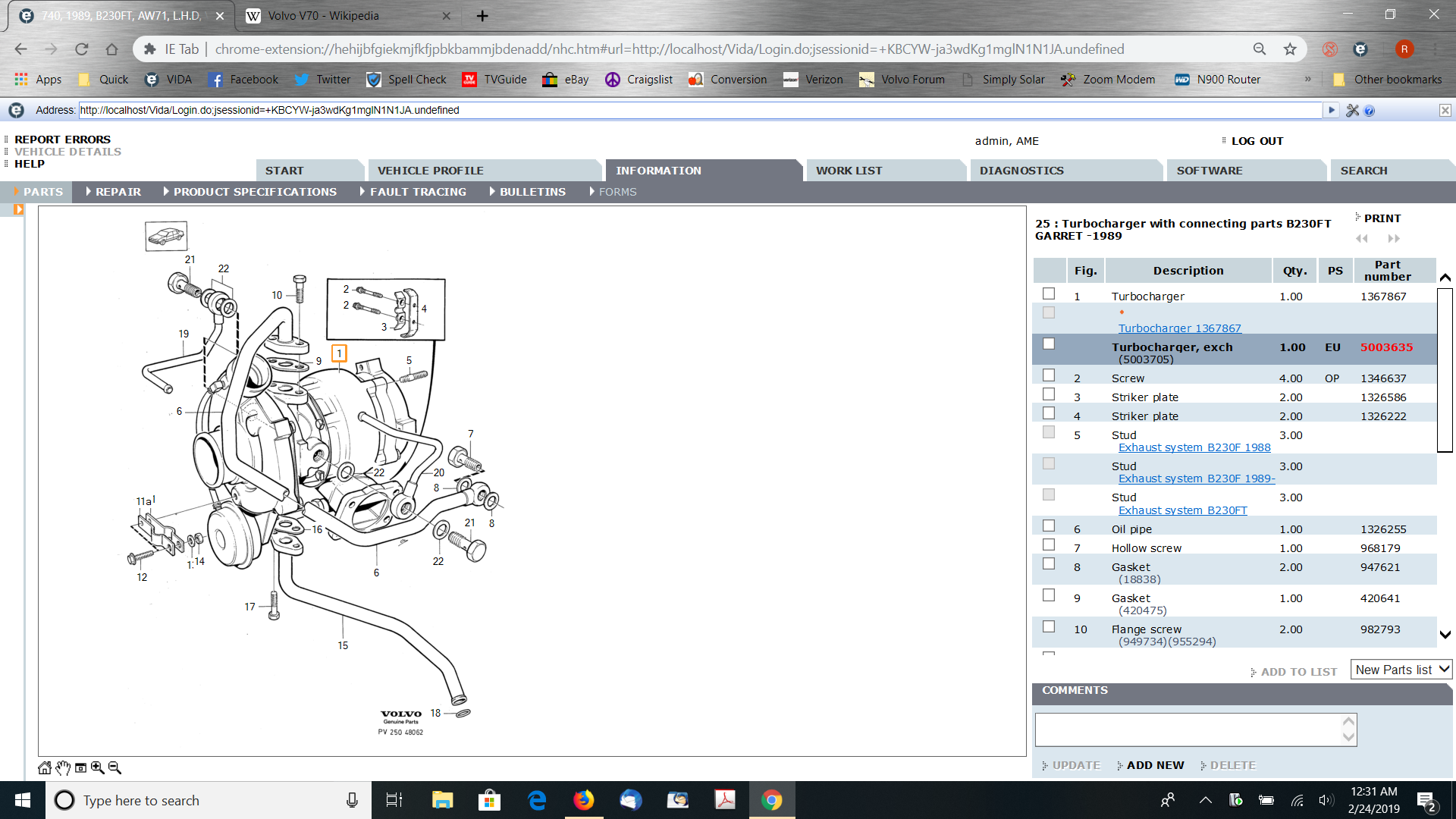

Looks like there where 5 different turbochargers for the 1989 740 with a B230FT. Two Garret and three Mitsubishi. Which one do you have?
These are all Full HD pictures, click on them to zoom in. The part number of the turbo you are viewing shows in red.

tardcart
Posts: 410
Joined: 8 February 2019
Year and Model: 96 850t. 93 940t
Location: Pittstown Nj
Has thanked: 3 times
Been thanked: 37 times
Post by tardcart »
great interactive diagrams. I would be thinking about swapping in another compressor housing from the newer TDO4-13 on the 940
and many others with same size turbine, or swap in a complete 15g from an 850 v70 s60 for more boost. However this might not be the only problem with your turbo, even with a leaking diaphragm the bypass spring should keep it closed for maby 5lbs boost. The seal area doesn't rip I think. You just dont have the manifold boost pressure pushing on the diaphragm helping the spring to seal the bypass.

Mine is the 1389645. I can tell by the funny shape of the diverter valve there

Thanks by the way that looks like a dealers diagram
