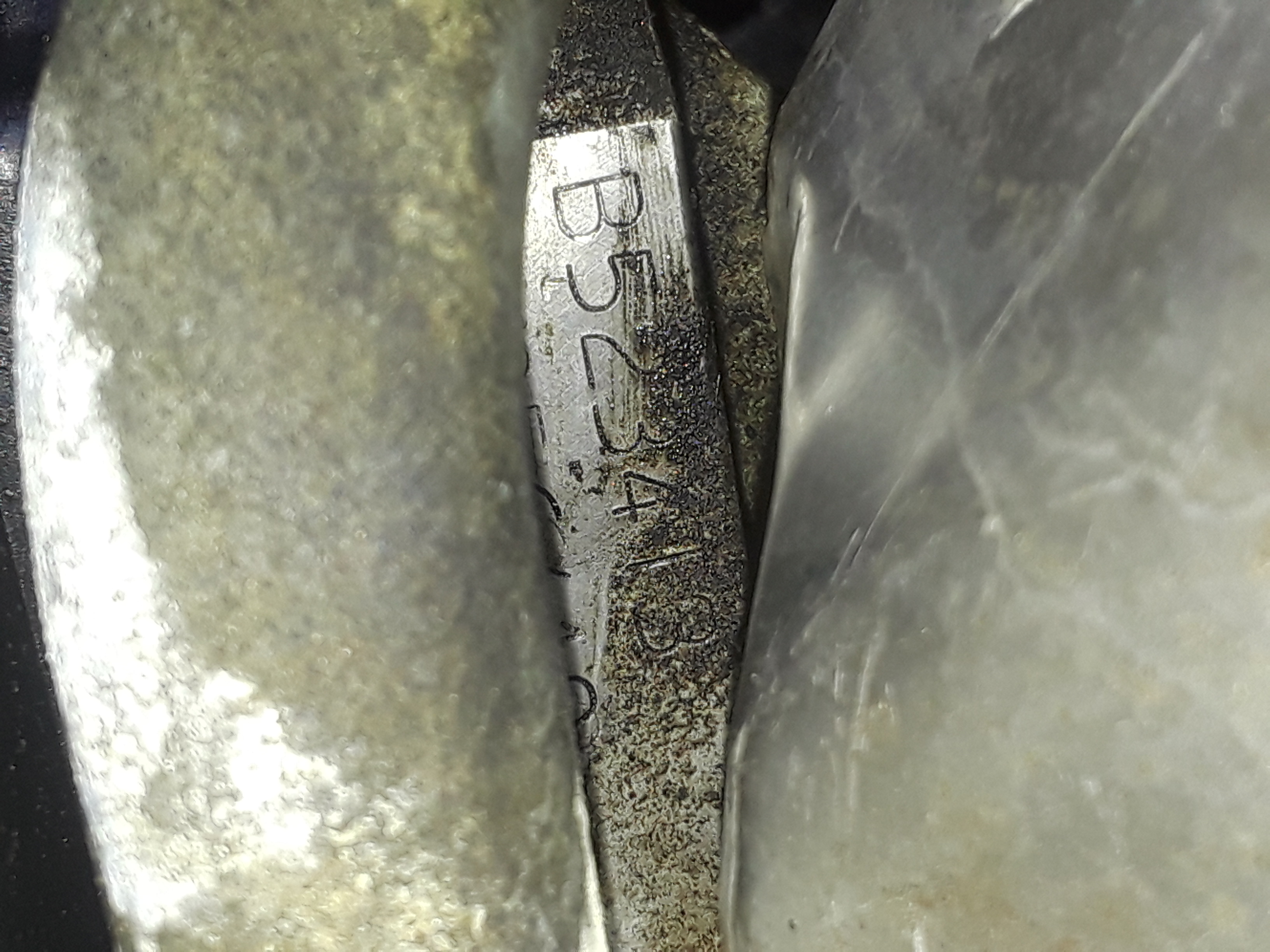

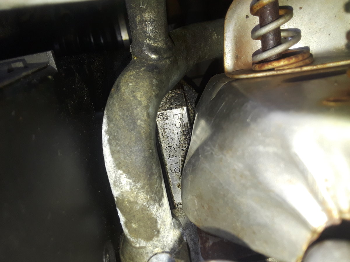

Yeah, the timing cover actually didn't have the identifying sticker on it so those numbers are from the back of the block. It took a lot of coordination with my phone and a light to get those pics lol.(I'm not sure I've attached them right....)

Rock and roll...remember the VIN TOOL won't work because of the engine swap and head swap? That's new territory here, haven't seen a lot of discussions on head ID

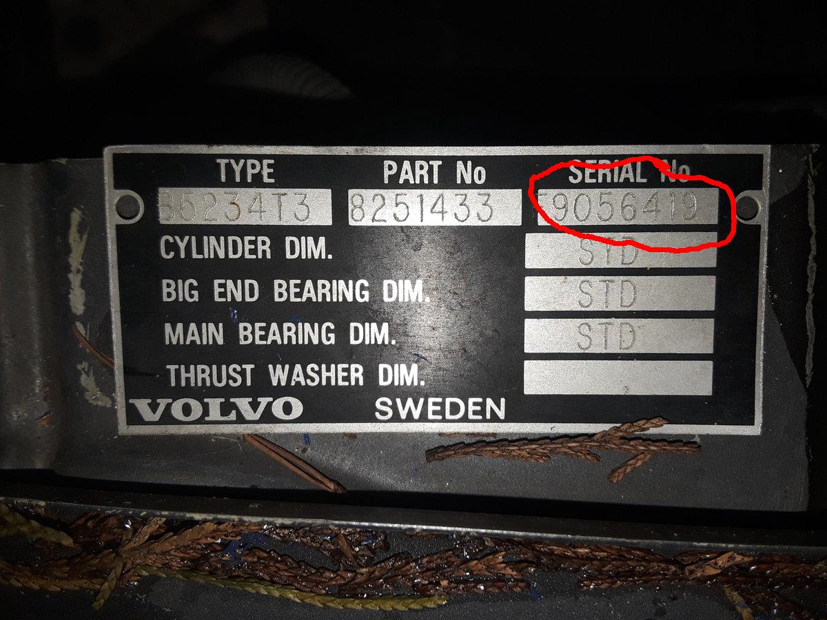

It's already been determined in a previous post that the engine number posted here matches the engine supplied with the car: the numbers from the block match that ID plate exactly.
The head may have been swapped and the block stayed behind, hence the factory engine number.
