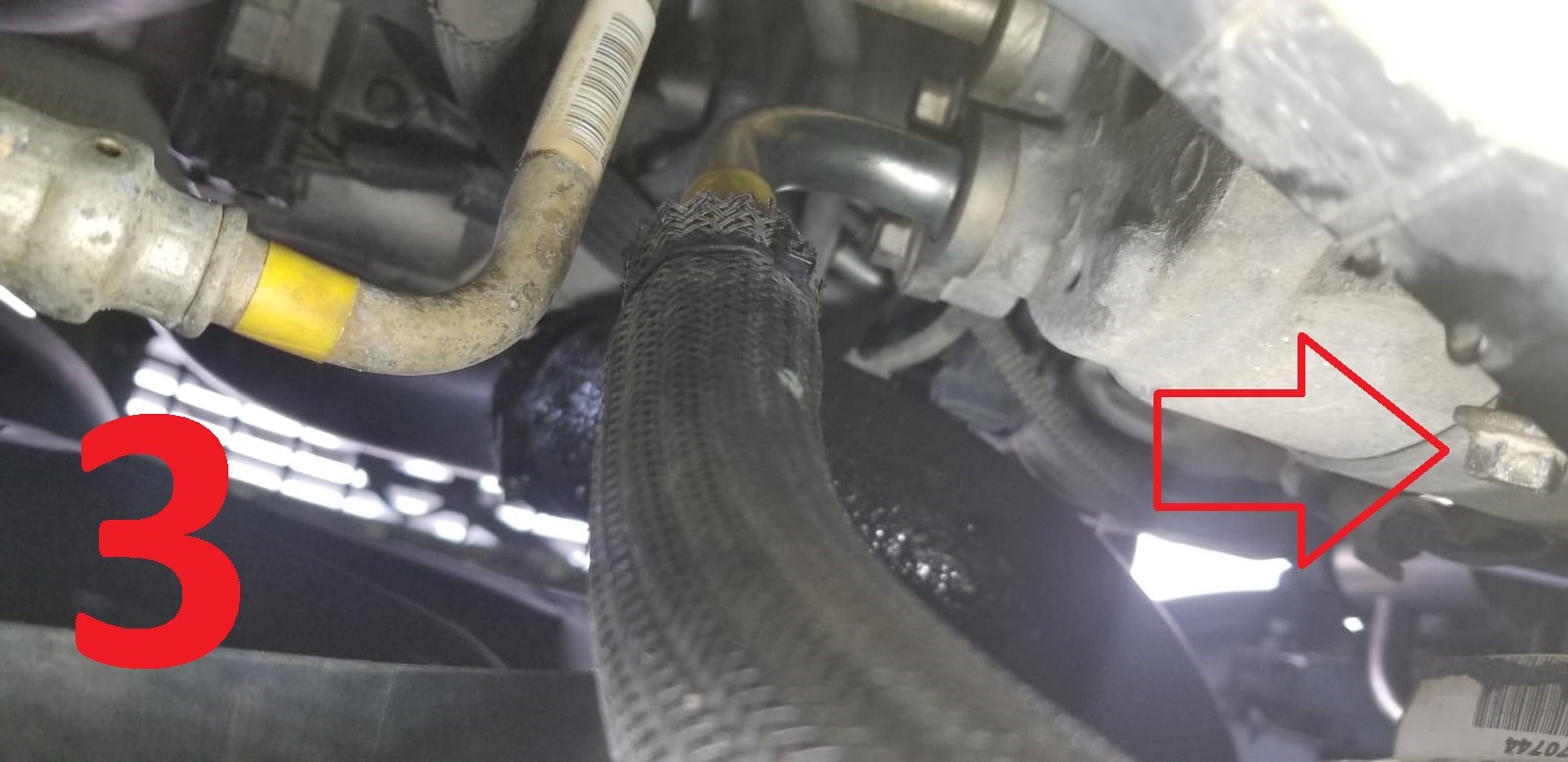

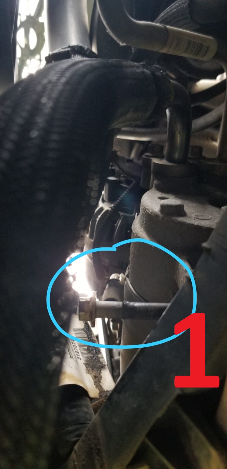

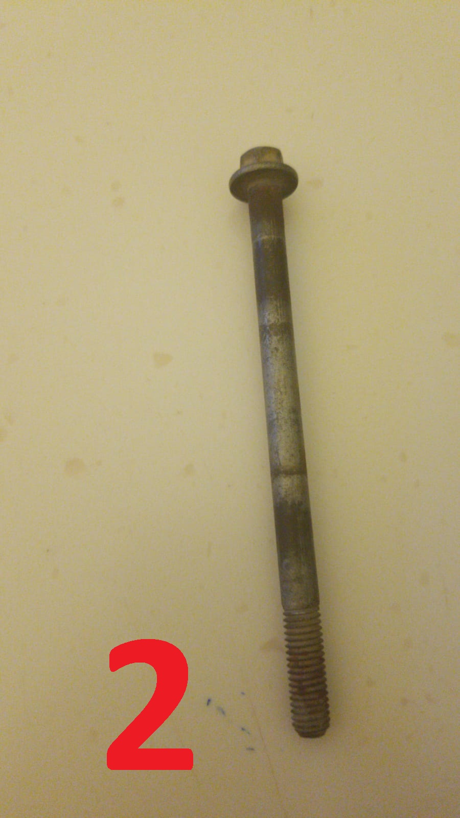

I noticed when doing an oil change recently the securing bolt for the compressor was sticking out and was completely loose (pic 1). Whilst under the car I found a second similar bolt in the lower plastic valance (pic 2). I am guessing this is the reason for the rattle!
I tried to do up the first bolt (12mm spanner) but it sticks out 20mm or so when fully tightened (pic 3). Is this normal?
I cannot see how to get to insert the second bolt either from above or below - let alone how to tighten it up. Do I need to remove anything to get access? As you can guess I am not too familiar with the XC90.

I don't know the XC90 well but if its the same mount style as the P2, starting in about 1999, you probably have to loosen the top mount bolts to make sure the bottom ones get seated right into the engine mount.
Both those bolt heads should go flush to the AC compressor frame, correct
I think that is the cause of the rattle too.

Is it possible that there are the thread remnants of a broken screw in the hole, not allowing the screw to fully seat? You could measure the hole depth with a piece of wire or similar, then measure the length of the screw to see if it matches.

Any clues how to get access so I can get the second bolt in?

These bolts usually get stuck in there, I recommend either order them from Volvo or get a few from the junkyard
My guess is PO put the wrong length of bolt in there. These two bottom of the compressor bolts are similar with the two upper ones front alternator ones, but may be shorter. To remove or insert the right compressor bolt near the center of the car, loosen up completely both of them, toss the compressor a little to make an angle, insert the bolt into the compressor bracket then put the compressor back in its place. This way should work, otherwise the right bolt gets blocked by the radiator fan unit.
If the compressor pulley rattles, the bearing is shot www.youtube.com/watch?v=KAGDkwYSFY4
