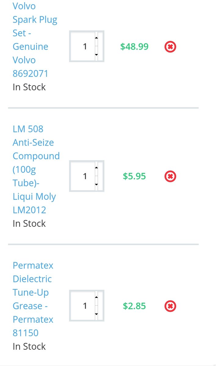

I'm at about 65k miles, and am overdue for the first spark plug replacement. I'm a beginner for car repair stuff - have only personally done air filters and some fluids. Currently have the following in my cart at fcp:
What tools are required / recommended for this? I know I need torx bits for the plastic covers and the front of the charge pipe. What size sockets do I need for the rest of the charge pipe, coil bolts, and spark plugs themselves? Do I really need a torque wrench or can I just tighten to snug and then a quarter turn more? Should I use the dielectric grease and anti seize compound? Getting differing opinions online.

Thanks everyone! I'm gonna get a ratchet set with spark plug socket, and torx set and order what's in my cart. Will report back if i have any problems.
