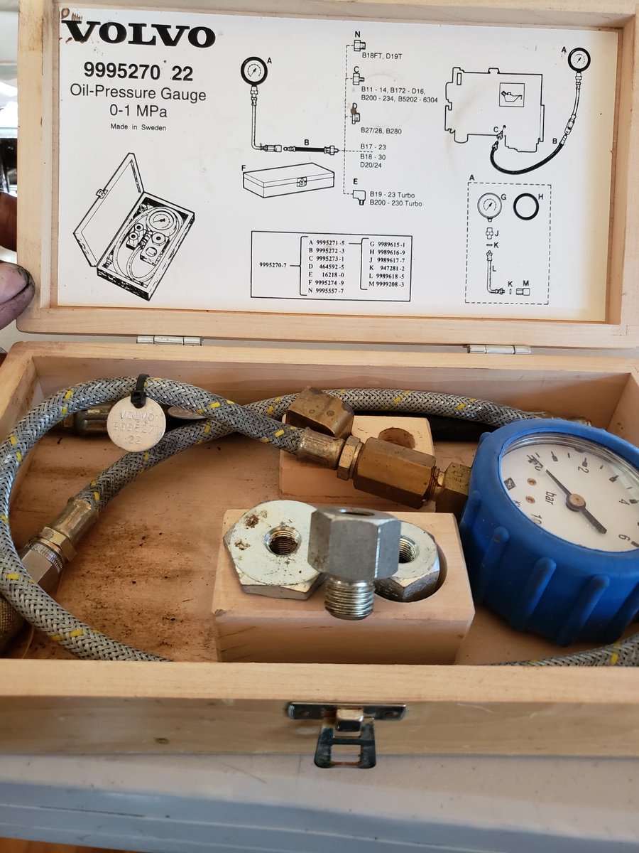

If you have an old oil pressure switch you can knock the head off and drill and tap it for the 1/8 NPT fitting that are universal with oil pressure gauges. The thread size is 14x1.5 but it seals with a washer.
The oil pump is not rebuildable as there is no service kit, you replace it. Oil pumps are rarely the cause. If there is any oil in engine the the pump is lubed. Some engines have pumps that are problematic (Buick V6 and V8 for one) but these pumps are not usually it. If the relief has something stuck in it where it is dumping some of the pump output then that can be removed by disassembling pump. The adapter at bottom of the photo is the Volvo adapter shown in the oil pressure gauge kit.
