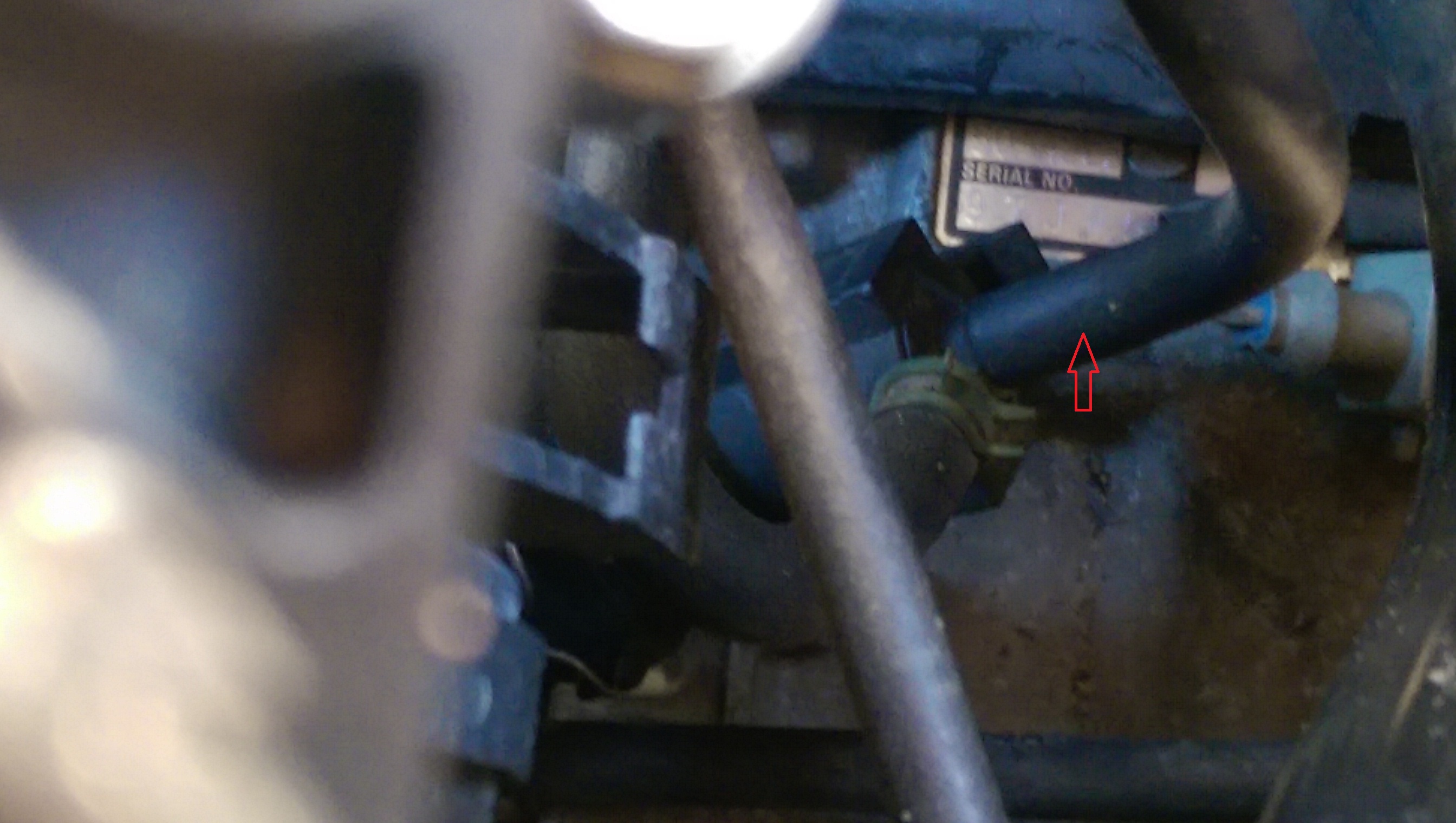

Feel down under the Air cleaner near the Engine/Firewall corner you will find it unless somebody removed it.
Better yet, take the Air cleaner out and open the view.
Photo taken on a '98 C70.

It's there, I replaced the cracked wastegate hose yesterday :D
I gave a quick look, the blue hose is connected and goes deep into the engine bay :?
I'll get the car on ramps and investigate more tomorrow :wink:
