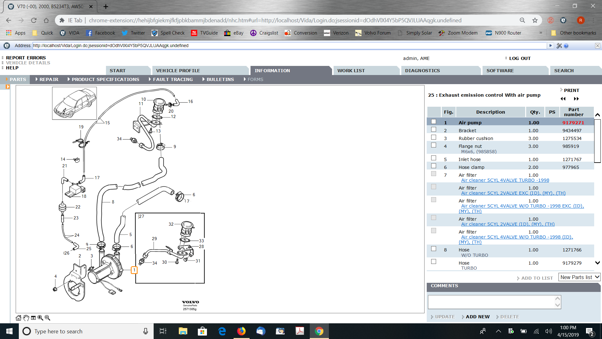

Secondary Air Pump.

jimmy57 wrote: 15 Apr 2019, 12:54 That car wouldn't have the secondary air pump as CVVT effectively replaced it starting with 99 year model.
What am I missing?
Volvo part number 9179271: Secondary Air pump.
Applications:
Volvo C70 Convertible 1998, 1999, 2000, 2001, 2002, 2003, 2004
Volvo C70 Coupe 1998, 1999, 2000, 2001, 2002
Volvo S70 1998, 1999, 2000
Volvo V70 1998, 1999, 2000
Volvo V70 XC 2.4l 5 cylinder Turbo 2000
Volvo V70 XC 2.5l 5 cylinder Turbo 1998, 1999
Active
Past
jimmy57
Posts: 6696
Joined: 12 Nov 2010, 09:25
Location: Ponder Texas
Has thanked: 5 times
Been thanked: 322 times
Post by jimmy57 »
They may put them in somehwere in the world but in US they dropped air pumps with intro of CVVT. The air pump only worked for a minute on cold start to pump air into exhaust to afterburn fuel in the exhaust and it sped up O2 sensor warm up and catalyst warm up. With exhaust CVVT you advance exhaust valve opening several degrees before BDC while combustion is still going and retard ignition timing to start combustion later. These two will cause active flame exiting the opening exhaust valves which will ignite tail end of the gsses of the last exhausted cylinder and assure the unburned fuel that could be there is burned to reduce hydrocarbons. The increased flame in exhaust does the sensor and catalyst heating too. Air pump systems sucked and failed a lot. CVVT is not without issues but is way more reliable than the air pumps.
The 2.9 S80 non turbo for 99-> and the 2000-> 2.4 non turbo 5 cylinder have intake CVVT only (until they went with dual CVVT) and the intake cam is retard together with retarded ignition timing to get a little bit of the same action with no air pump.
