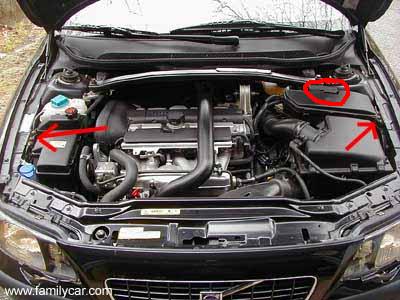

Apply power by means of a booster pack or jumper cables at the jumper terminal in the engine bay at the flap under the + sign behind the fuse box. It is noted by the red circle.
Chassis - can be applied at the arrows or to the engine block. Then use remote or key to operate power locks.
- 2009-11-18_021816_Engine-md.jpg (45.22 KiB) Viewed 3903 times

@ precopster:
Thank you very much. It worked perfectly and I learned something as I never knew that I can actually jump start the car from the bonnet.
I was always connecting the jumper cables to the battery in the boot, which I know is not perfect (nor safe).
