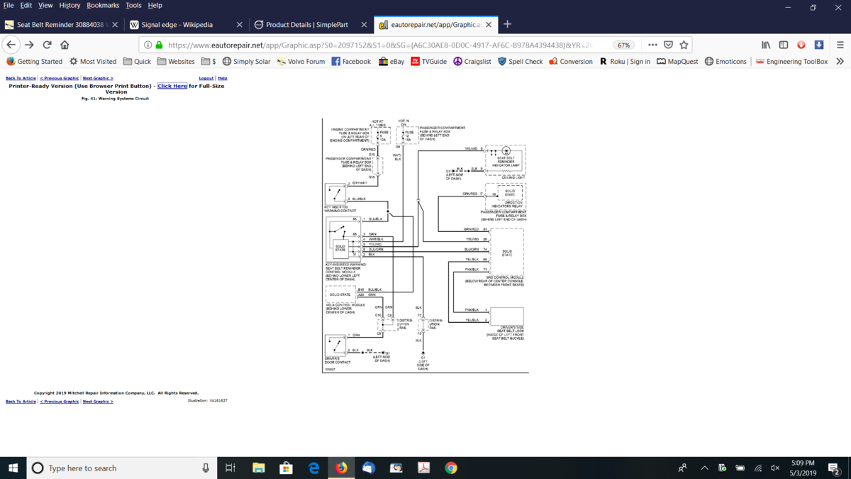

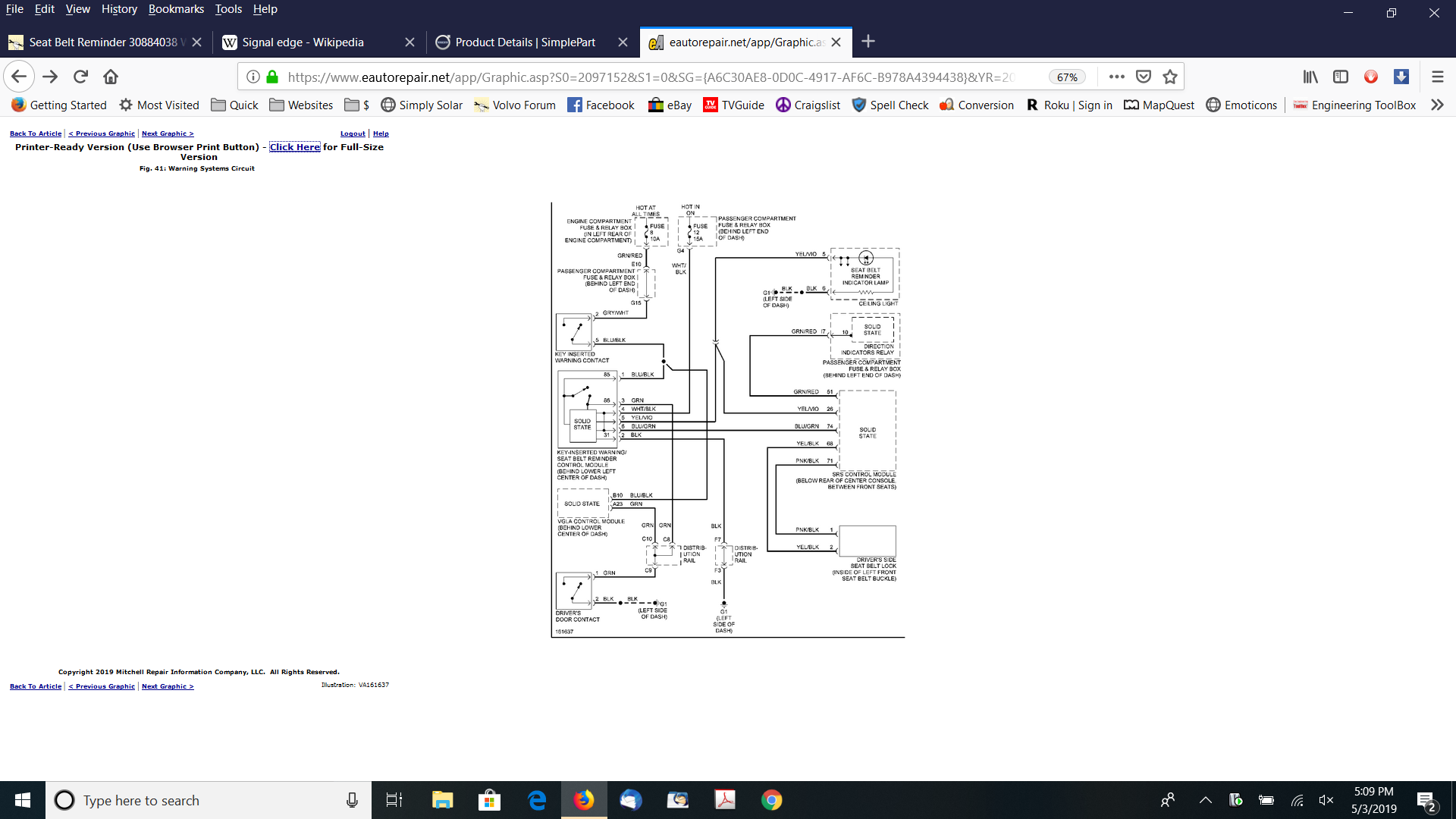

Thanks for the diagram! It's strange that the terminals are labeled 31, 85 & 86 with the other three terminals unlabeled. Looks like I'll be doing a little more fiddling!

Did you notice two of the terminals, 4 & 6, are tied together internally? An Ohmmeter can identify these two.
With just the ground connected 86 will go high whenever +12v is applied to 85.
If you made it this far, there is only one terminal left to identify. Wonder which one it is.
