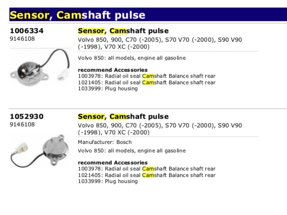

Hy,
Newbie on the phone
It looks like something I met with my first volvo.
Check the fuel filter could also be a nice idea, the ignition, distributor cap...
May be the issue comes from this part ?
Manov
Capture d’écran 2.jpg (62.1 KiB) Viewed 1616 times
