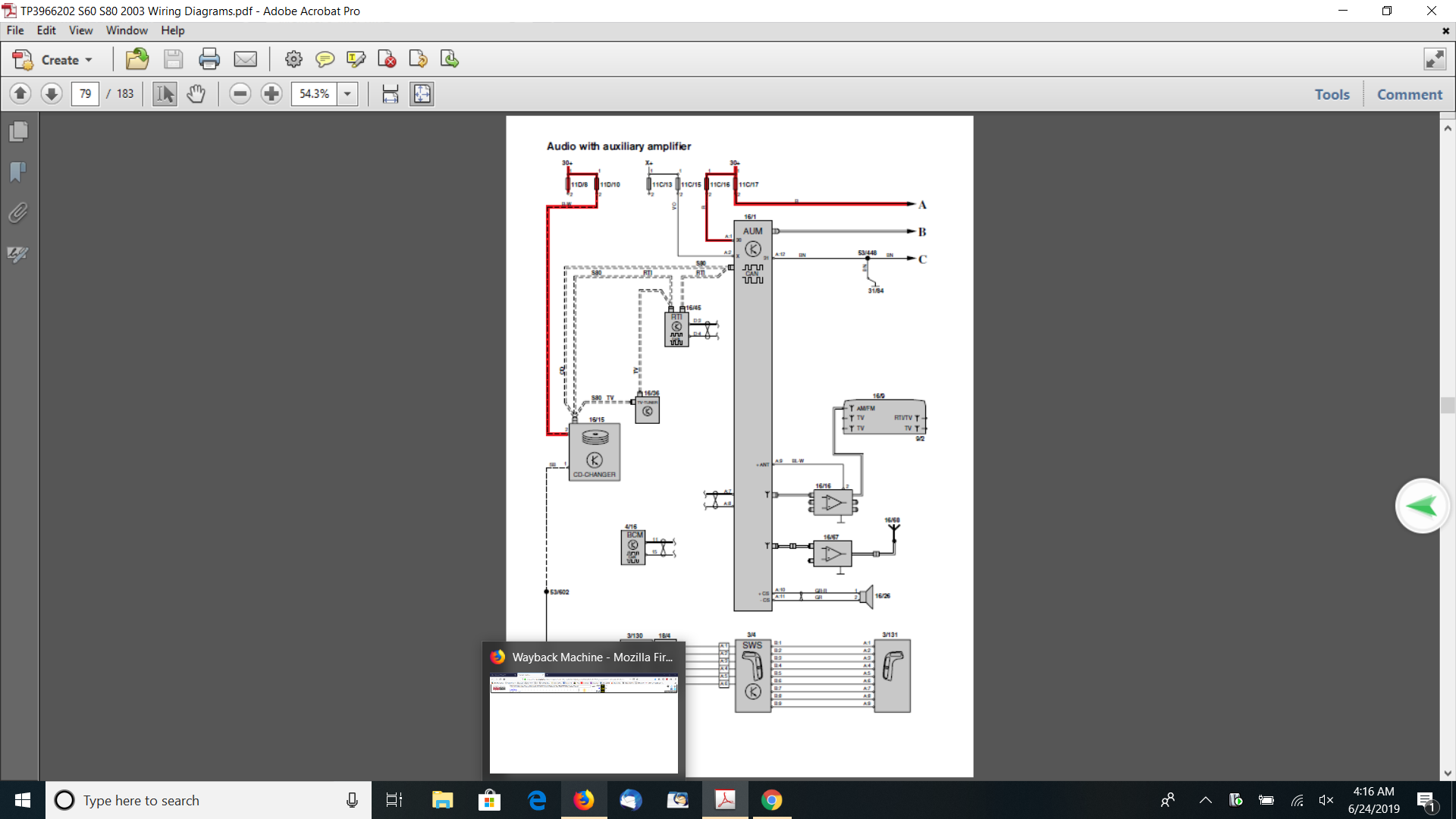

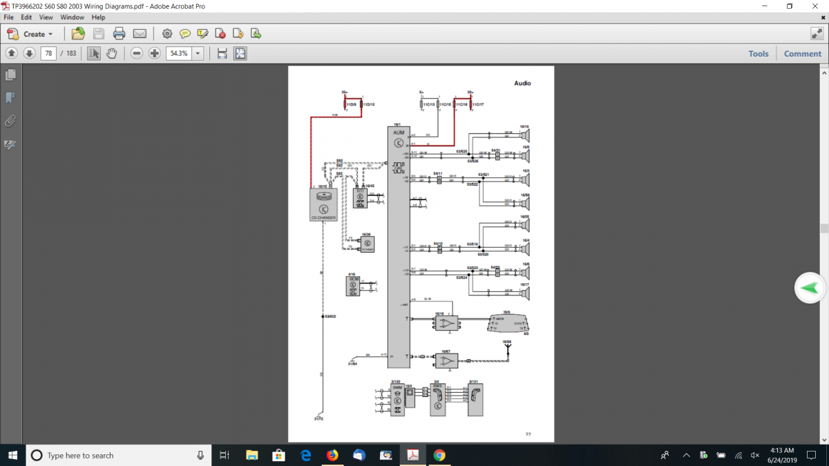

Looks like there are up to four fuses for the Audio system, 11C/15 -17 & 11D/10.
11C fuses are at the end of the dash. 11D fuses are Cargo compartment, most likely for wagons.
Active
Past
Past
Awesome, thanks for the info! 11C/15 was indeed blown. After replacing it I have headunit power...though no audio. The other fuses (including the trunk one) were fine. I will continue to check around. Any further guesses as to the new culprit?
