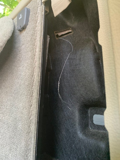

I have the same issue periodically with my 01 T5. There is no emergency release and I got tired of pulling the trim panels off for access to free up the actuator. Once it's freed up it works fine for a while but eventually jams again. I ran a wire from the lock rod (I don't remember exactly how I attached it but I think there was an existing hole to thread it through) through the inner trim panel and into the compartment behind the access panel on the inside. A gentle tug rearward on the wire releases the actuator when it jams and won't unlock.

Thanks. The earlier V70's actually had a manual release back there. I guess Volvo implemented a cost savings starting in 2001. Looks like you just added the manual release back.

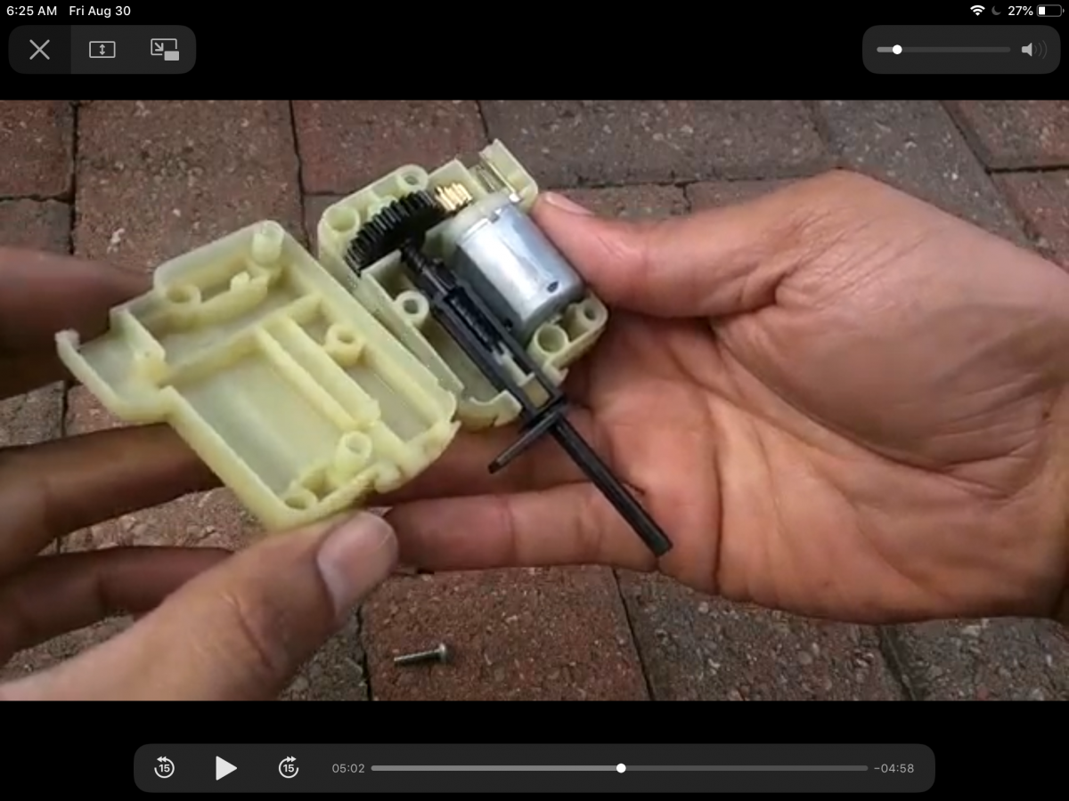

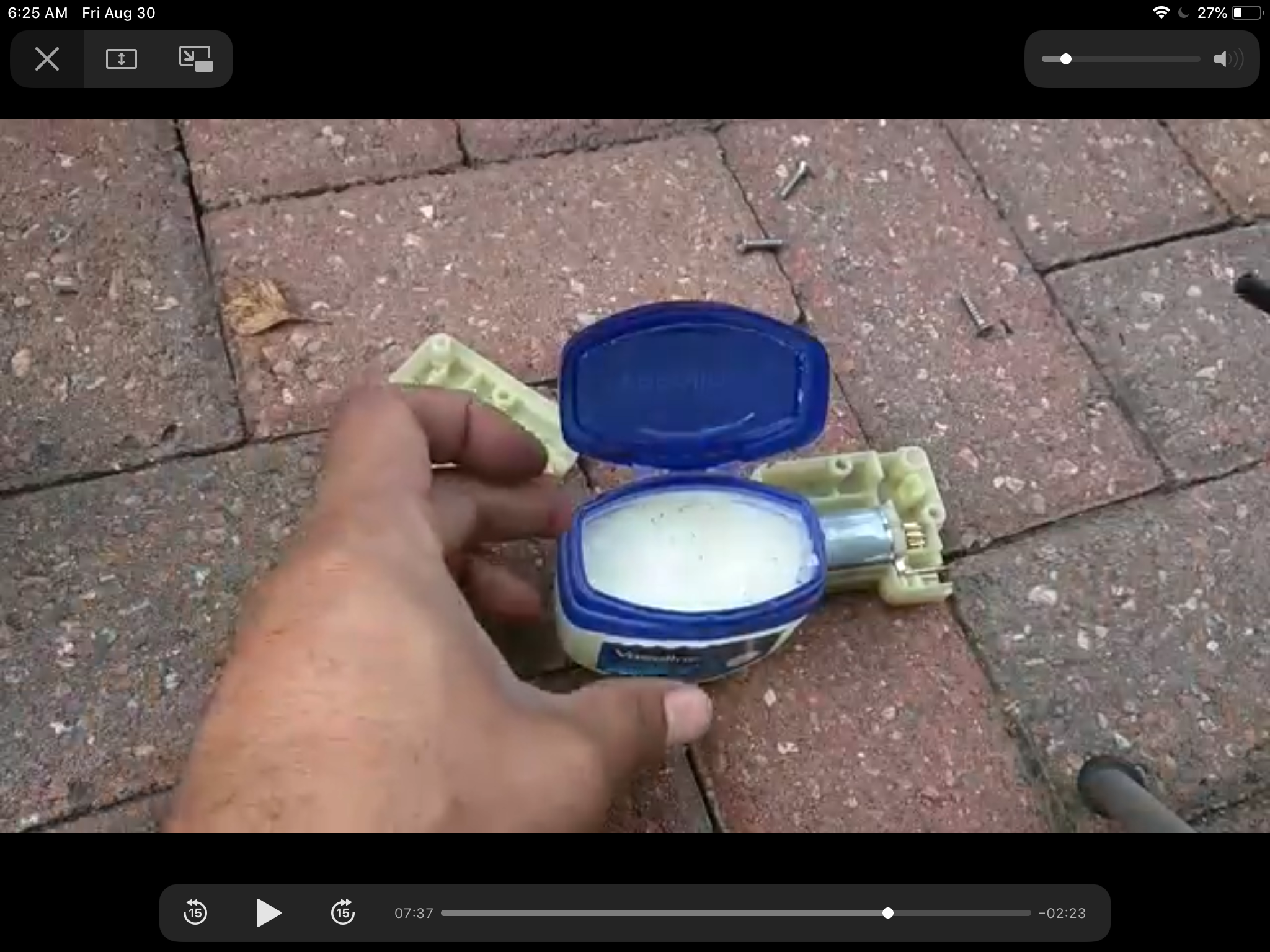

Fuel filler door motor repaired. The most work was disassembling the rear cargo area. 12 volts was getting to the motor when commanded. I disassembled, inspected (no broken gears), then cleaned and lubricated the gears with silicone spray. Once reinstalled, it has functioned properly.
This Youtube video was also very helpful with troubleshooting and repair.

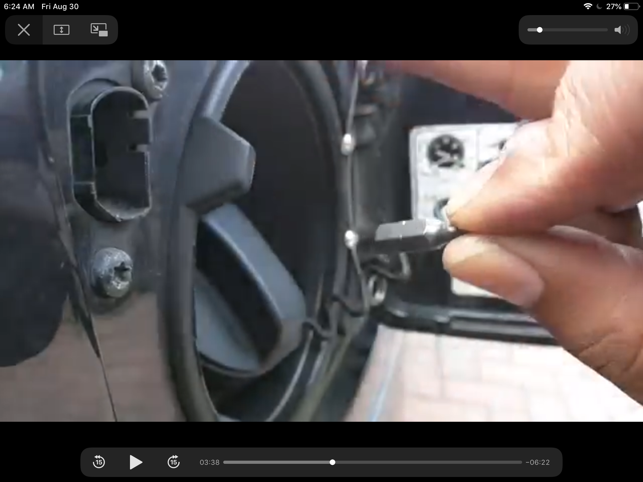

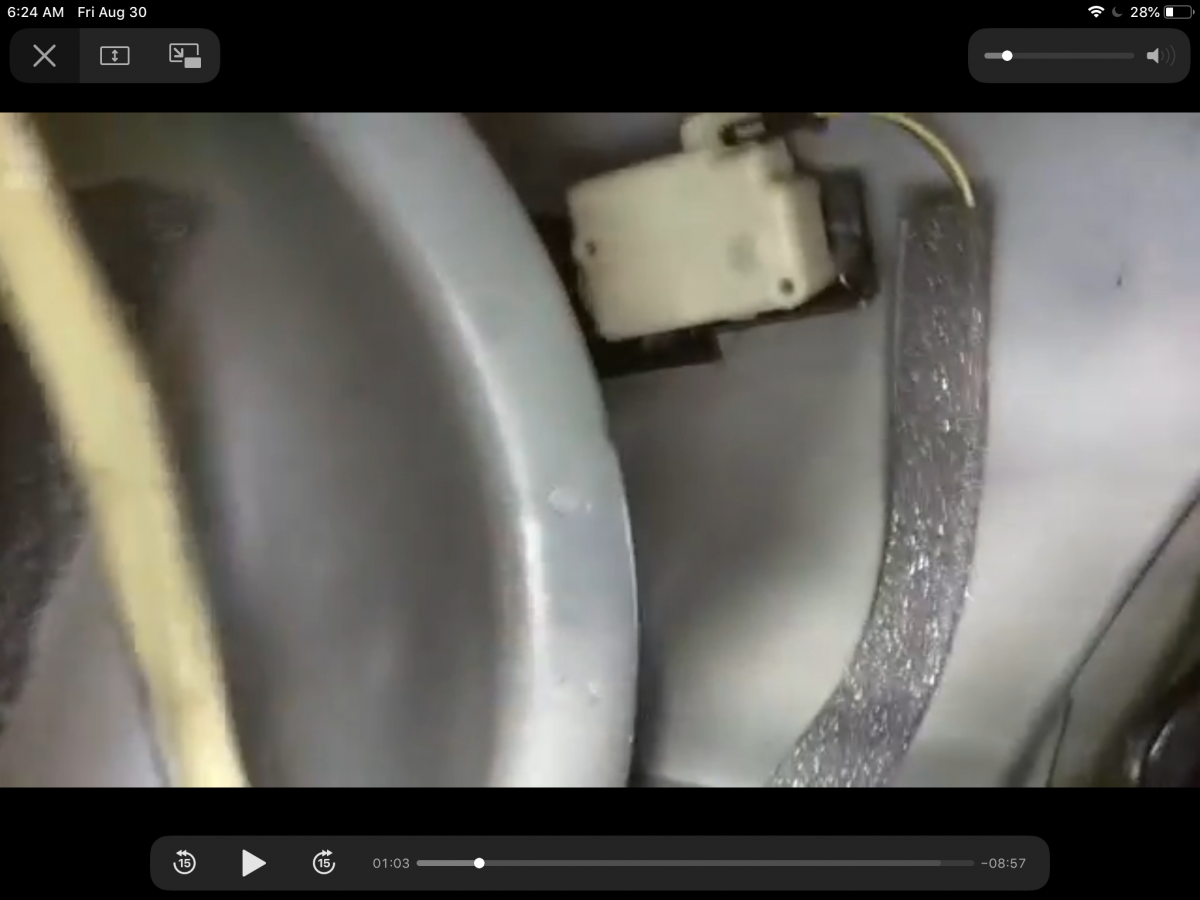

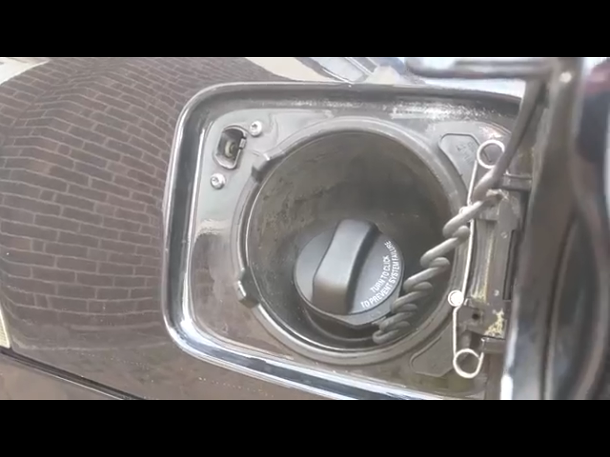

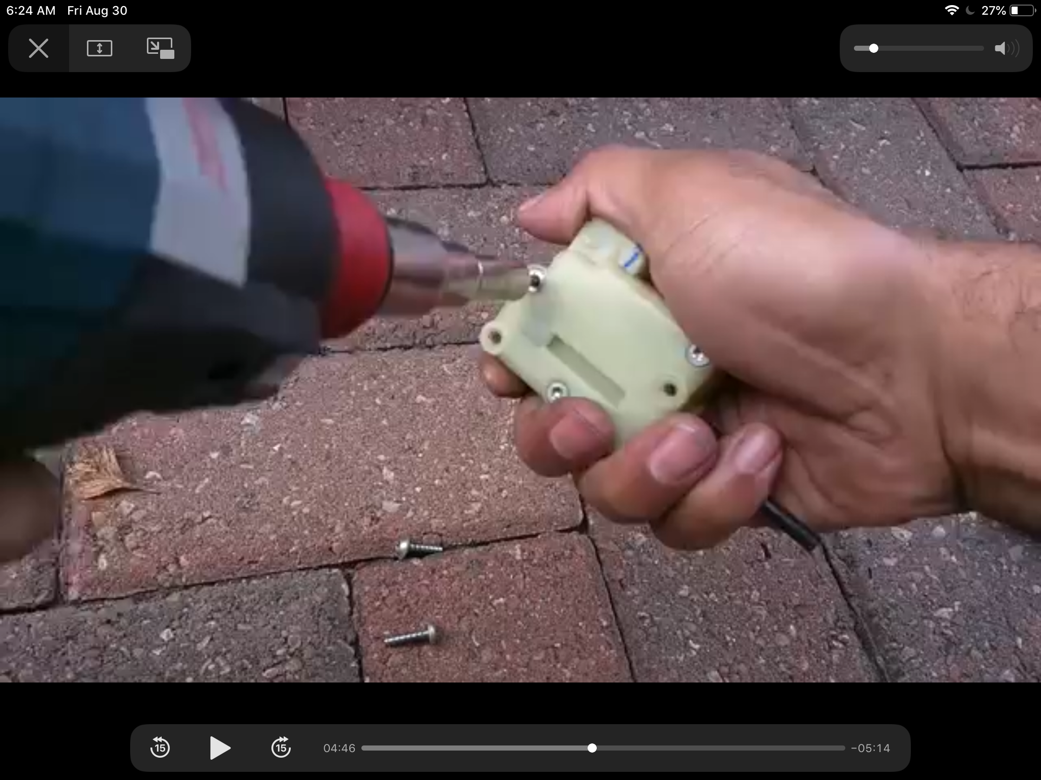

- Posts: 36149
- Been thanked: 4068 times
Screen shots of video with relevant pictures. 10 minutes of your life for 20 seconds of information
Good video but the temptation To add fluff is just too great
Two torx screws release lock inside rear quarter panel , lock motor opens and lubricates as shown
