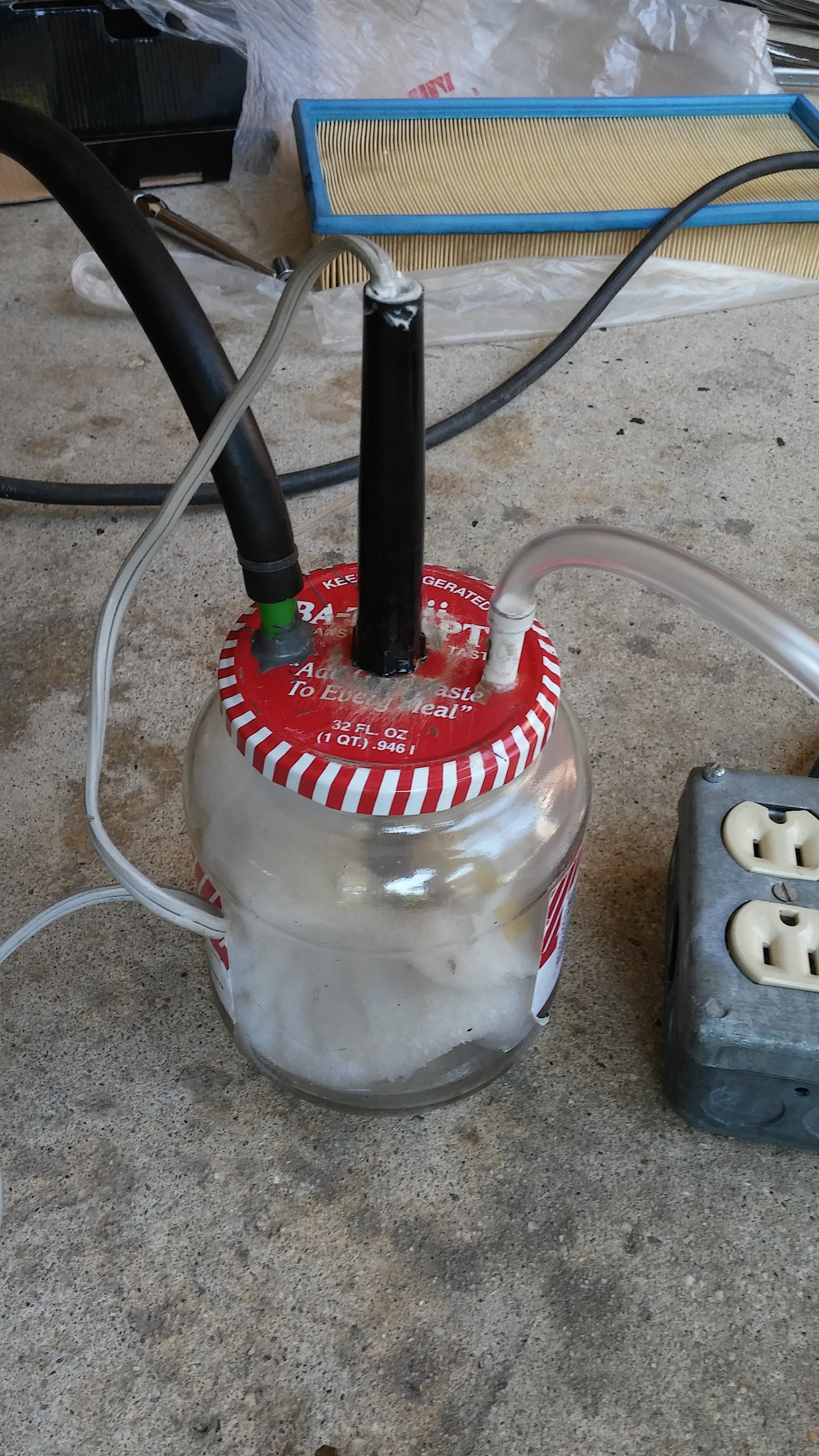

I built a home made smoke machine. It did not show any leaks when run through the center vacuum port on the intake manifold. When I introduced the smoke from the intake pipe after the MAF a small amount was visible near the turbo but I could not see the actual location. Mileage varies by driving type. Mileage has been as high as 30mpg on a long constant highway trip. Local stop and go driving is as low as 18mpg. Engine performance is good. Causes of high LTFT are low fuel pressure (I tested it at 55psi), clogged injectors (running lucas injection cleaner now) a bad MAF (I just exchanged it with one from the PnP), a failing O2 sensor that I have not swapped. There is really no difference as of yet.
I am going to run more smoke tests with the turbo shield removed and see if I can find the source of the wisp of smoke I saw before.

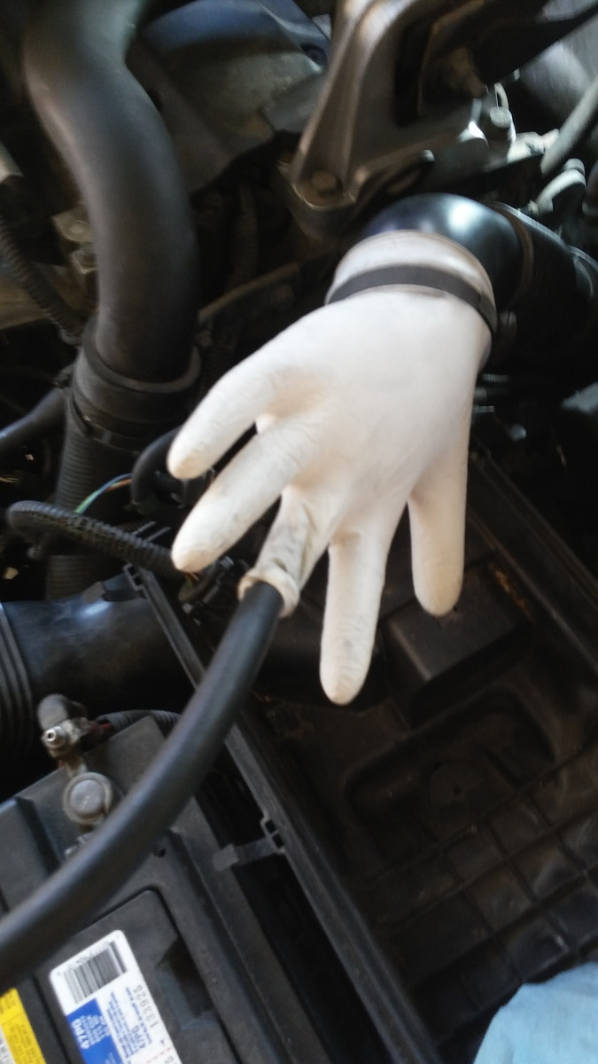

......I ran additional smoke test using my home brew machine. Smoke appeared from the intake pipe down near the PTC valve just after the nipple. As it is a PITA to remove and replace. I tried the propane gas trick to see if when the engine ran it would suck in propane and change the fuel trims. There was no difference. I then used the propane to feed propane around the intake manifold and other intake location. No differenc. I will try the smoke test on my other two 1998 S/V 70-T5. They have the same intake piping. BTW I am making the same trip up to Canada this October. Hopefully I won't need the A/C like the last time. I do NOT expect to get 30MPG again. :-(
Some pictures of the test machine. I have a mp4 video but don't see how I can upload it.
interface to the down pipe
smoke machine
smoke machine
