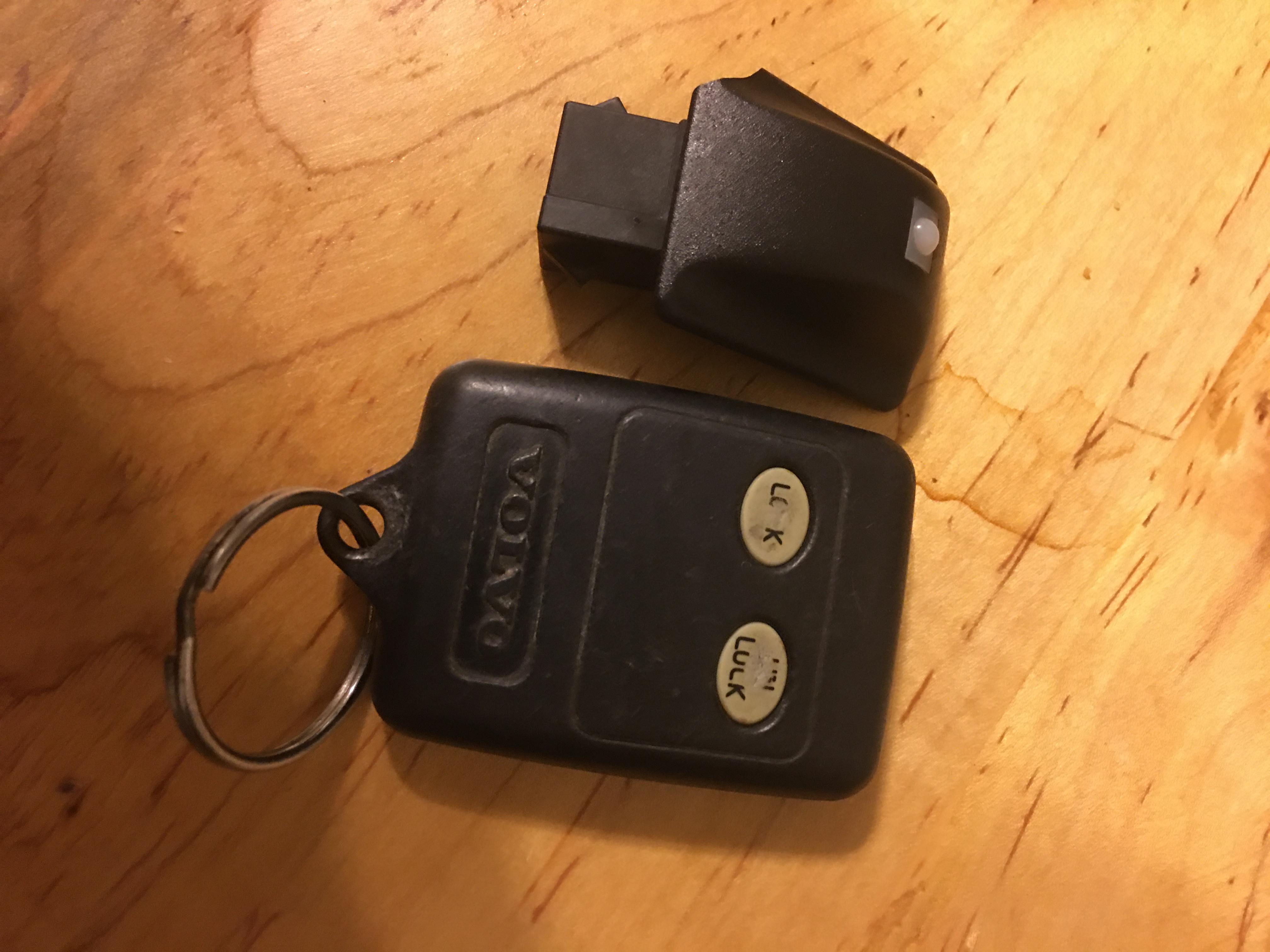

Stumbled across a rare opportunity today at Harry’s U Pull It in Allentown, PA - a 95 850 sedan with remote unlock with the OEM fob and the sensor unit still in the car. Bought both of them and was hoping to use in my 96.
I watched RSPI’s video about locating the sending unit. I pulled my glovebox and it’s not in the same place, but I know he was showing a 95.

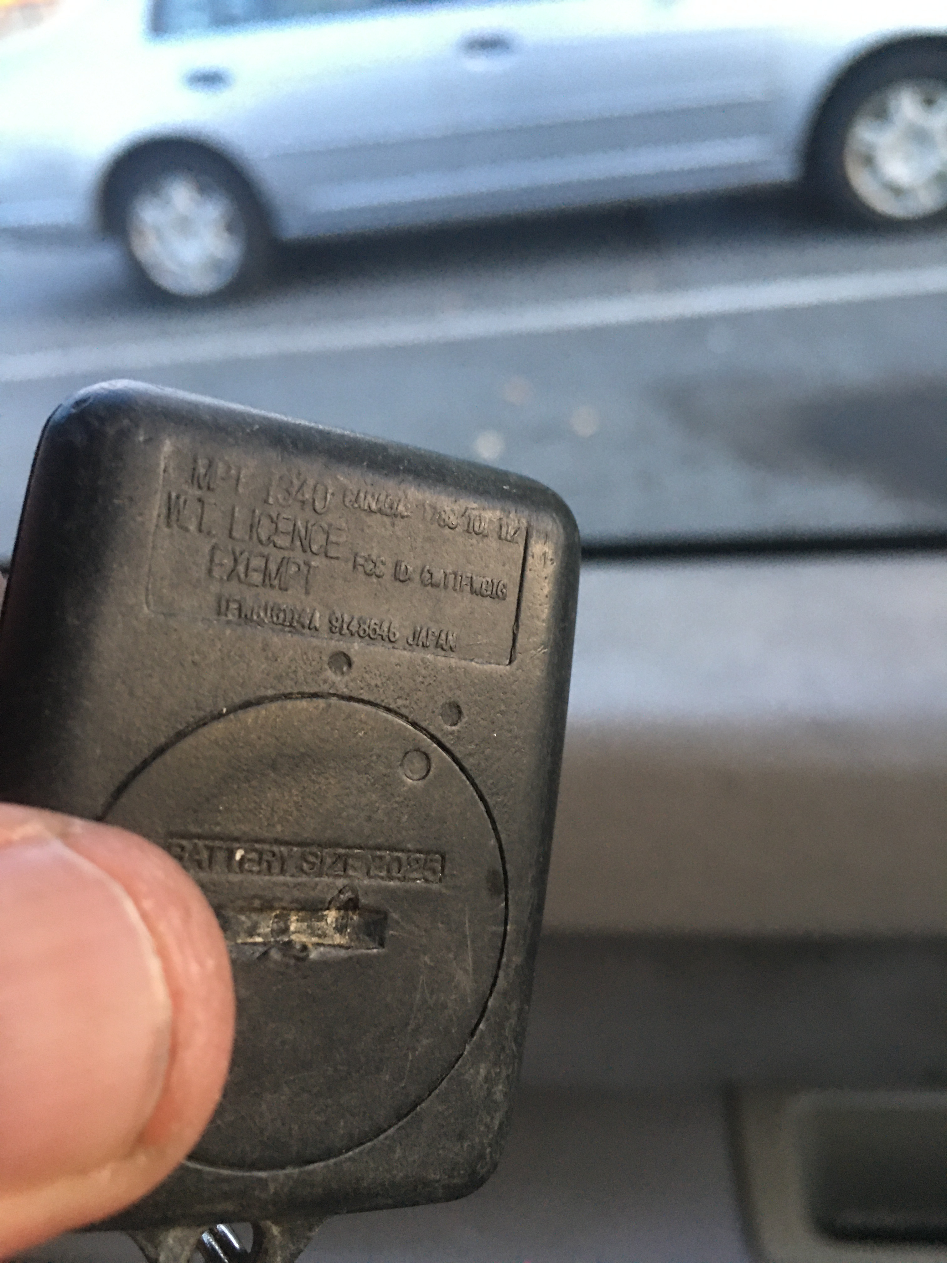

I cleaned up the fob and bought a new battery. I am not against hooking the sending unit up to the top of the dashboard and trying to program it, but I don’t know where to find the FCC ID on the receiver in a 96.
Assuming I am close, but in the instance where the fob, receiver and antenna will not “talk” am I compromising my car somehow? Like it will lock me out, kill the fuel pump or send my horn honking until a Volvo mobile tech crew show up and demand $$$ to reset my system?
I’m attaching pics of the back of the fob and the antenna part that goes in the top of the dash by the windshield. My car was made in September 95 for the 96 model year, so it’s a fairly “early” 96 I suppose one might say. Hoping I can get this working, it would be a nice find and very low cost addition.

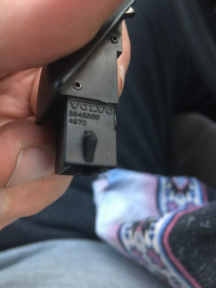

That's not an antenna or any part of the fob receiver.
It's just a status LED for the alarm and a solar sensor
for the ECC.
