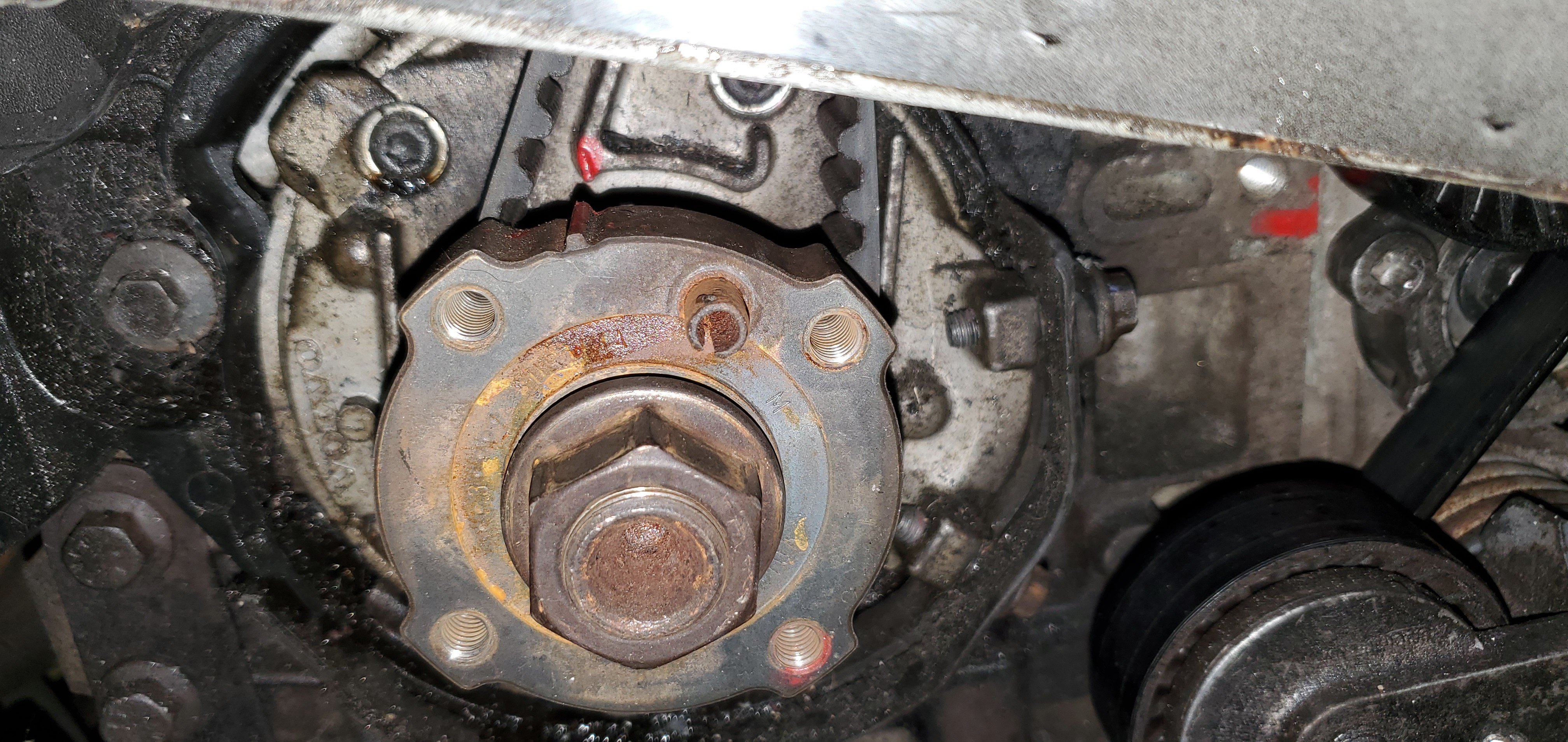

One more question, now is about the crankshaft pulley.
I took the pulley out of the crankshaft and need help to put it back.
Is the crankshaft have any mark to reinsert the crankshaft pulley??
I can see in the pulley the marks, and also the line where is a little wider inside the pulley.
But I need a mark on the crankshaft to install the pulley. Any help appreciate it.
Thanks

Post by RickHaleParker »
The wider spine is an alignment key. There is only one so there is only one alignment that will let the two pieces go together.
The tool in the center of the kit above is the Crankshaft Alignment Tool. It is used to lock the camshaft in the correct position for timing alignment, the datum for everything else.

Two questions please about the crankshaft alignment tool. How do I put it in? Shel I turn the crank till I feel a click?? Is it there is only one hole to insert it in?
And, is the pulley goes only in one position or when the crank is in position I should synchronize with the red line (in my pic)
Thank you
tango_1000 wrote: 24 Oct 2019, 09:38 Two questions please about the crankshaft alignment tool. How do I put it in? Shel I turn the crank till I feel a click?? Is it there is only one hole to insert it in?
In the picture the crankshaft is aligned. Just make sure you are looking straight on.
One round hole for the alignment pin. There is a recess in the block for the key on the side of the tool.
To install the crankshaft alignment/locking tool.
1. Move the crankshaft to the position in your picture.
2. Remove Starter.
3. Remove plug on block.
4 Insert Crankshaft alignment tool.
5 Turn crankshaft a little bit clockwise until the Crankshaft alignment tool goes in all the way. May sure the key goes in the recess .
6. Turn Crankshaft counterclockwise as far as you can. The two marks in the picture will be perfectly aligned.
Done

Post by tango_1000 »
Sorry, this was an old picture, maybe a day or two old, the crank pulley is now off the crankshaft.
So I need to reinsert the crankshaft pulley. But in any case, before I took it apart I did put the red line with the red mark, so I guess I'm very near. Can I go around this point back and forth until the key goes in the recess?
Then when find I will be sure to insert the pulley right in the marks.
Thank you so much for your time and help.
