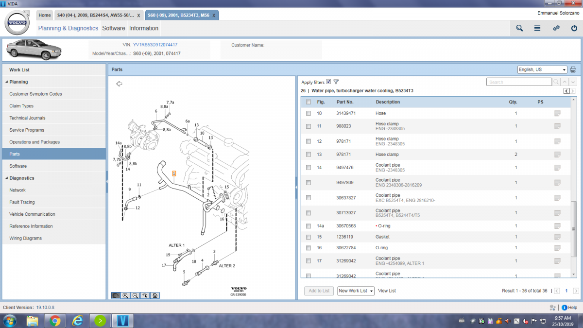

Called Volvo this morning and they sent me the following diagram.
Looks like there's only 3 hoses with coolant on the drivers side of the engine #12 #20 & #21
#12 - Looks like the lower Radiator Hose (Possible culprit)
#20 - Looks like the upper heater core Hose (Possible culprit)
#21 - Looks like the lower heater core Hose
I didn't know which part to get so I got all 3 from Volvo, knowing I could return them if I did not install one of them.
#20 Hose seems like it plugs directly into the nipple of the engine block
However I have no clue where #21 routes too and its not clear to see unless I start really digging through my engine bay.
Are there any hoses which I have not mentioned that could be the culprit and I should change for preventative maintenance?

On a turbo car there are several small hoses, in nasty places that link hard pipes to the turbo - one on passenger side, one on driver side, and two more that cool the oil cooler on the rear (or RHS) of the engine.
You need the diagram for the turbo and oil system to see all these in VIDA

I was also given this diagram from Volvo. Are any of these the small hoses which you were referring to? Which ones of these would you suggest I replace?
This vehicle has been meticulously maintained but to the best of my knowledge all hoses are still original therefore whichever could be the culprit I will go ahead and replace.

Replace 9 and 10 and don't even think of using URO hoses there, Volvo only.
You also have two hoses that feed the oil cooler not shown.
