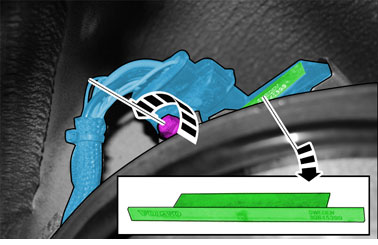

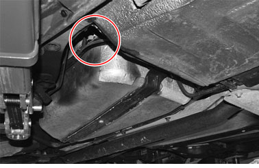

They live either on top of the gas tank on the passenger side or in the trunk area. 2001 is an early P2 so make sure it has a PEM first! Volvo web store can help with system diagrams and pictures

Guys, I’m dying. I have looked in the spare tire area. No pem. I looked under the seat. No pem. I am digging around on top of the gas tank on the passenger side. Even loosened and lowered the tank to get my hand up in there. I cannot find the pem. I know it will fix it and I have the part. Just can’t find the thing!

Wait for jimmy to chime in , I think some 2001 fuel delivery were non PEM systems

As above, no PEM and no FPS on 01-02 as discussed on forums
What is the actual issue ? It won't start ?
