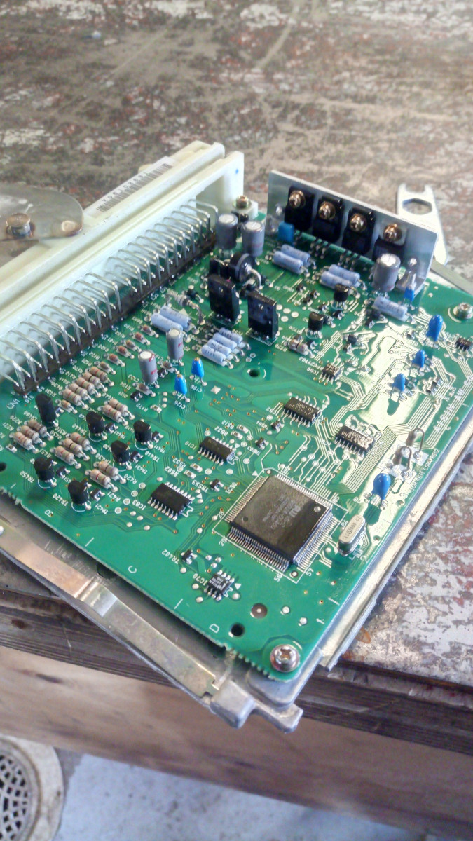

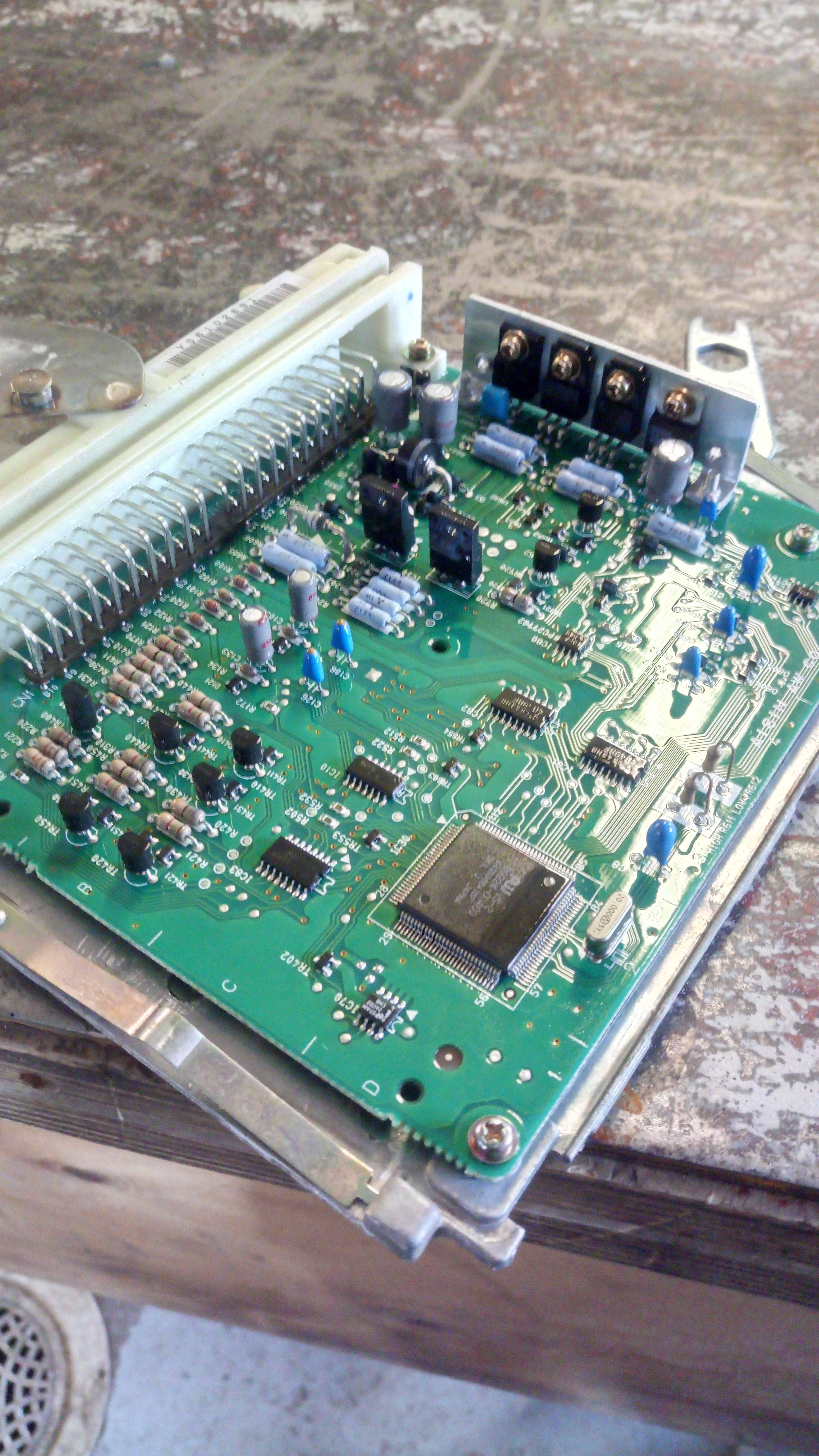

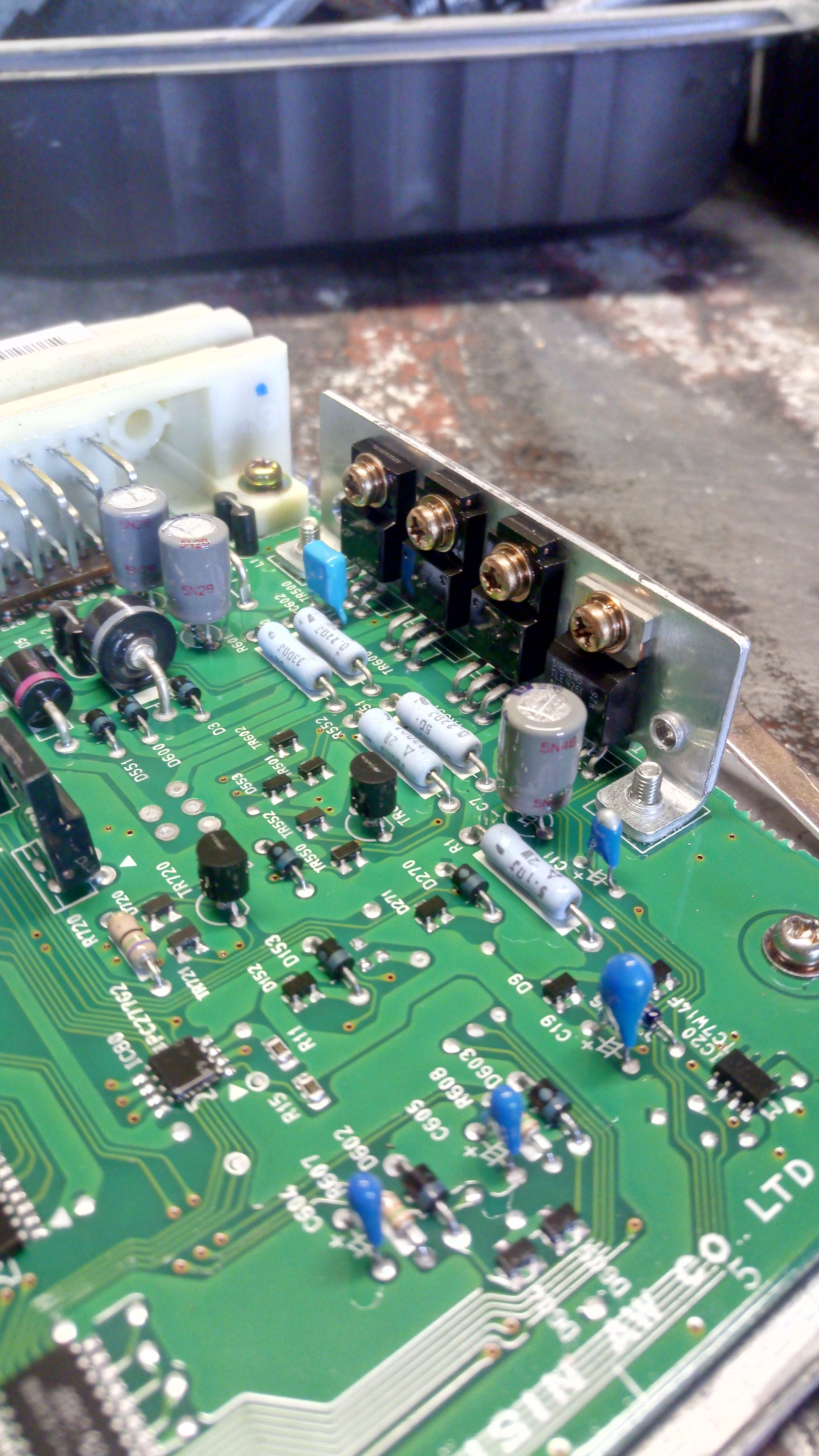

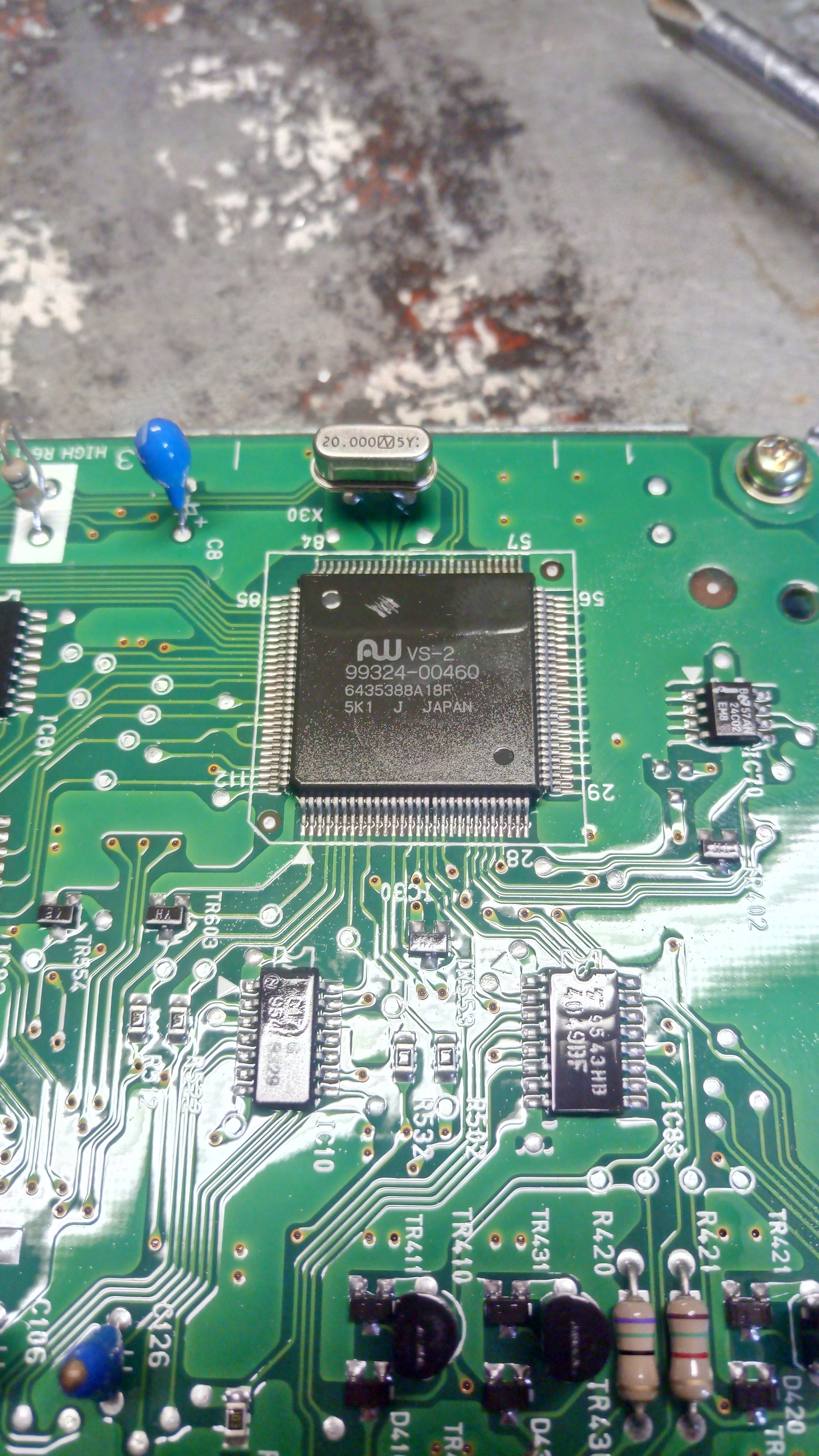

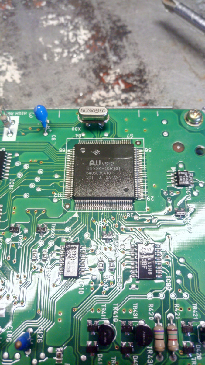

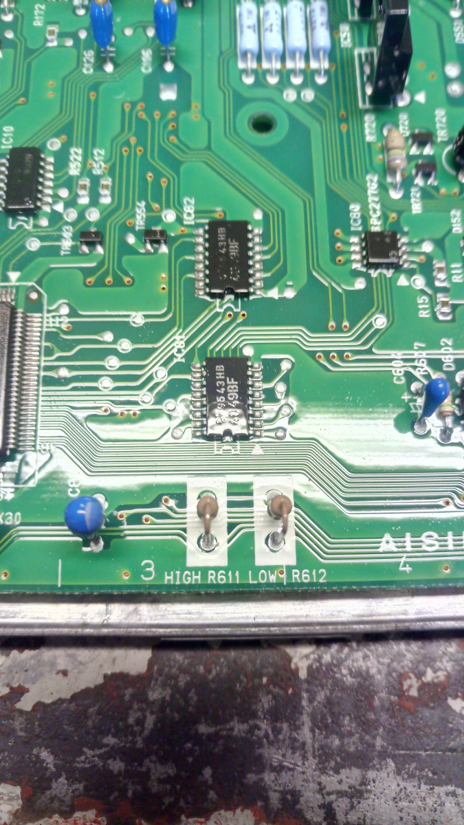

I wanted to do the pot mod to get faster shifts and less clutch slippage (mine doesnt slip but gets longer life when it grips harder) but mine does not have the famous big resistors that you swap for a pot where they should be on tutorials and on the other side of the board there are another pair of big resistors but they arent same value as the tutorial.
So my questions are:
1. Is there difference in NA and T5 TCMs. Like would the NA one rev higher before it shifts?
2. Difference in 850s vs early x70s before 1999 TCUs.
3. I know theres different TCM boards in 850 turbos but is one "better" in any way and wich ones are direct swap?
I attatched some pictures from the inside of my 1996 T5 TCM if anyone is intrested. :roll:
