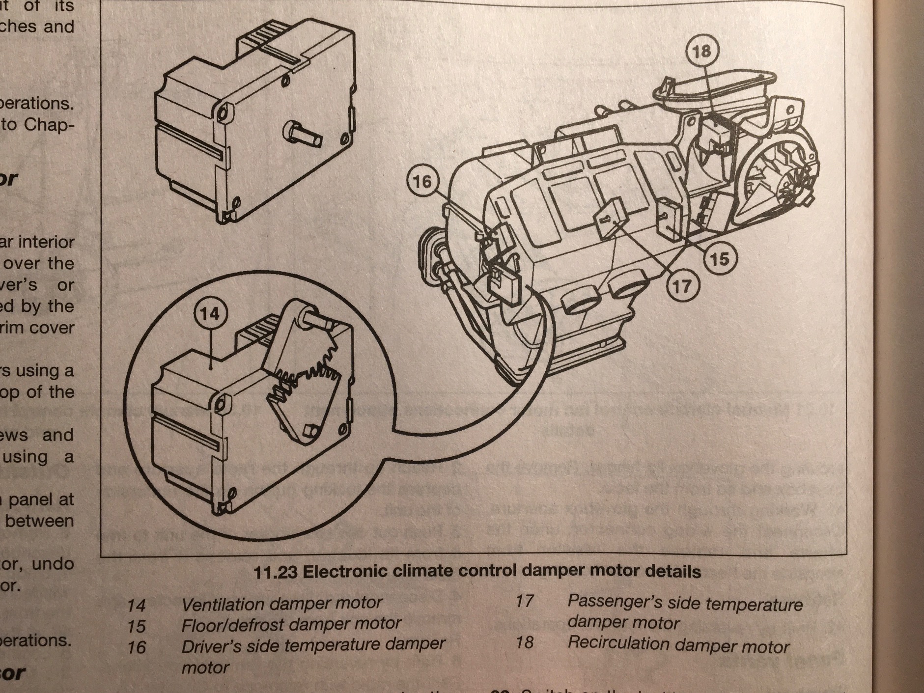

It might be helpful to remove the damper motor for the heater/vent/defrost control flap and see if it's working correctly.

At least on my '97 855, you have to remove the panel underneath the dash to get access to some of them, such as the recirculation damper and the vent direction controls (face or footwell). On the V70, I don't know which damper motor controls the heater/vent/defrost function.

This image is from the Haynes 850 manual, showing the locations of the damper motors. I checked my copy of the Haynes V70 manual and found that there is no similar image. Hopefully this one will help you home in on the location of the damper that may be giving you trouble.
Thanks, it will be warmer this week (didn’t want to break anything) and I’ve watched a video on the removal. If I test with the dash off, I’ll probably get a SRS light. Is there enough wire that I can keep it plugged in? Otherwise all I will be able to do is make sure the flap move. Or use a 9v battery to test the motor?
