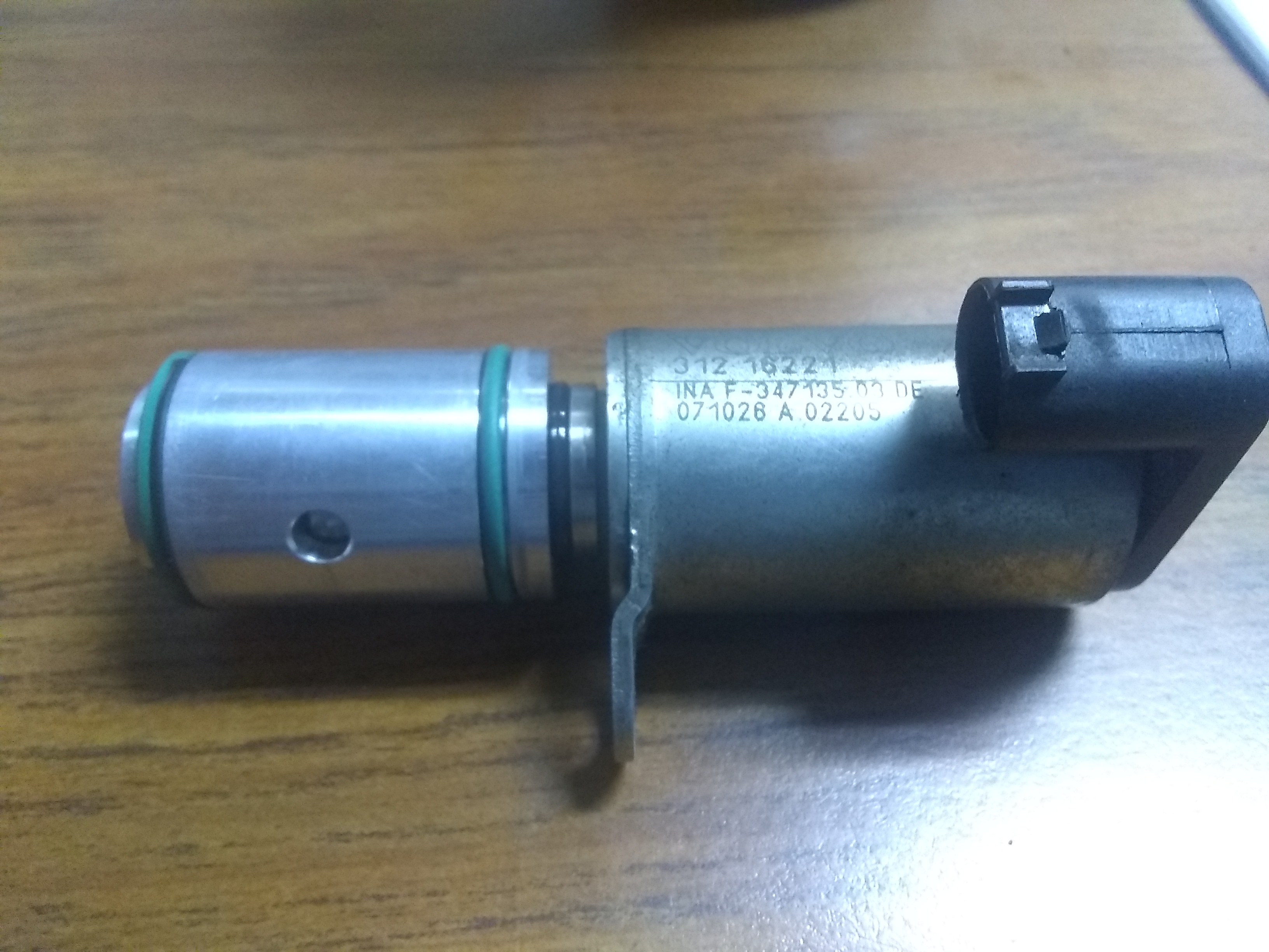

I'm in process of going back together after reworking the head from a timing belt jumping time.
I noticed it was sticking out from the cam cover an it looked suspicious to me.
2008 Volvo S40 2.4L non turbo

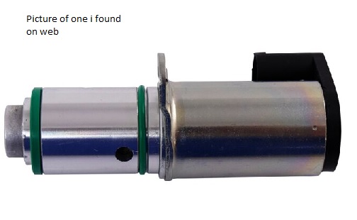

My question is concerning my V.V.T. solenoid . Is It Bad it seems to be extended out way to far
Or do I need to plug the connector on it and power it up to retract it ?
I attached a picture of mine and one I found on web.
Any info would be appreciated greatly.
Wes

I opted to replace the VVT solenoid with new one.
The baby started right up and is running smoothly.
Thanks Wes
