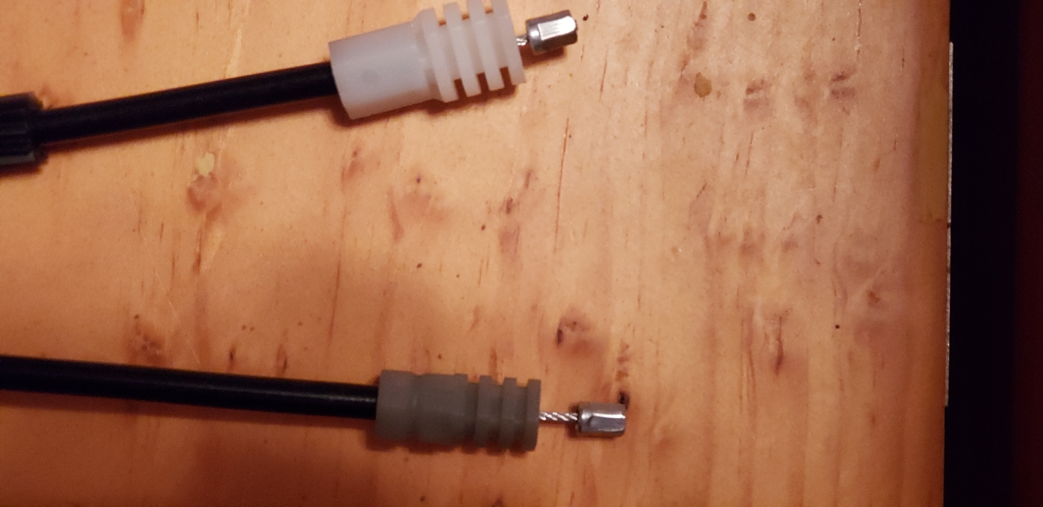

I was beginning to think no one saw my post! Thanks for responding. This is a pic of the kit I bought, looks right? I am waiting on the 3 rubber hexagon screw/nuts before I finish taking it apart, I broke one the last time I had this apart.

Not too many have done the cable type regulators. The first generation C70 is the only one that has the cable type. The one you have is correct.
You want the rubber motor mounts. The motor has enough torque to bend the sheet metal.
