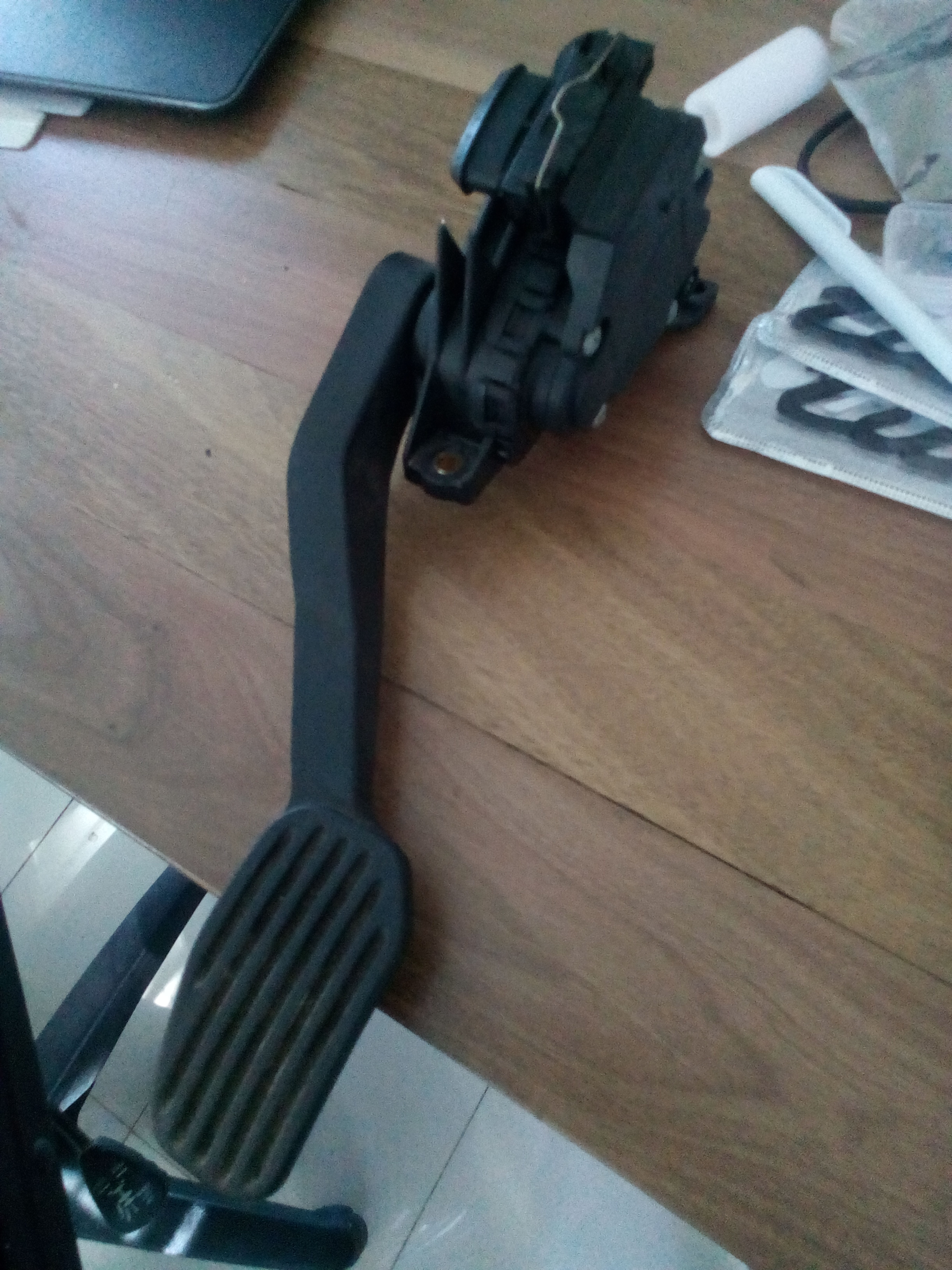

I have a spare gas pedal from my auto (brushless) but its different to the manual (brushed) (wires are same colours)

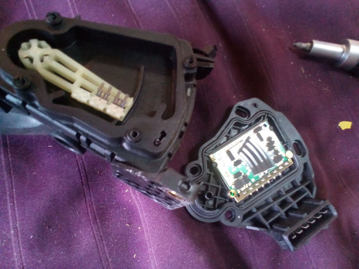

Ive given the brushes and tracks a noticable cleaning but problem remains

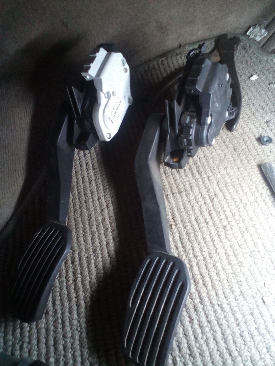

havent test driven the car yet but swapped pedals and car appears to idle better and engine seems to respond better.

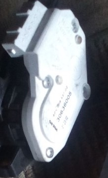

Brushless pedal has this written on it 30606006, 6PV 00853702. brushed pedal 9157553.
note this is a RHD vehicle, it appears there maybe LHD RHD variations

Just back from a short test drive and can report a noticeable improvement in idle, i have an IPD poly upper mount so i can feel everything, i can shuffle forward and back without stalling. Not sure what years got this brush contact pedal but worth a look at if your vehicle is playing up.

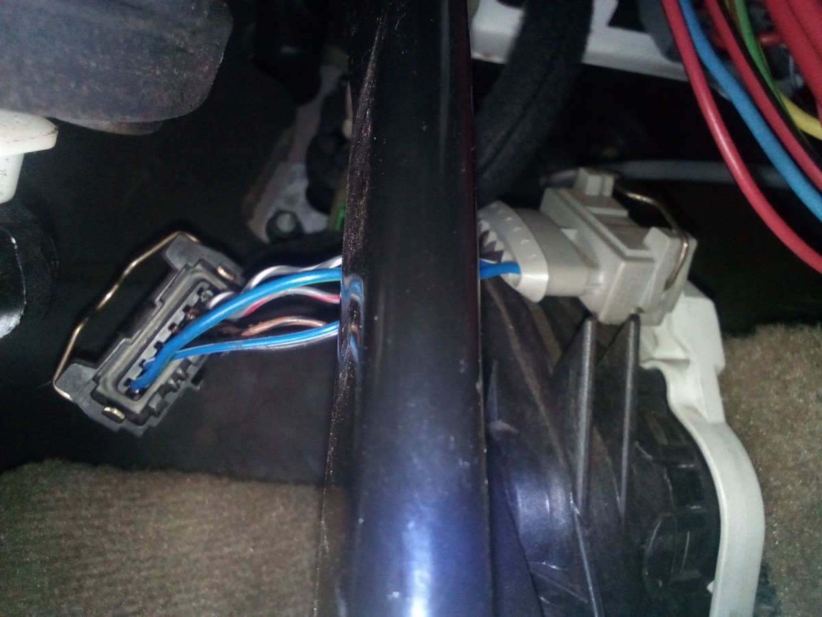

Note the connector is needed for changeover
