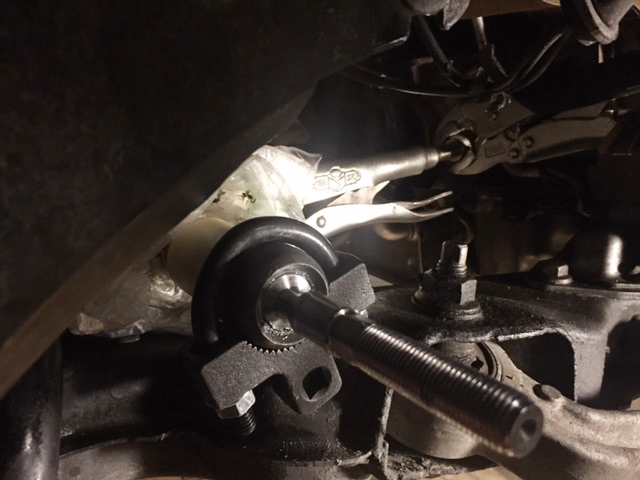

I have to admit I don't understand what is going on in that picture. One pair of locking pliers seems to be secured to the adjustment knob of the other pair of locking pliers? Am I seeing that correctly? If so I don't know how that helps or what it does. :-)

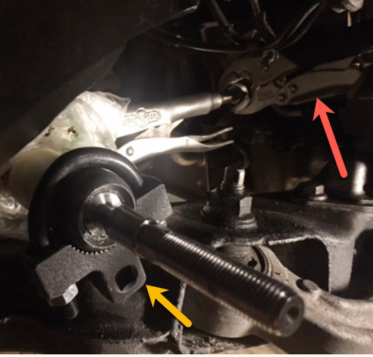

I understand what is going on now.
In the below picture, the yellow arrow points to a hole on a special tool for a ratchet.
That special tool is just a clamp around the tie rod and the hole is for a ratchet used for for unscrewing the tie rod.
The red arrow points in the direction you'd apply force to the locking pliers #2. That would tighten the adjustment screw on the pliers #1 attached to tie rod. Because the direction of force would tighten the adjustment knob, it would also hold the pliers #1 steady and help counteract the force applied through loosening tool (yellow arrow).
I suspect there are two sets of locking pliers in the mix just because of the cramped space and using 2 pliers allowed for a more convenient method of holding things properly.
I have to say, I haven't see that type of tool before (yellow arrow). Very cool.
