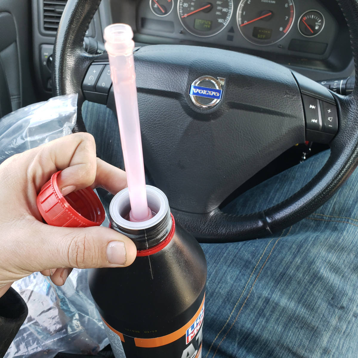

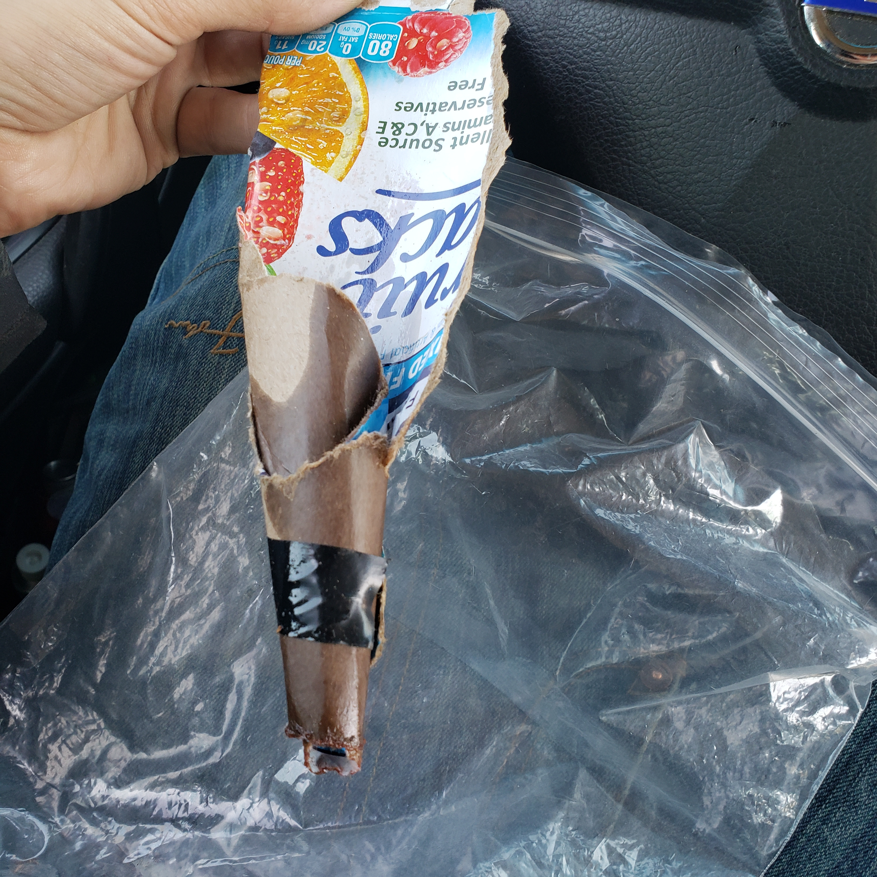

I suspect my fluid was low from changing the radiator. I ended up ordering this to the shop, Just one bottle. 13.69$ couldn't belive it. Its full synthetic, will that mess with the non synthetic fluid already in there? I'd imagine there compatible. But I topped it off. The bottle came with this cool hose that comes out. But I took pictures of the specs. And it says specs and approval List blah blah. Then below saying we also recommend this for blah blah jws3309. So i take it, its not approved for jws3309... But will it be safe? I had a hella time finding jws3309. But Yes I plan on doing a flush, or several drain and fills. Probably the latter. I will check the fluid you used. I'm also hearing people say Jws 3309 is the same as t-iv. But ya this oil seems quality. But to expensive if I have to buy like 12 qts for d&f. Do u guys like my funnel lmao! Hopefully no particals got into it from the ripped cardbored. I should of just used some vice grips with a rag between on the plastic hose, then fit the hose thats comes out the bottle into the fill port and then unclamped the vicegrips. I wasn't home so I didn't have access to much. Best bet probably would of been to attach a hose to it, which would be super easy cause it has like a barb type end on it. Is there a filter in these transmissions?

A lot of people have used Valvoline MaxLife in the red gallon jug from Wal-mart with great success. A lot of people use Toyota T-IV (T-4). And a lot of people use other ATF that “meets the requirements”. Toyota T-IV is typically around $6/qt at a Toyota dealership. MaxLife is around $17-19/gallon.
I think for a temporary top-off you’ll be ok. Me personally, I would never spend $11-13/qt of ATF for any reason. But I do drain/fills every other/every 3rd engine oil change. I think that running less expensive ATF & changing it much more frequently is a better route to take on these cars.
There is a filter but it is so buried inside the trans you’d need to remove the transmission entirely and then dismantle it just to get to the filter. That is a big part of the reasoning behind changing your atf out so frequently via drain & fills.
Good job on the funnel!

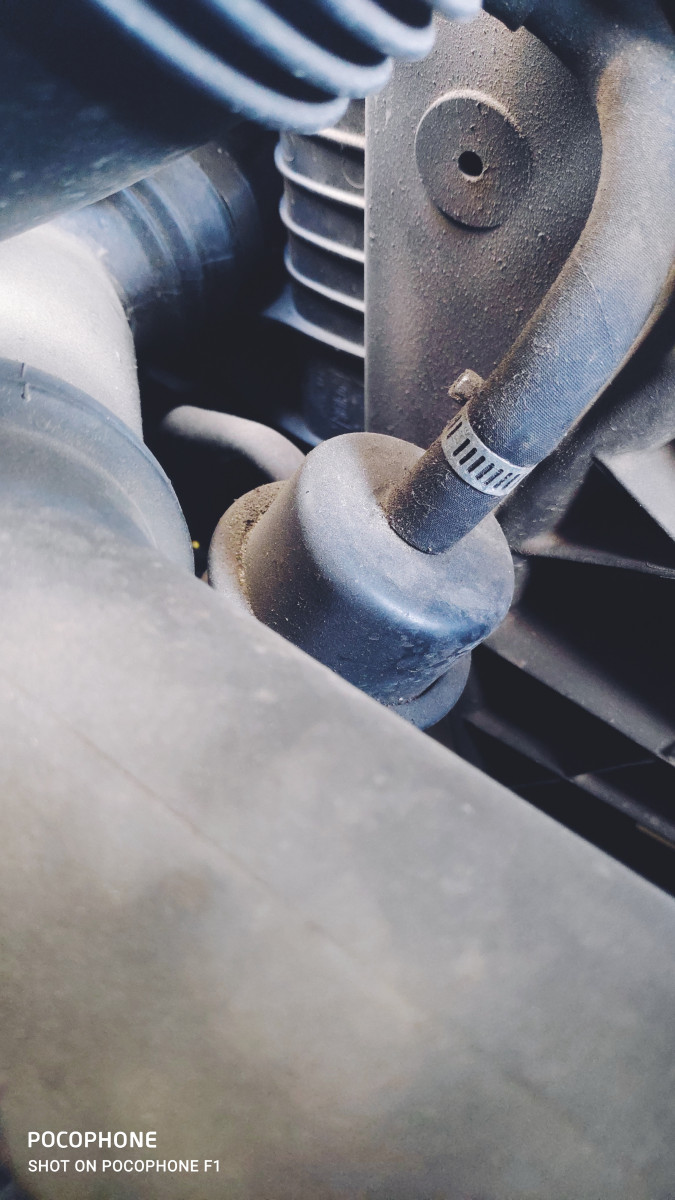

I can vouch for the Valvoline ATF as a flush medium. I've used it a number of times and I think its done a great job. I've been using the Aisin AFW+ on the recommendation from Aisin themselves.
Haven't had any issues with it, but haven't noticed any improvements either. I also added an ATF oil filter outside the gearbox, on the return oil line back to the gearbox. The filter itself is cheap and to fit it you need to cut out an appropriate length of the hose to fit the filter. Why Volvo decided to not have an external filter beats me. Does anyone know?

Careful with the funnel. Perhaps it will disintegrate in the trans but wouldn't want to take chance.
