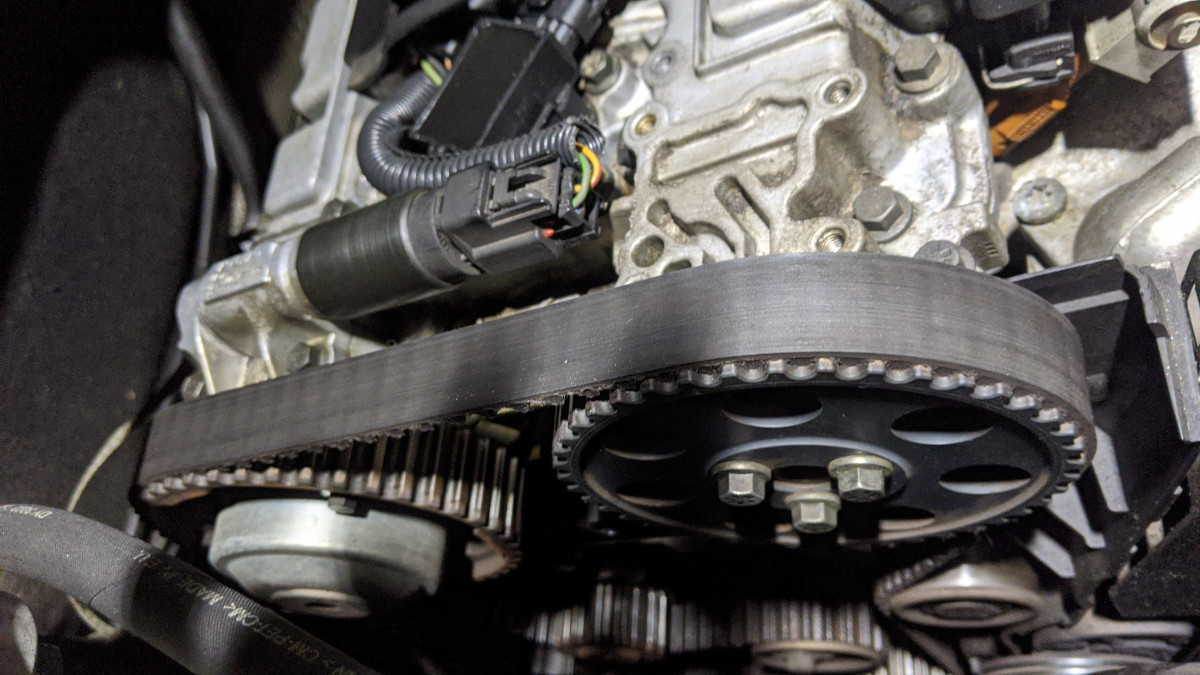

Was wondering how can I be certain if this 2nd hand vehicle I purchased has ever had a timing belt service done ? I've become more and more suspicious it has Not, to be honest. I've just parked it in the garage until I can find out more. Luckily I have another vehicle to drive. The car has 159 000 Miles so normally it would be almost due for the 2nd service but I fear it never had it's 1st either.
If I took some photos can you guys can help me make a clear conclusion. Hopefully I'm wrong but I don't think so. I'm not sure if I will do this myself or try to find an experienced Volvo Mechanic in the Seattle area, who has reasonable rates. Will be adding photos soon as I get home. Thanks in advance to everyone for the help and advice

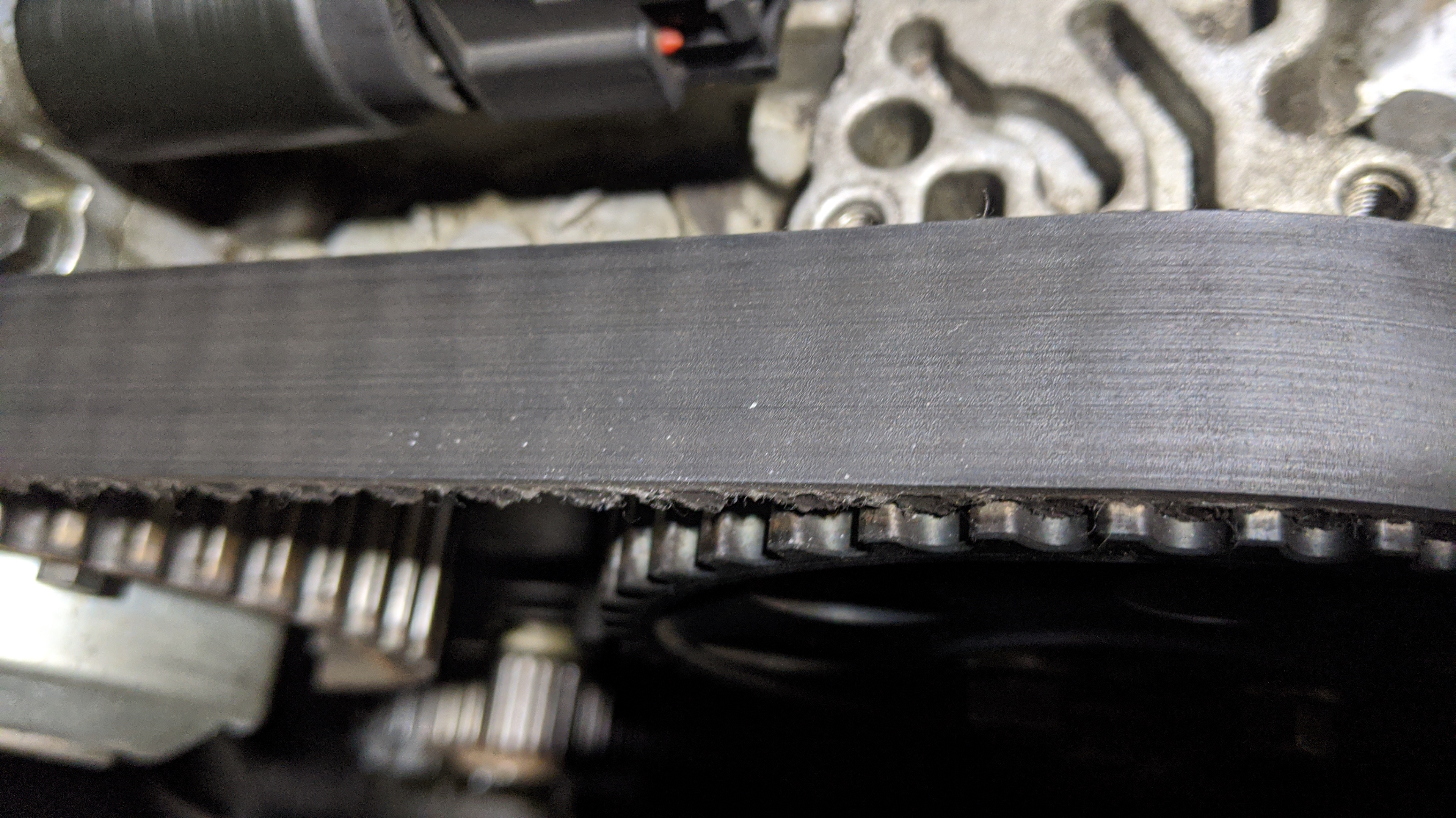

Interval for the 2001 is 105k miles/12 years. Take the timing belt cover off and have a look for markings on the belt. These belts are robust and are not to be feared for failure until well past the change point, especially if you drive them in an adult fashion I ran a 1999 for 140k miles

if in doubt just change it. and i see you have an old style VVT valve, change that too or remove and check it works. mine clicked like it was working but i removed it and it was seized up.I am seeing huge improvement to fuel economy.
if there is no writing on the belt its probably not new

Can you point out the vvt part you're saying to change / test in the picture ? Is it hard to do ?.darrylrobert wrote: 05 May 2020, 06:01 if in doubt just change it. and i see you have an old style VVT valve, change that too or remove and check it works. mine clicked like it was working but i removed it and it was seized up.I am seeing huge improvement to fuel economy.

Is this part what I may need ?darrylrobert wrote: 05 May 2020, 06:01 if in doubt just change it. and i see you have an old style VVT valve, change that too or remove and check it works. mine clicked like it was working but i removed it and it was seized up.I am seeing huge improvement to fuel economy.
- 114758 - Genuine Volvo - Exhaust Cam Adjustment Actuator Solenoid CVVT - 31251211
