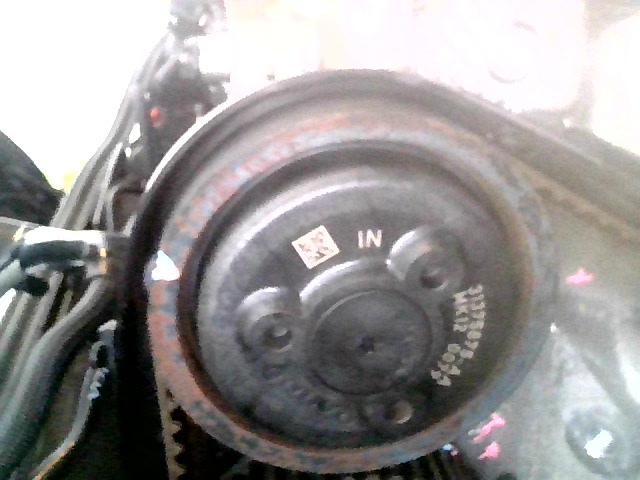

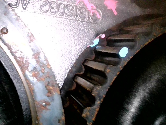

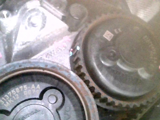

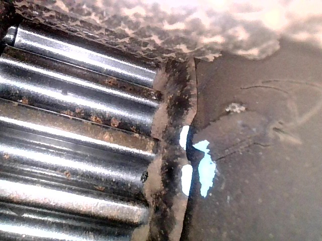

I did not try the seafoam, instead i pushed forward in removing the head, however now I am stuck at setting the timing. this 2.0l e-drive engine had no timing marks that I can see on the timing cover. I've attached several photo's of which i was able to locate the timing mark on the cam wheel and the crank. this is a 2.0L turbo. I'm being told from Volvo there is no TDC pin to use to lock the crank and I looked and I cannot find one. I need to remove the head so I can replace the valves and seals - all of them. let me know your thoughts, thanks so much, seems like this little engine has very little out there.
I can't find any marks on the timing cover unless I am missing them.
this is the crank, there is a mark for the crank in the photo
this is the intake cam
this is the exhaust cam
this is the overall pic

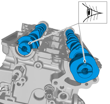

That is not a Volvo Modular Engine (VME). It is the next generation after VME, Volvo Engine Architecture (VEA).
The camshaft alignment marks are on the rear of the camshafts. The VVTs are preloaded and aligned using tool 9997497.
1. Align the crankshaft to the block.
2. Align the camshafts to the cylinder head at the rear.
3. Align and preload the VVTs to the camshafts.
4. Install timing belt.

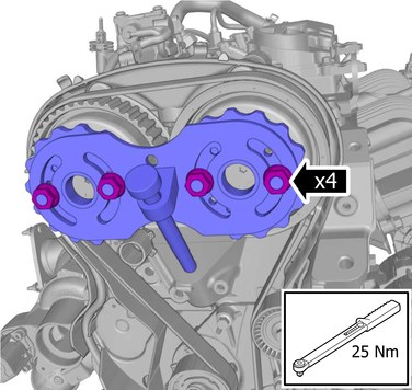

is the the tool your tal
cam tool
cam tool
king about ?
RickHaleParker
Posts: 7129
Joined: 25 May 2015
Location: Kansas
Has thanked: 8 times
Been thanked: 958 times
Post by RickHaleParker »
Yes that is it.
