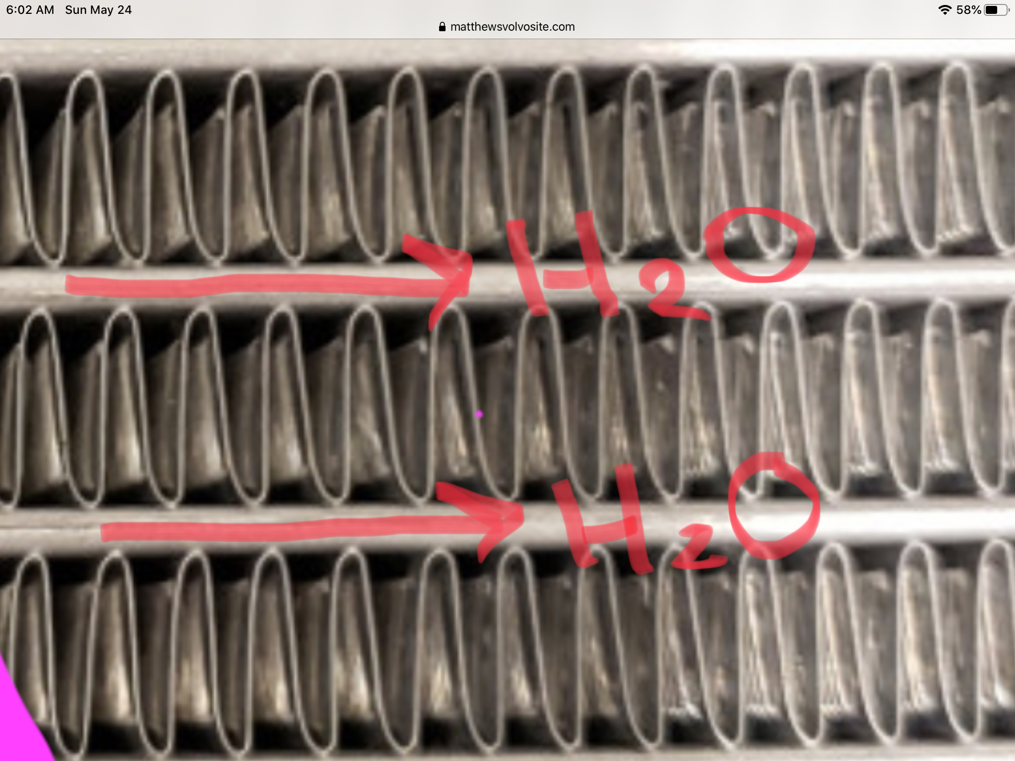

Pro tip for other circumstances - grab a pick and you can open those vanes back up. The damage won't go more than 1/8" into the radiator. Reopening the air passages is tedious, but not hard.abscate wrote: 22 May 2020, 06:49 All the little damage to the sheet metal vanes looks ugly but aren't relevant.
It's probably not that beneficial to overall performance unless you have a lot of them smashed shut. But it's a nice way to spend half an hour with a podcast and some tea.
- Posts: 36140
- Been thanked: 4064 times
I think everyone knows this but for new to car repair, here’s where the water flows
