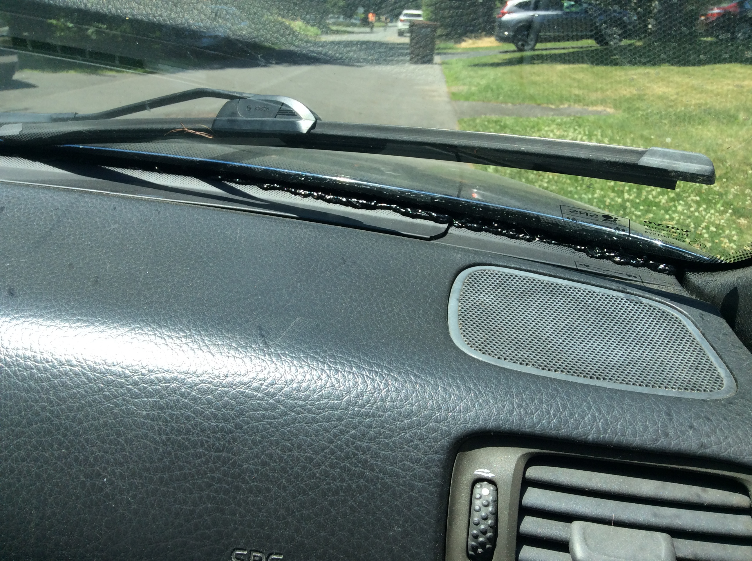

One my T5 I stuffed butyl tape down between the glass and dash with an ice pop stick and stopped 99% of squeaks , cosmetically it’s about a 6/10. It would look better if I put another piece over it to dress it up.
On Evita , a 1999 S70 , Abby and I took the dash out, about 75 minutes, and then reglued the mounts with a JB Weld clear epoxy, then put butyl tape on the underside of the dash lip where it touches the metal frame.
Much nicer , invisible application, squeaks gone

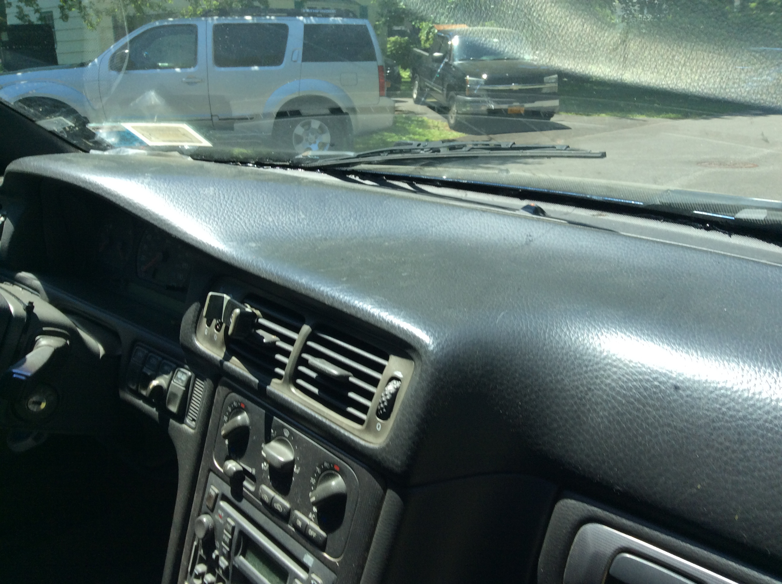

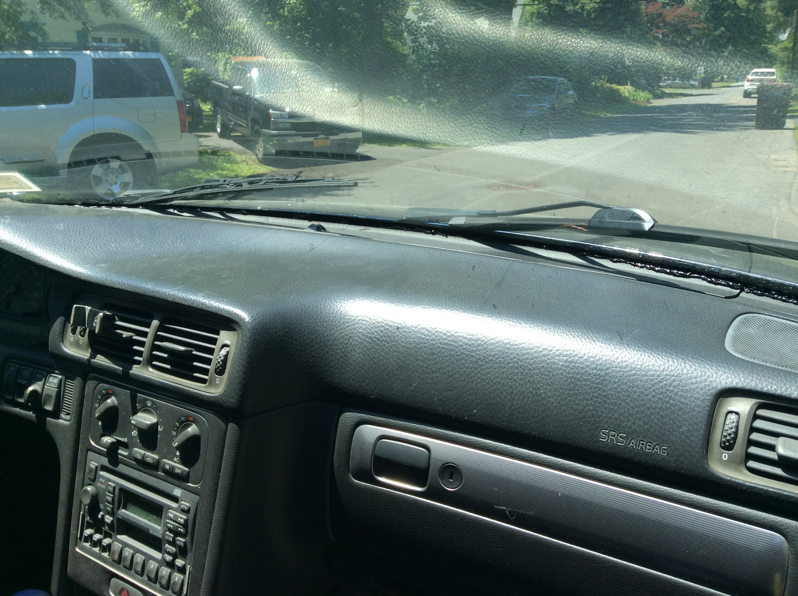

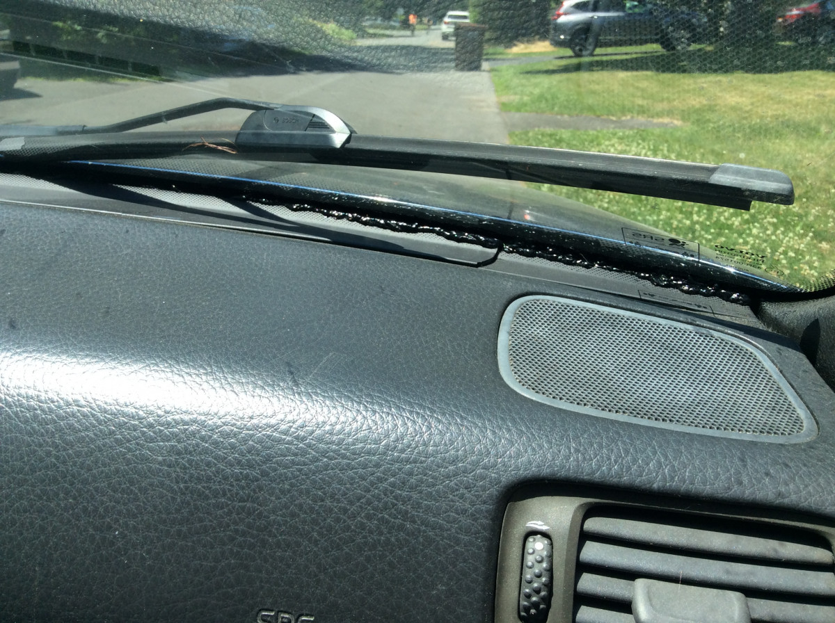

Couple of pictures of the 1999 “ stuffed tape version”. A roll of butyl tape covering this would clean it up but it isn’t too bad
