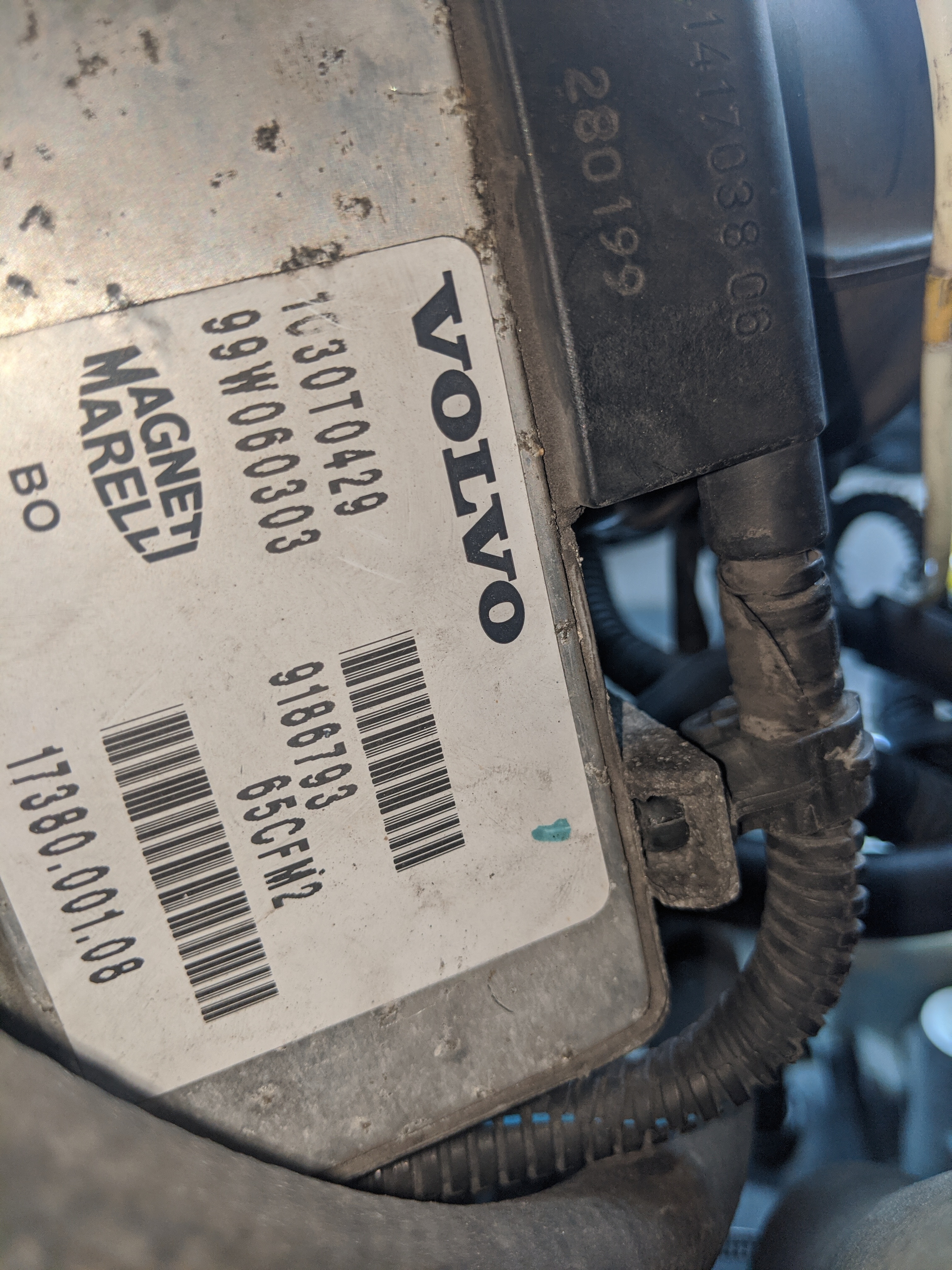

Hi friends,
I have a white label made in Italy etm that's giving me the ETS light pretty consistently and occasional problems like idle dips to about 600 when coasting to a red light stop in neutral. The idle returns to normal as soon as I come to a complete stop.

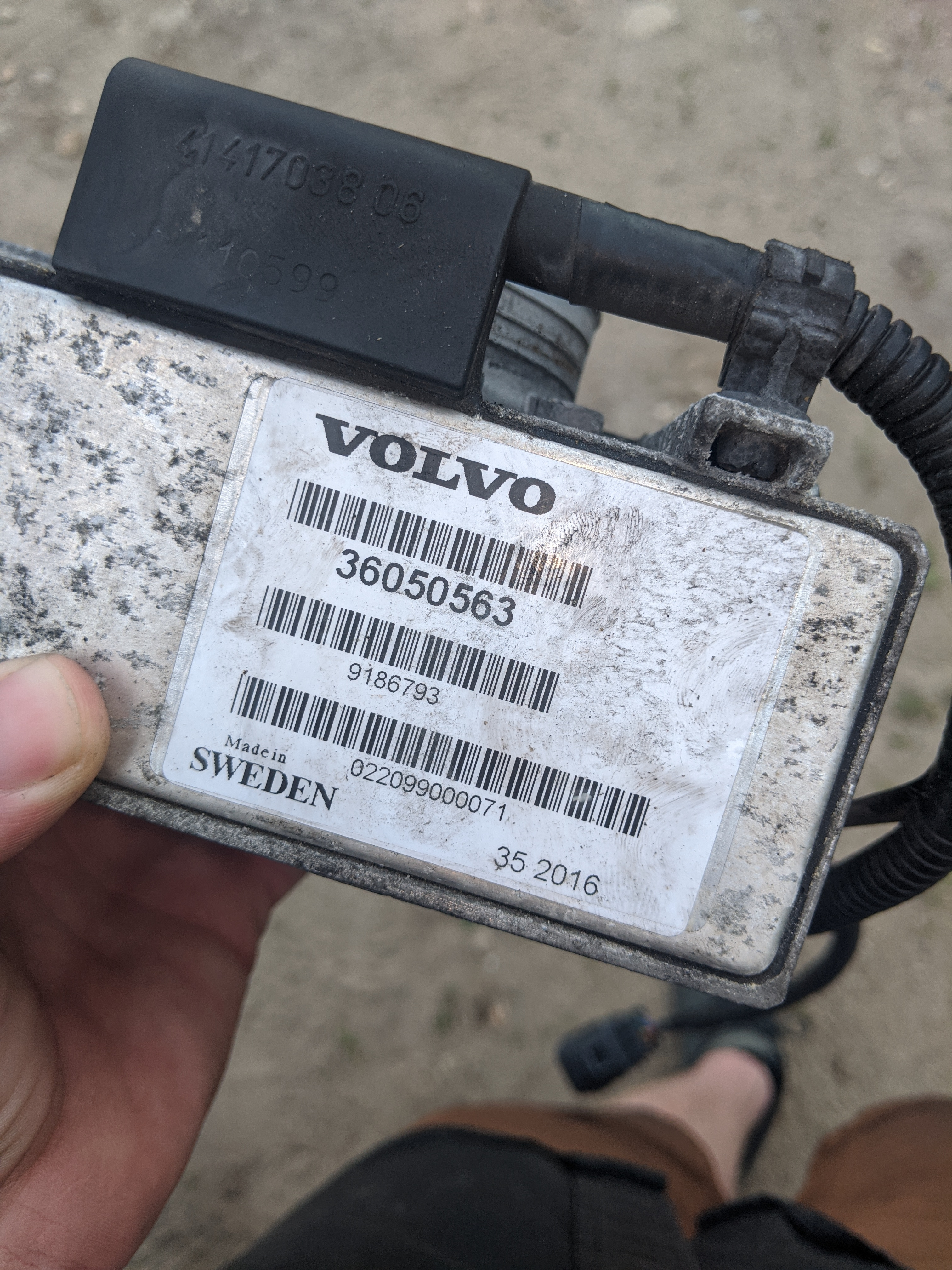

I found this made in Sweden etm off a junkyard unit that was also 99 and non turbo. I know swapping any etm is never a sure shot, but I wanted to see if anyone knows if these units can't be swapped between made in Italy and made in Sweden units?
Thanks for the time!
Should I swap my ETM with this junkyard unit?

My understanding is the you can swap ETM's with no programming required.
turbo to turbo
none turbo to none turbo
And it looks like it is the newer contact less version like XeModeX.
turbo to turbo

Ah interesting, I was wondering why it said made in Sweden since I had never seen that mentioned on the forums about units. That said, the plastic caps on the side do say magnetti marelli, which is the Italian part no? So I'm not sure if they also made the contactless update?
Also - I just sent it and installed the etm. It runs so the software must be fine, and the throttle response has noticeably improved, but it hunts a little more at idle (fluctuations between say 830-870 rpm). So I'm not sure if it's a better or worse unit yet.
Anyone know if there's a calibration period for these after swapping?

Since you disconnected the negative terminal for electrical work safety,
, :8 your throttle adaptations need some driving to reset.
I believe a DENSO car only has one software rev so swaps work NA, but turbos have many revisions so swaps don’t work asa rule

My spider sense is tingling this morning.
In the picture above, it looks like they have stuck a made in Sweden sticker over an “ original sticker “ of some sort.
I’m going to venture that these are refurbished MM throttle bodies. I doubt Volvo opened a factory inSweden to make throttle bodies in 2015
There are rules about Country of origin nomenclature which I’m sure they are following but it would be good to know the facts here

Thats a good point, i'll have to check my car to see which one is currently on it. I know i put it on and it ran fine, but i cant remember which one actually ended up staying on it since i was hunting that ETS light for awhile. My ETS light ended up being caused by my brake pedal position sensor which mounts into the brake booster drum. Even my indie seemed surprised about it.abscate wrote: ↑02 Dec 2021, 06:24 My spider sense is tingling this morning.
But anyway, if it is the rebuilt one like it seems to be thats a good sign for me.
