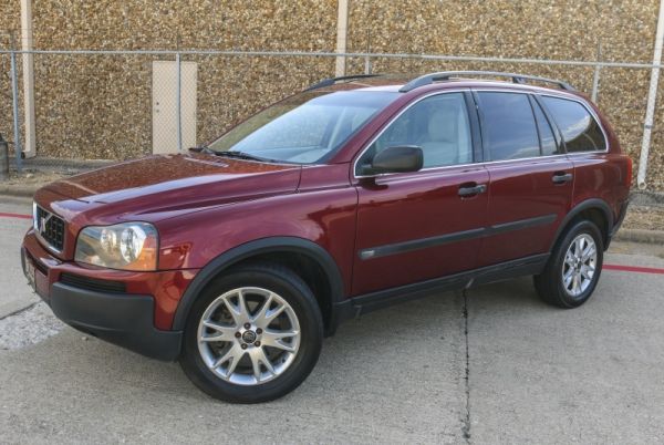

I'm looking into buying a nice 2004 xc90 5cyl turbo FWD I saw locally. It's even the color I prefer. Up until this point I have only owned P80 models. What did I need to ask or inspect specifically in this model?

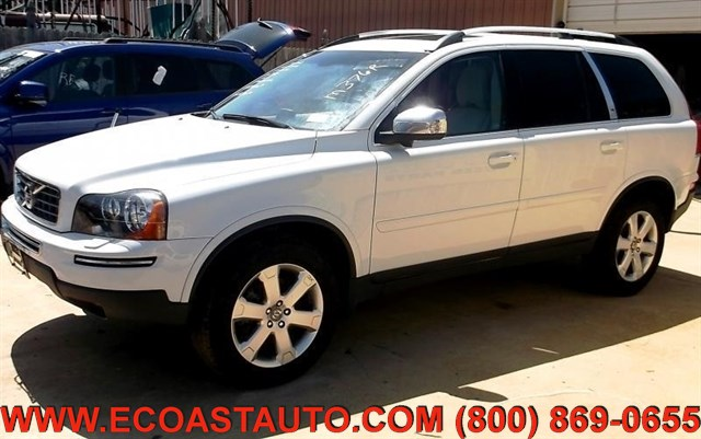

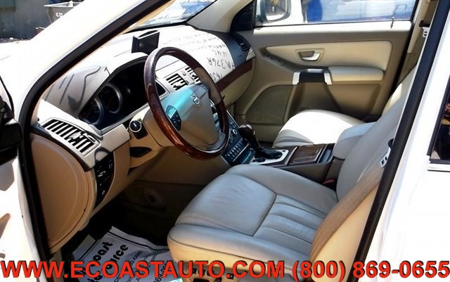

Submersion?
2011 Volvo XC90 V8 AWD
Mileage 14,502, Damage BACK UP CAMERA; LOW WATER/FLOOD, REPAIRS AVAILABLE
https://www.ecoastauto.com/inventory/de ... 3/M376KJCK

So I finally went to see the vehicle in person. The body is great condition. Only 1 major dent that I could find. Headlight have no fade at all. It's missing the passenger side marker light cover. Seats are in desperate need of leather treatment but no major tips or tears. Someone replaced the OEM radio for a cheap aftermarket. Little stuff like missing fan speed knob, 1 broken vent, 2 missing button covers on the driver seat controls, drink holder door is broken. Everything I tried worked, windows and sunroof etc.
Drive wise the passenger strut is extremely clunky and you can visibly see the strut tower pushing through. I didn't see any dents under the hood but it definently needs new spring seats and or strut mounts. Somehow every single plug bolt head is coated in a light layer of rust. My p80 lugbolts are original and they look new. Not sure why the rust is formed on there.
Engine is pretty clean but unsurprisingly lots of smoke coming from dipstick tube. I didnt have a glove to test pcv. Right now it's at my trusted volvo mechanic for inspection. What do you guys think so far?

Indie volvo mechanic just called with his evaluation. Short version:
29 codes stored in 9 different computers, many related to battery and fuel system.
Both struts mounts are shot.
Transmission fluid dark
Rear brake rotors below minimum levels
Ripped driver side drive axle
Serpentine belt heavily cracked
Excess crankcase pressure failed glove test
He quoted me 3000 to 4000 for parts, labor and tax.
Thats with struts, mounts and spring seat replacement.

Update: I offered them $2000, they countered with $3500 including tax and title. They wouldn't come down any further. I passed on it.
