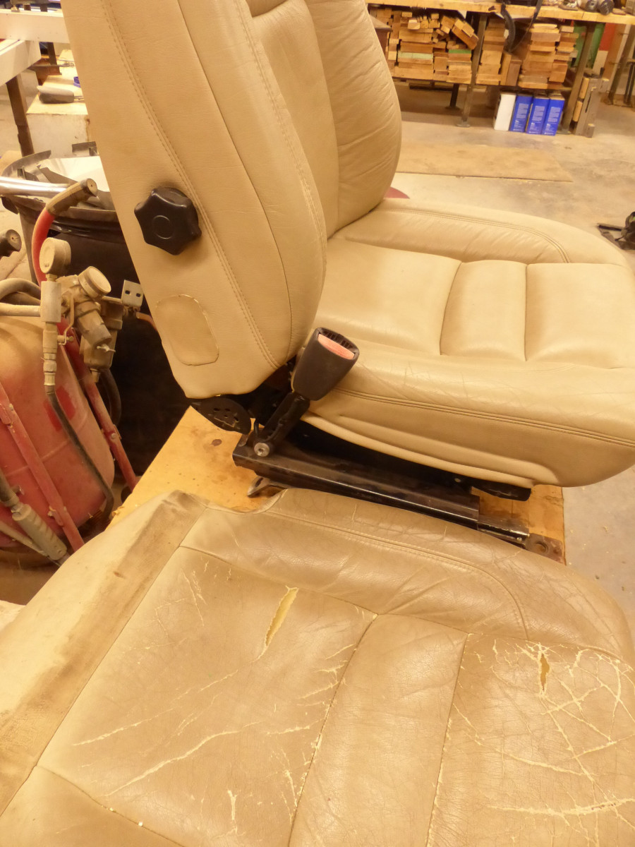

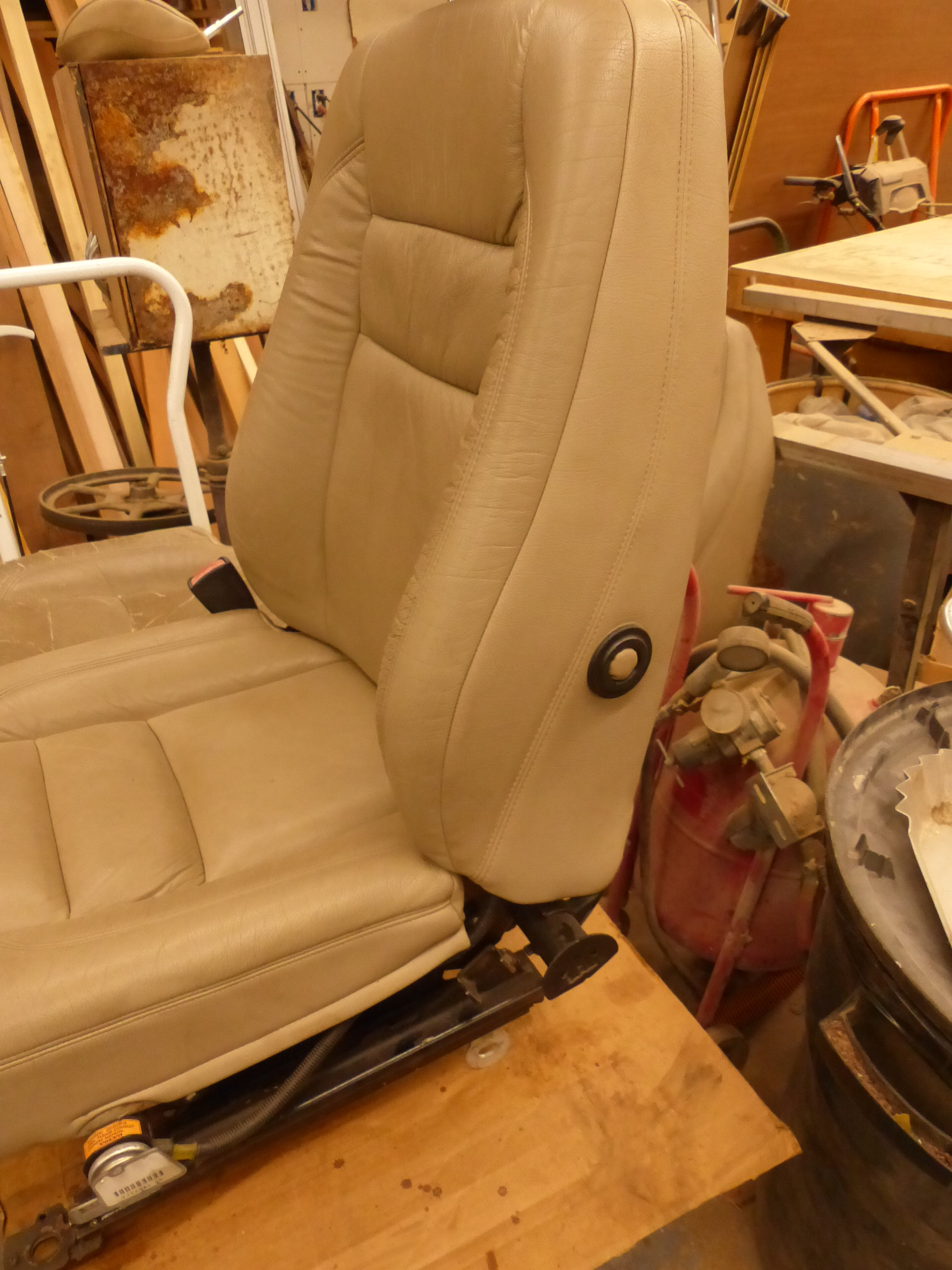

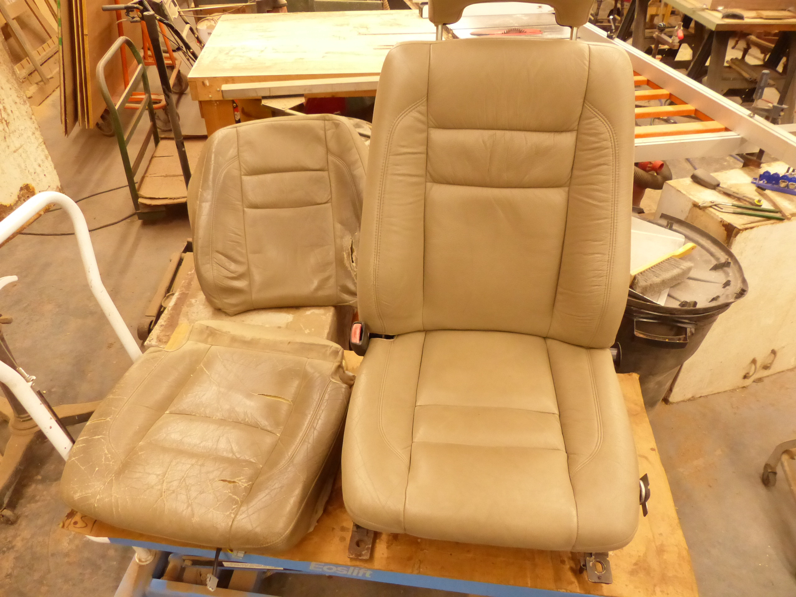

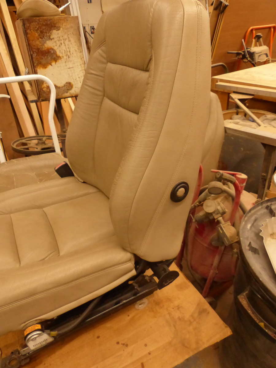

After countless trips to the pick & pull yards near me trying to find a (second) replacement driver's seat as the one I put in years ago (not perfect then) now looked bad. I've had zero luck now that the remaining '90s examples showing up can now be plated with "historic" tags. Frustrated by yet another seemingly wasted trip last month something I've noticed all along finally sunk in as I stood looking at a perfectly good passenger's seat in this latest parts car which must have been garaged for most of its life, can't I just swap out the covers? Just the holes for the adjustments seem to be different, an easy fix especially since that big center arm rest covers so much of at least the insides. So I took the chance for $40., took it back and put it on a bench in my woodworking shop. I noticed back at the parts yard that the upholstery seemed to be held on entirely by hog rings, I already had a bag of those, as well as the special pliers needed to attach them from past furniture upholstery jobs. Sorry I didn't think to take pictures of the process, but was not nearly as hard as I expected. Since my old foam was torn and shot I swapped that out as well. I did of course reuse the old top frame so that the airbag was on the correct side. All in all it took around 2-3 hours to complete. Thanks to the very high quality foam Volvo uses, which seems to resist drying out and stiffening, the seat is as comfortable as new.
