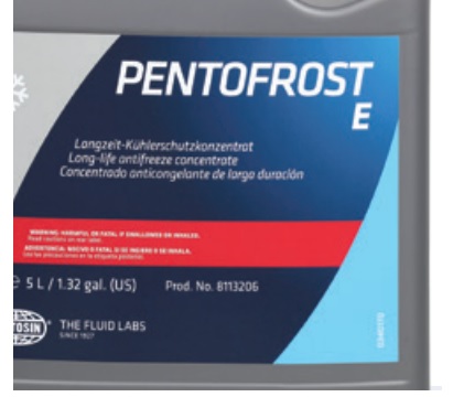

For reference here are the PENTOFROST Coolants that correspond to G11, G12, G12++, G13
G11
PENTOFROST NF (with silicates)
(Formerly LONGTIME ANTIFREEZE G11)
G12
PENTOFROST SF (without silicates)
(Formerly LIFETIME ANTIFREEZE G12)
G12++
PENTOFROST ++ (with silicates)
G13
PENTOFROST E (Concentrate – H-OAT/ with silicates)
If you are upgrading to the latest then you will likely want
PENTOFROST E
