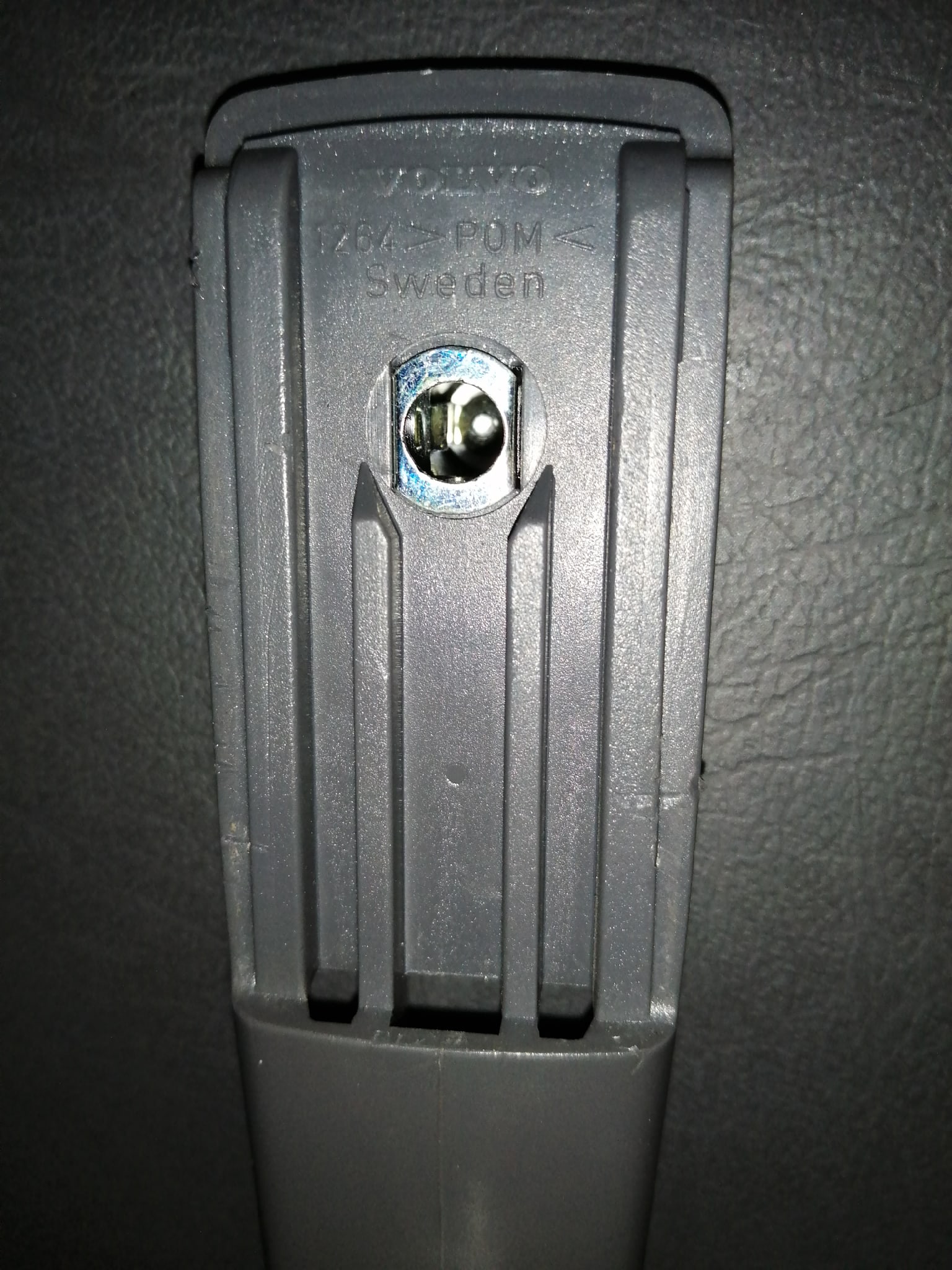

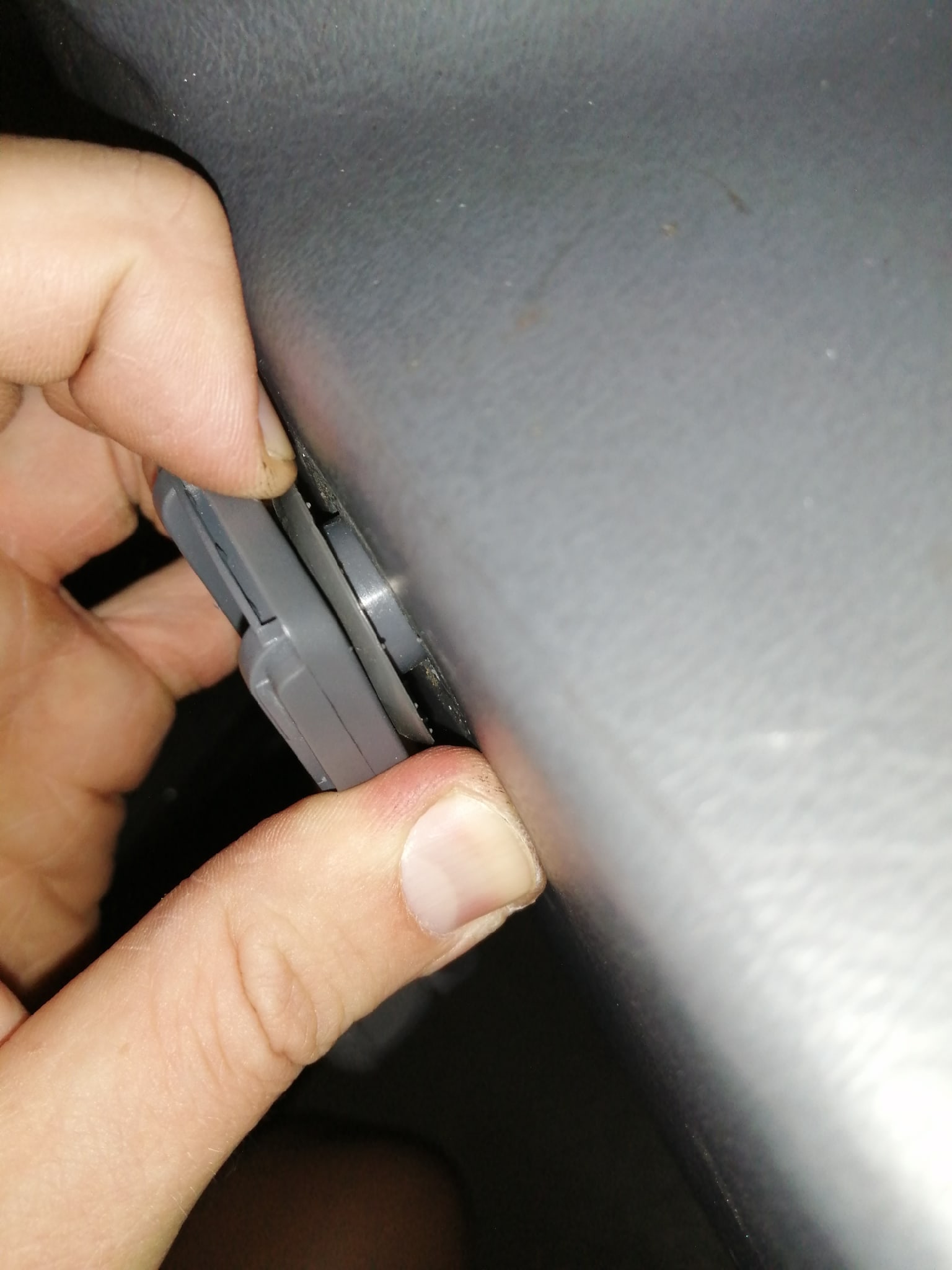

Check these pics out. It seems very different. I guess the thing inside should be somehow triggered?! Pushed or twisted...jimmy57 wrote: 08 Aug 2020, 09:04 I recall it being a clip that slides to the side. You push on the door panel towards outside so the panel pushes away from the handle so you can get to area behind handle hub and then pull the clip opposite the handle shank. I have a J hook tool but I have opened a cotter pin 90 degrees and used needle nose pliers to bend the end around for a small J hook many times to slip those clips off. There also is a special tool for pushing off those clips. The C shaped clip gets installed back into the handle and you install it by bumping it onto the shaft with butt of hand. The shaft it goes on is splined and has a groove a few mm from end that the clip falls into to keep handle from sliding off shaft.

Alright, admins and moderators. This topic is solved, at least for me. Flag it as solved, i dont know how...
The solution is simple: as soon as you remove the surface plastic from the window crank, there you got a metallic kind of plug basis. Pull it with a flat screw driver from top or bottom. Try to pull it evenly, so that you dont damage it anyhow. And then the crank will come out really easy!
