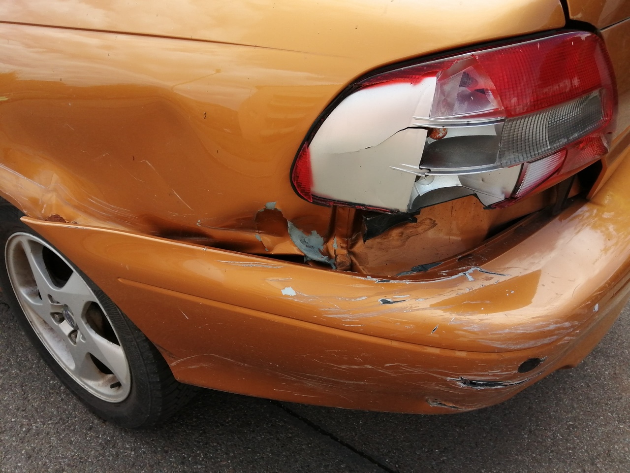

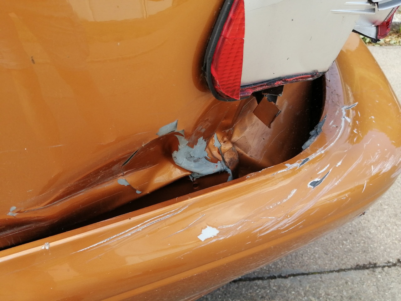

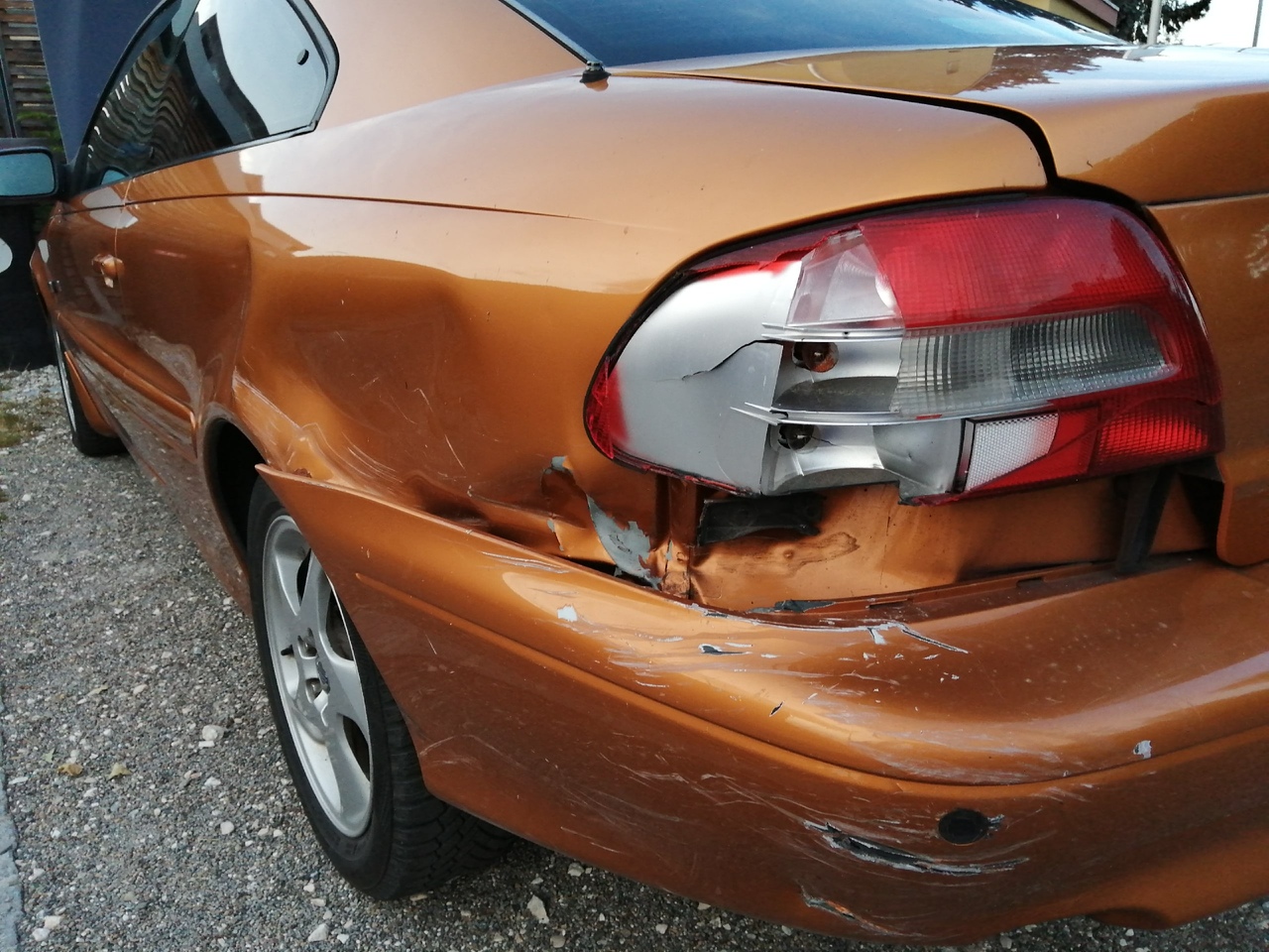

It has this particular damage. The appraiser said it will cost 9k euros. The local workshops - 3-4k. I know somebody who can fix it for much, much less. I dont know how good it will look eventually, but i hope the inspection will approve it. I need to change the cooler, because it leaks coolant when am flooring it and some basic maintenance should be enough to not worry that i will ride it directly to the junkyard

Pull the transmission and related parts from the 850, and junk it, or sell it and use the money to fix the C70.
