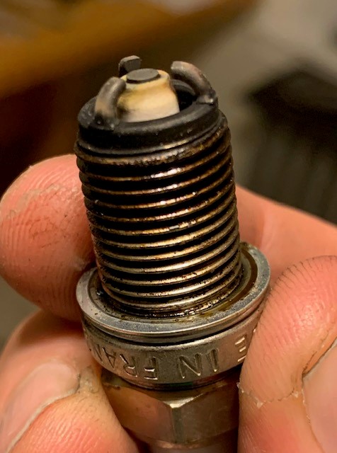

This is a springboard from my prior problems starting as a consistent misfire in Cyl 1.
I've pulled the #1 injector and replaced it with like-kind. Resistance on all of the injectors is between 18.0-19.5 ohms. No real noticeable difference in idle or run with the replacement injector, but 1-2 days later, CEL again for a misfire in cyl #1. Pulled the Volvo sparkplug from #1, its been in there for 1 year. Replaced it with a used but good condition Volvo plug, no difference in running, no CEL yet.
While I've been under there poking around, I'm noticing a loud hissing sound, like a tire with a nail in it would make. Depending on where you stand, it always sounds like its in front of you. If I stand in front of the car, it sounds like it's coming from the PCV box area, but if I stand in front of the passenger tire, it sounds like it's coming from the vacuum tree. Maybe it's coming from both. The vacuum line from the fuel pressure regulator to the tree seems fine, I checked all that while the fuel rail was off. PCV is good, glove sucks in hard and harder when throttled.
This car does not have the little end outlet on the intake manifold (its just a solid plate), nor does it have any vacuum lines running into or out of the airbox. There are no holes in the airbox like I've seen on other same-year cars. With how loud the hiss is, I'm inclined to think its the intake manifold gasket, but wouldn't it throw a separate code for an intake vacuum leak?
Surprisingly, when I refilled the car's tank today, the MPG according to the app I'm using based on mileage and gallons since the last fuel-up went from 22.2 to 22.3 over the length of this issue the past few weeks, which doesn't make sense to me if it's misfiring.
Attached are photos of the one-year-old plug I pulled and a video of the hissing sound. Any ideas?
