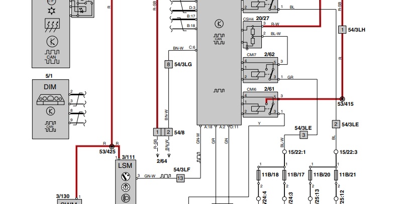

ive looked at the wiring diagram and it looks doable. I cannot post a pic because it looks like this website is having issues but the xenon has an extra relay CM16 that needs to be re wired to the standard CM17

You need a complete redo of the wiring plus car's configuration change.
