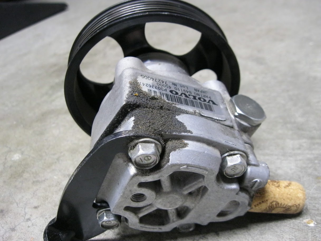

I decided to take it to a volvo mechanic today and had the 2 idler pulleys, the belt tensioner and belt replaced. plus a software update. He said there was a small leak in the power steering pump but I decided not to replace it. In hind sight perhaps that was the source of the noise.
$1300 dollars later and I hope the noise is gone. I’ll find out tomorrow morning when I start it up.

Sad part about the power steering pump, it's not going to stop seeping and you'll need to pull the belt (tensioner) again to replace. Can see photo for where it starts, drips out the front of the engine under the pump and makes a mess but eventually runs to the rear of the engine through the valley, confusing the source of the leak. One truth about the Volvo V8 in my opinion, sooner or later you'll replace the pump. Mine started seeping at 125k miles.
