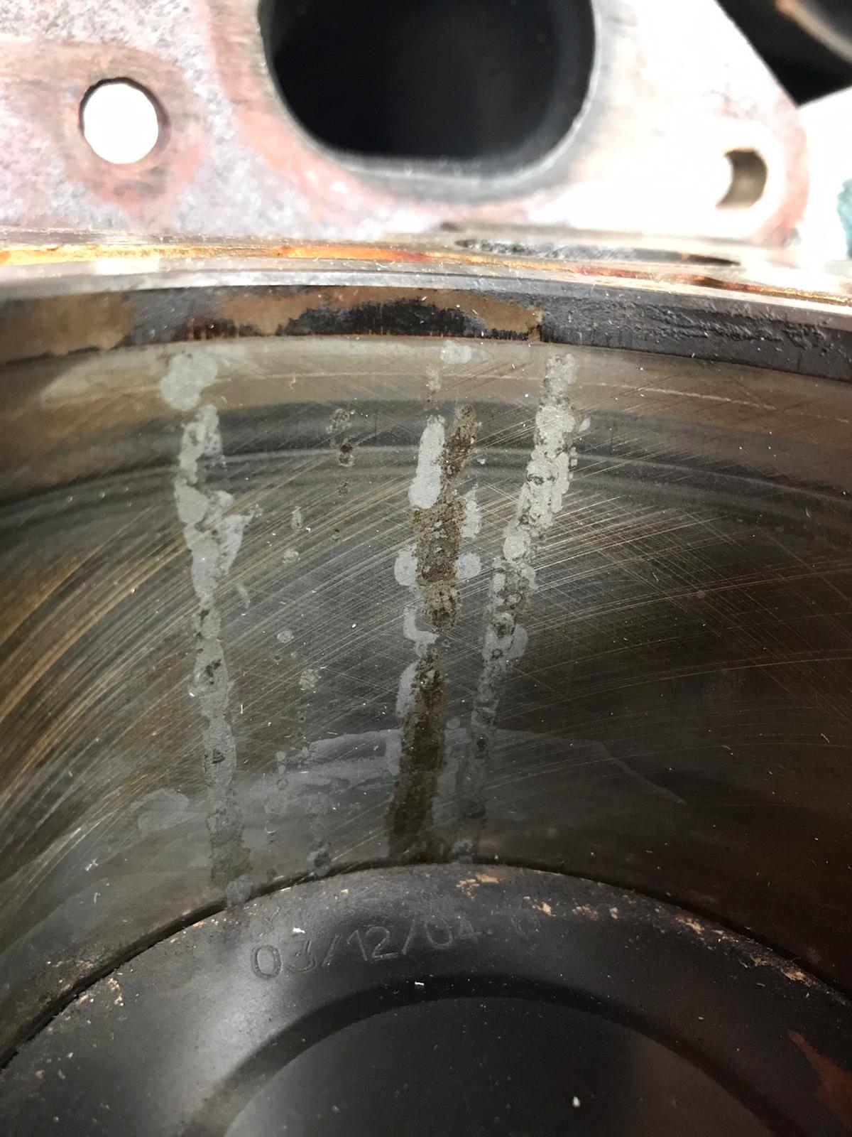

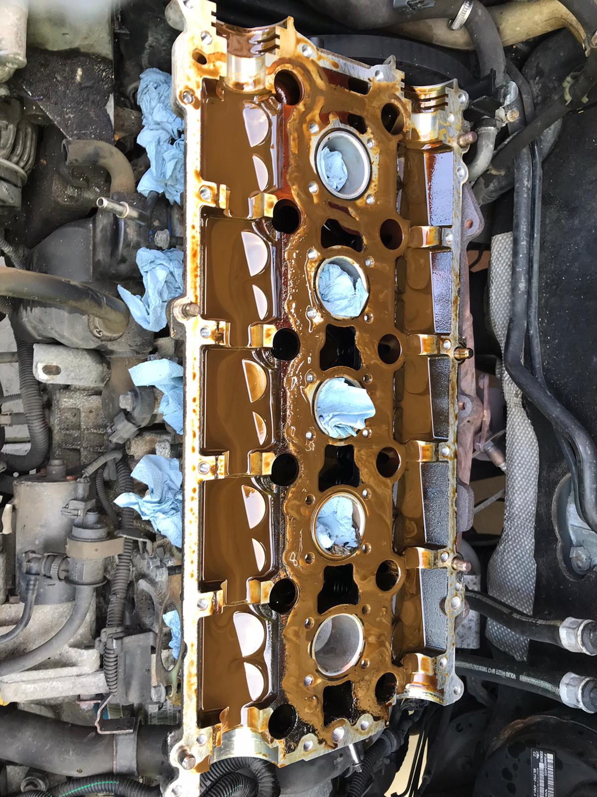

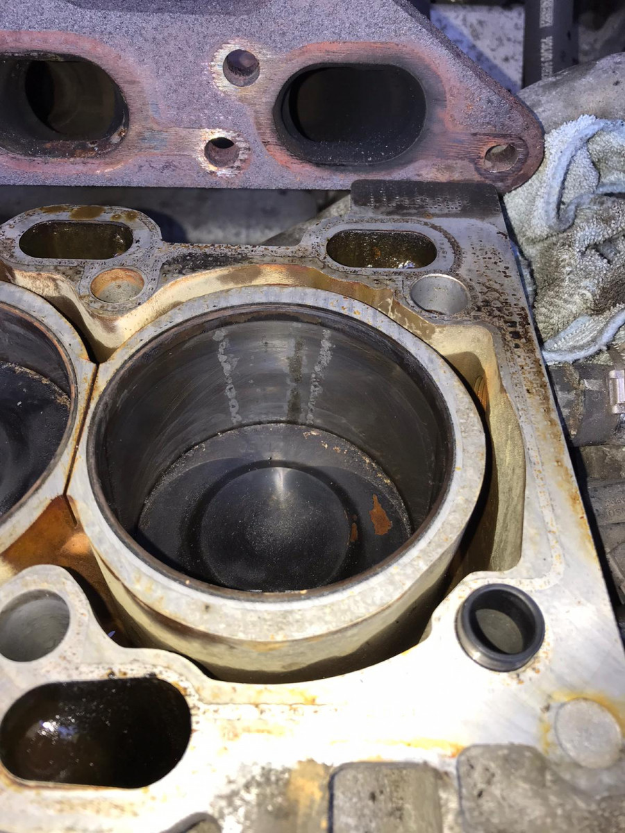

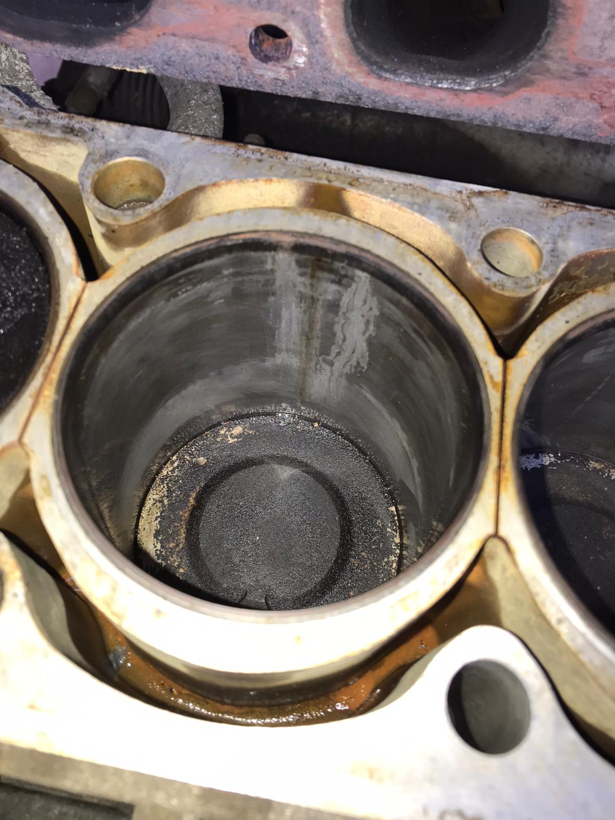

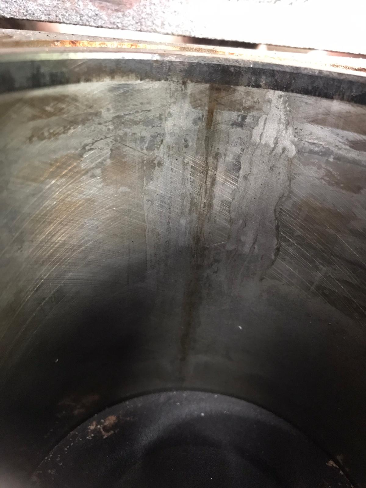

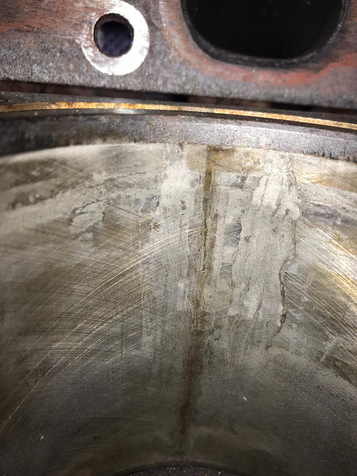

What I found is best told in the pictures below. The oil contains a LOT of water as can be seen in the last picture. My question is mainly what do you guys think about those cylinder walls? Are those scars from coolant? I can lighly feel them with my nails when scratching the cylinder wall. Can those be cleaned out with some scoth-brite green or is this really bad? Before I get the head checked for cracks I would like to know if this engine is still worth it. Thanks

Could it be just coolant deposits ? Try with a steel wire sponge - the kitchen stuff kind, see if it goes away. But at this point, I would be more worried about worn rod bearings from coolant mixture. Was the oil pressure light on ?

Most areas still show the honing marks behind the 'scars'. So the depth can't be much. How low was compression? Did you try to add oil to see if compression was low at the rings or valves? How do the valves look - any burnt valve edges?
maybe send an oil sample to see how much bearing metal is in the oil.

The light was not on. I will try the sponge idea! thanks.oragex wrote: 04 Sep 2020, 12:13 Could it be just coolant deposits ? Try with a steel wire sponge - the kitchen stuff kind, see if it goes away. But at this point, I would be more worried about worn rod bearings from coolant mixture. Was the oil pressure light on ?
Compression was meassured cold and found between 100-125PSI. It was more to determine where the head gasket could be leaking. I did not think about checking compression to see if the rings are in good shape since I was pretty sure the headgasket was blown and it would give me low numbers anyway. Valves look to be in good shape and no burnt edges.volvolugnut wrote: 04 Sep 2020, 14:18 Most areas still show the honing marks behind the 'scars'. So the depth can't be much. How low was compression? Did you try to add oil to see if compression was low at the rings or valves? How do the valves look - any burnt valve edges?

Looks like scale to me.
Theory:
Previous owner ran it with coolant in the oil for a short period of time. Coolant washed the oil off the cylinder walls and diminished the ring sealing. Coolant got past the rings vaporized and left the deposit you see.
Fact:
You can feel the edge of it with you finger. That tells us it is a deposit not scoring.
I would try to chemically decompose it with Acetone.

I will give acetone a try! thank you. I have already tried to clean it off with WD40 and kitchen sponge this morning. I can barely feel the edges now. But maybe acetone will do a better job.RickHaleParker wrote: 05 Sep 2020, 03:01 Looks like scale to me.
